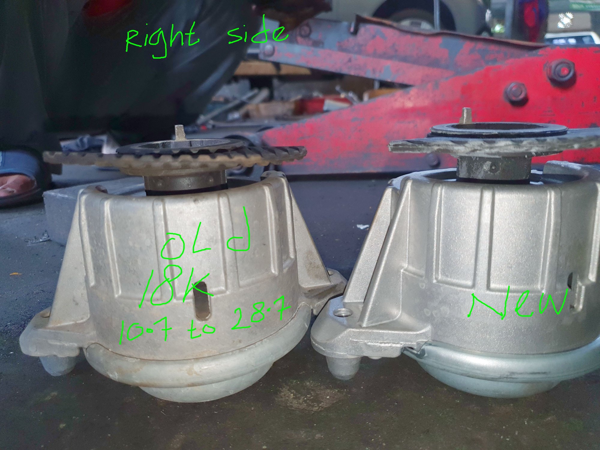

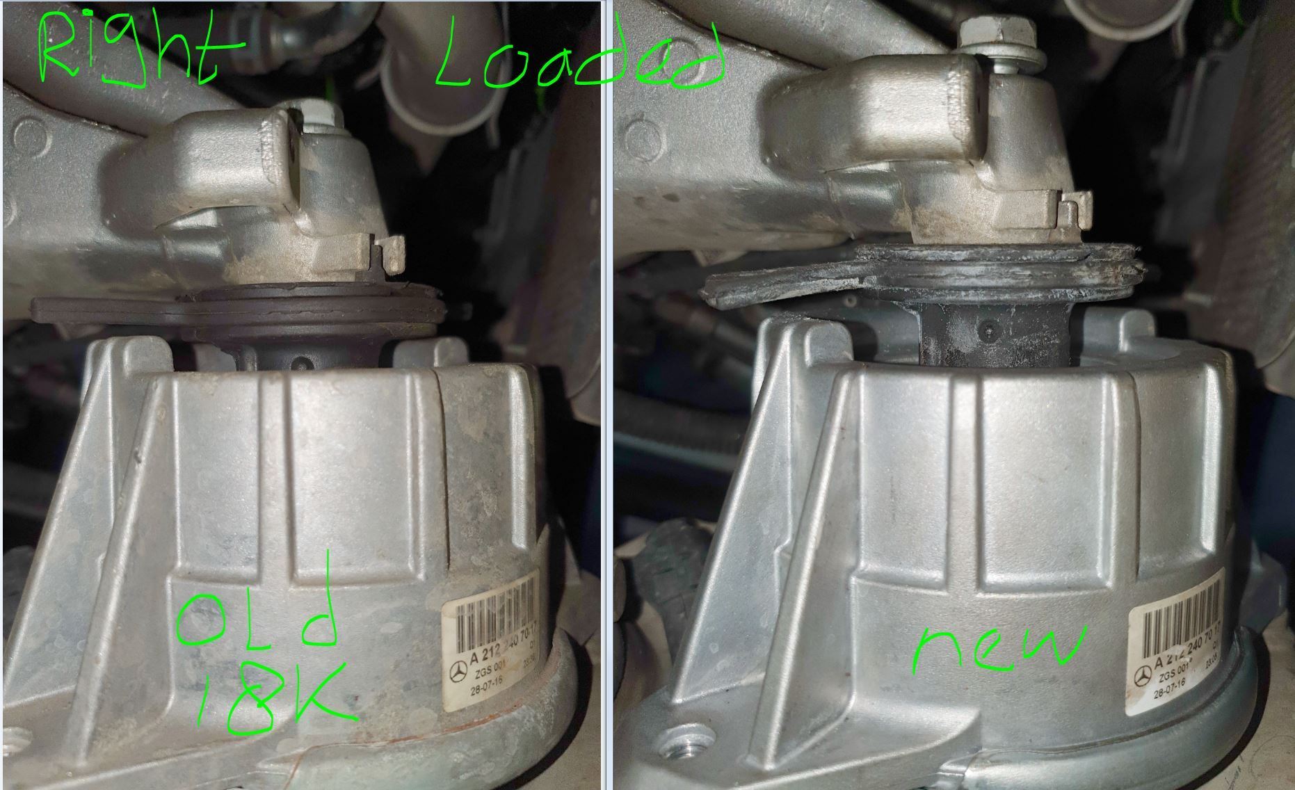

Engine mount is quite easy to see if it is sinking.
I am an engine mount-holic , 20,000KM I replaced them both and tranny mount.
My 20,000KM has lots of bad roads and the way I drive would equal 60,000KM of a typical country with good highway system, say USA and driver has an "egg" under his throttle pedal.
Depending how the angle you view the engine mount, because parallax error can result in tiny different assumption of the sinking depth of the middle part of the engine mount vs the round body.
Observe the pink zone at 2nd image , that is easy to see virgin engine mount and a bit sinking one.
18,000KM vs new one

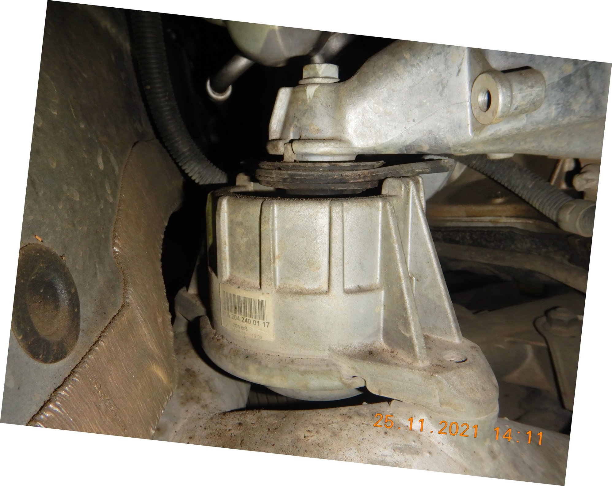

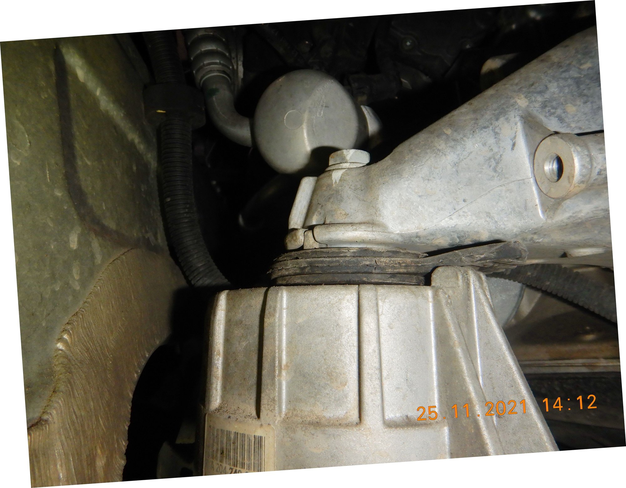

Below is my friend's C200 W204 of 71,000KM and model year 2010, so engine mount age 11 years when photo taken in 2021.
I can only photo with ease the LEFT one. But you will see how obvious the sinking.
At this sinking depth, this is a brutal !!!

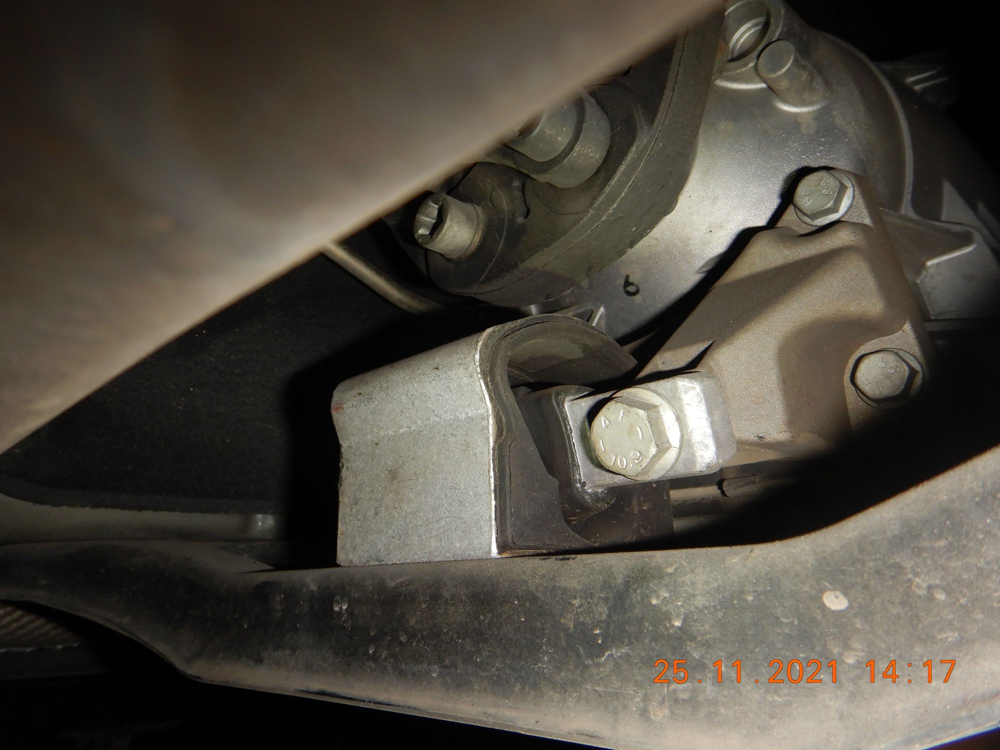

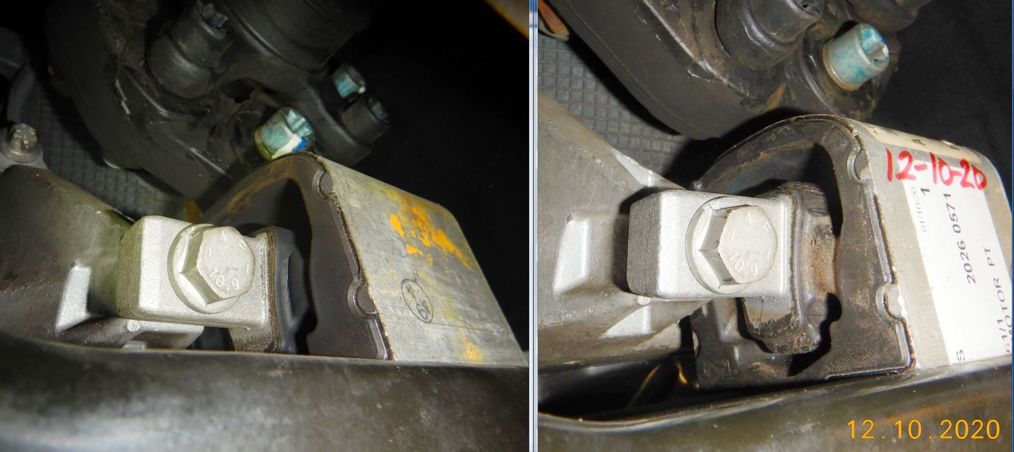

While under the car, check your tranny mount, it is easy to see and verify.
Below is also from my friend C200 W204. This one is sinking too. This one so easy to replaces and cheap too.
MY TRANNY MOUNT
For my tranny mount, I will replace it about the same time as engine mounts.
Below I replaced a bit ealier, like 13,227KM service life or so and the sinking is this much already.
RIGHT ONE IS NEW

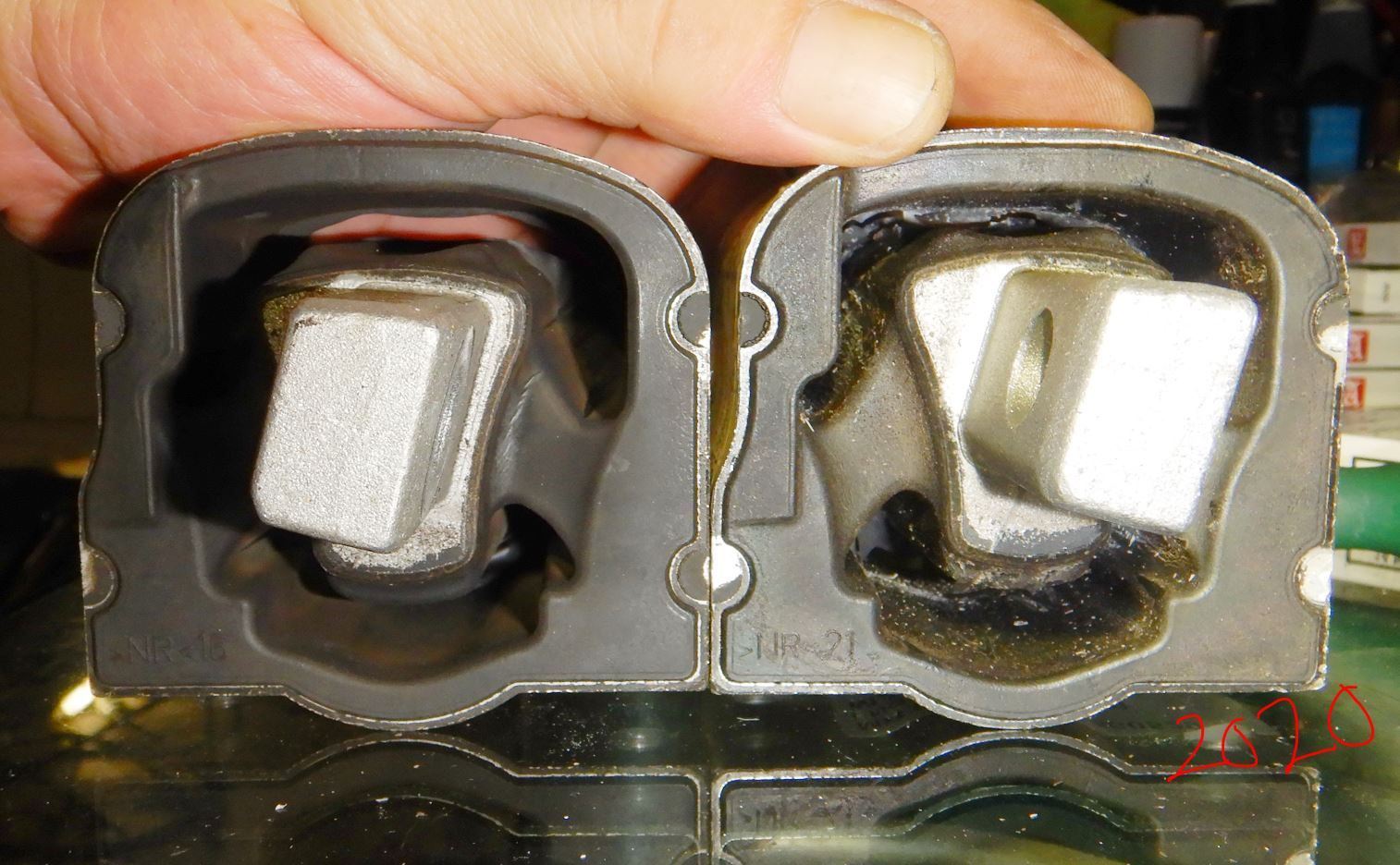

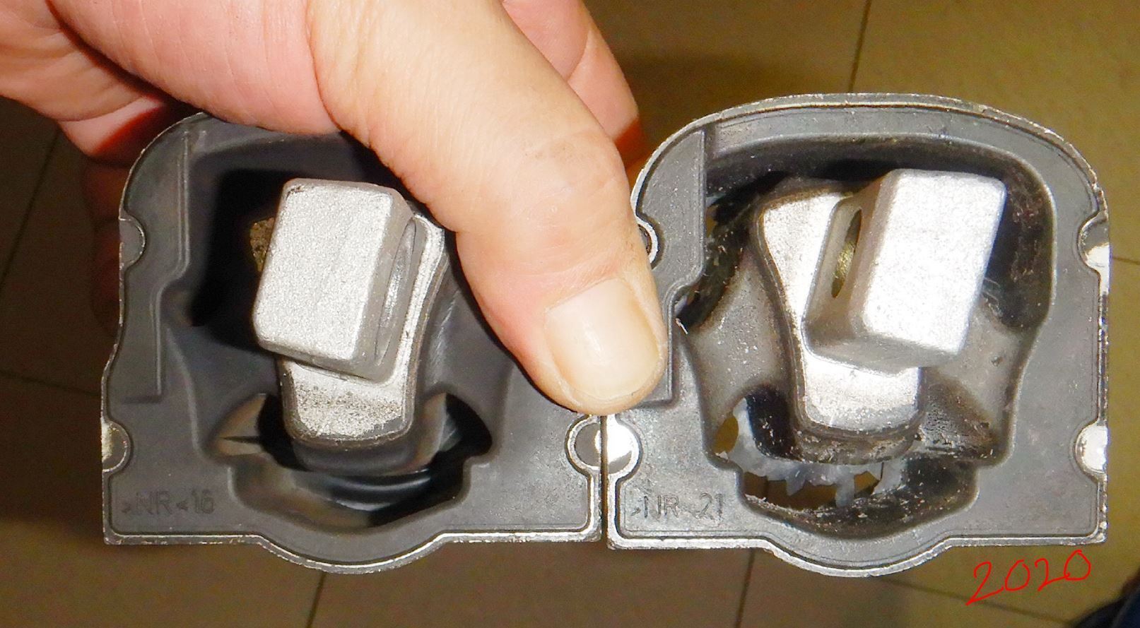

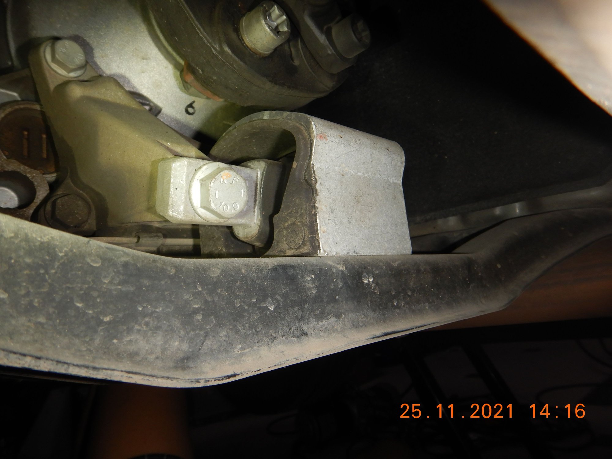

Tranny mount has very little room to play.
See below : The old one vs new-2020, so little difference to naked eye because not under compression.
Look at the allowable movement room at the bottom of the mount, so little.

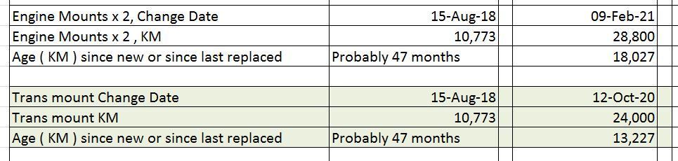

From my log book. 2018 is when I got the car, in May and only 9,700ish KM. So OE engine mount by age is already 4 years 2 months when I first replaced in Aug 2018.
Car is 2014 June registered by first owner. Time is enemy for engine mounts because forever it is under compression, with mileage or not, they still suffer.
