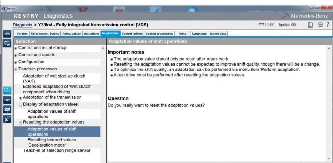

I think there is a warning on Xentry saying that would should never reset the TCU adaptation values unless the transmission is coming from a repair (i.e. new valve body, new friction material, etc.).
Andre: thank you for sharing this because this makes complete sense.
Tempering with poor adaptations does nothing worthy... Poor shifts are caused by the engine, not tranny.
Do you mind posting a screenshot of that exact warning? Just curious : )

Sure thing! I've got the image out of the internet but it's pretty much what I remembered:
Thank you : ) MB stating if repair work is done is very vague though.
We need to keep in mind that Xentry was not intended to be used by the general public, only trained technicians. Moreover, this kind of makes sense. The shift adaptations is a function that allows the TCU to adapt to the wear of the transmission internal components. You can make small adjustments to the shift timming to make the car shift more aggressively but if you reset all the software parameters to factory "zero" without installing new internals, it is unlikely the computer will be able to control the transmission properly until you redo the adaptations.
True but lets say you did somehow didn't read that part and did the reset without performing any repair work, it will eventually relearn regardless right, you don't have to manually readapt it? Just takes time?
Although I guess (and from experience) MB TCU is not a good learner.
Correct, eventually it will adjust itself again. It just might be very rough trough the process if you don't make the adaptations via the Xentry or similar tool.
I see, ya that was what I thought.
