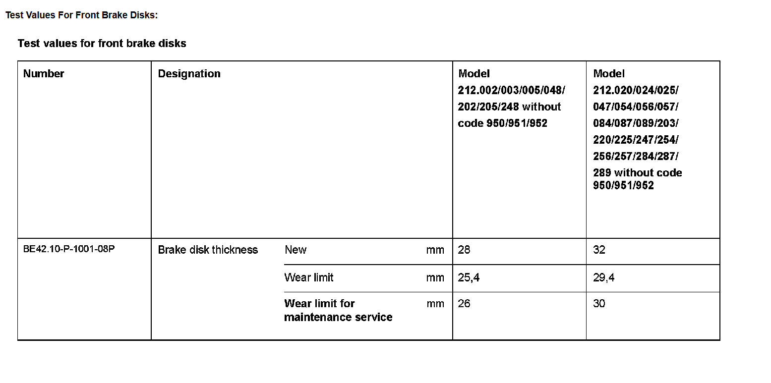

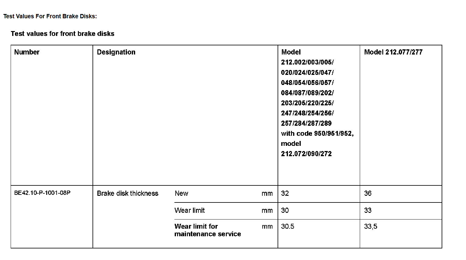

In the testing and inspection section of the manual they use the codes 950, 951 and 952 it looks like.
