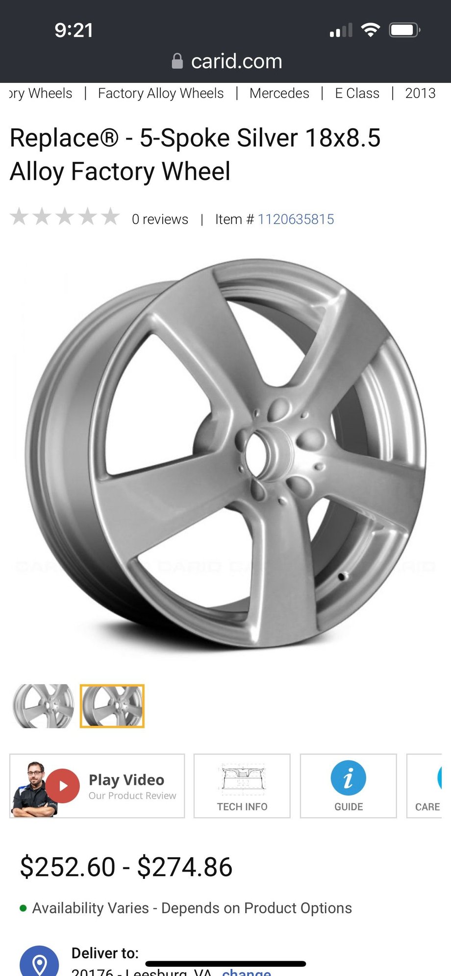

Ok, so my droning noise is back, and it is definitely a bad rim. I know it, because it came back immediately after a tire rotation that brought one from the rear to the front, and the noise immediately came back. When i bought this car as a CPO, i noticed two of the 18’ AMG rims looked new, and two did not. I’ve chased bent rims long enough, and I think this one rim is just beyond repair. But I’m not willing to spend $800+ for just one rim for a 9 year old car. I would rather spend twice that for 4 brand new wheels and start fresh all around. That said, this is what i’m thinking about. The AMG matches for what I’ve got (which are 2013 wheel on a 2014 car), all seem to be out of stock everywhere I look. So tossing in the towel for keeping it as close to original as I can.

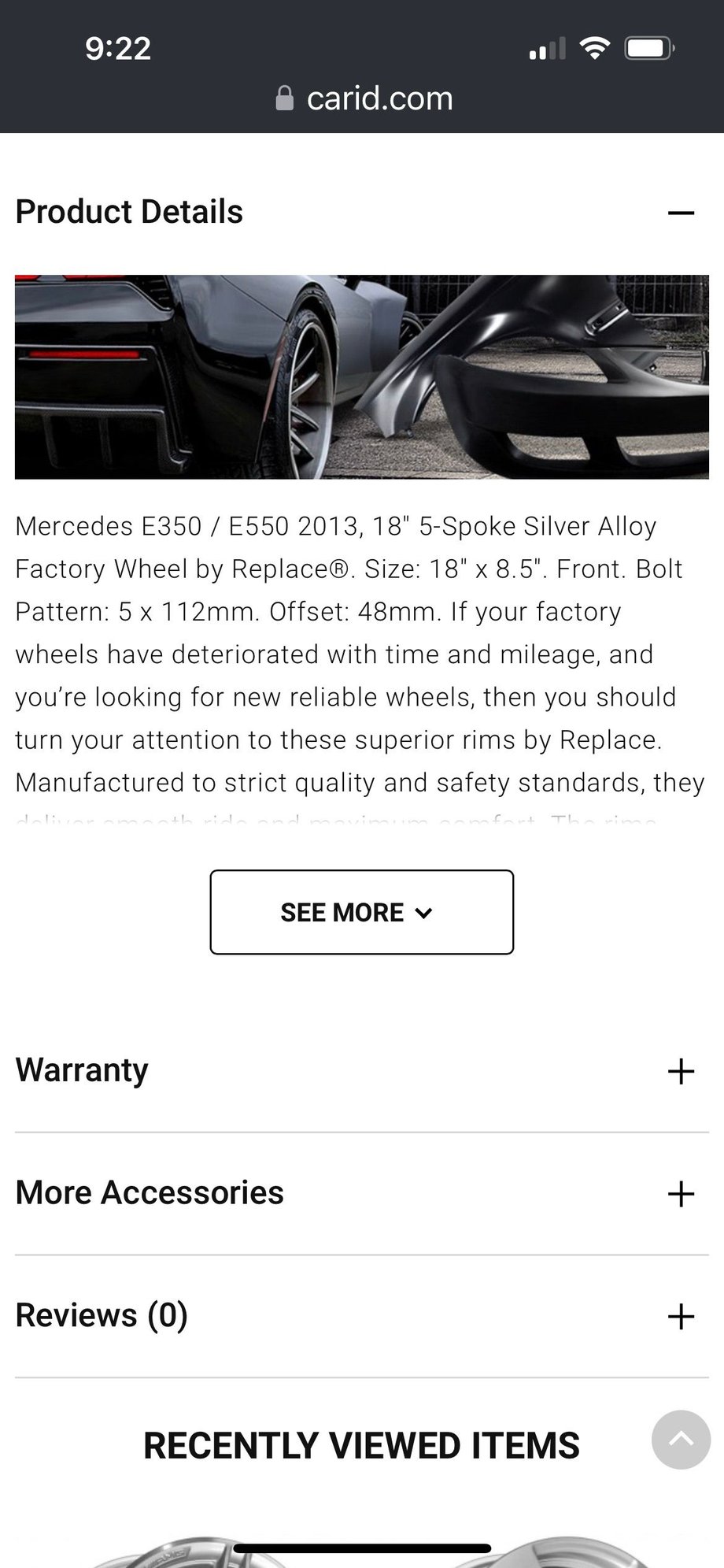

question - anyone know this brand “Replace”? Any good?
it says a 48mm offset. Anyone know what the offset is for the AMG wheels I have now? I see 42 and 45mm on web searches. I want to keep it as close to original as I can in that respect.

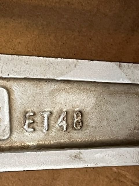

I think the offset on Mercedes rims are stamped on the inside of the rim. Same with the part number.

The offset marker is prefixed by ET, like ET46 is a 46mm offset

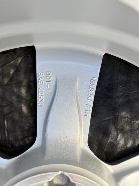

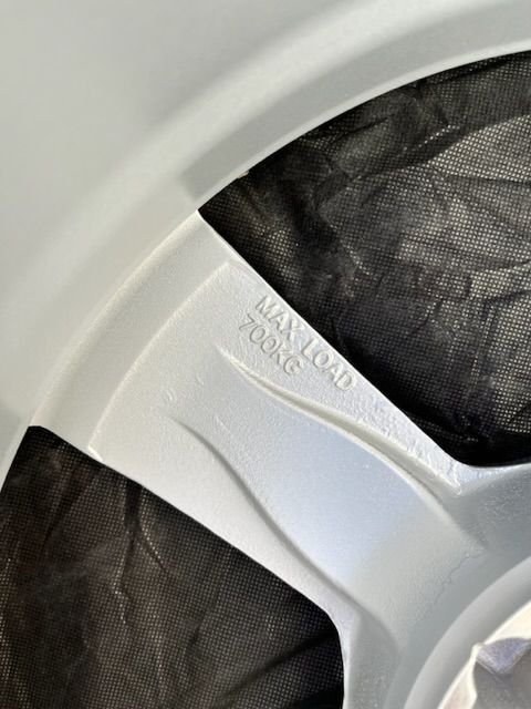

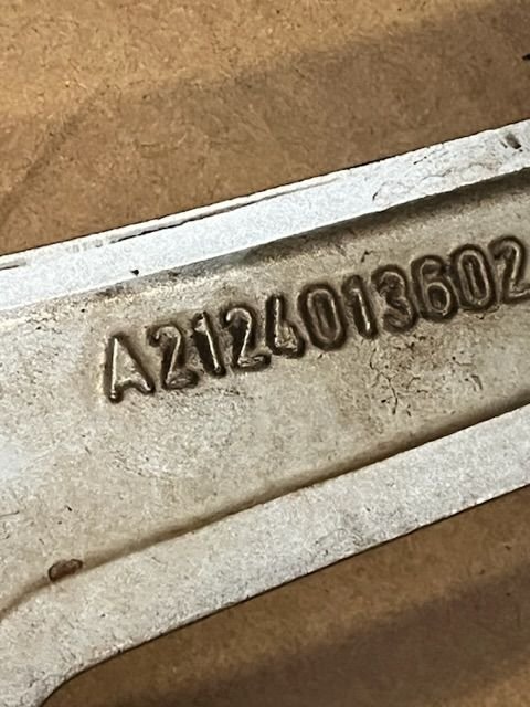

Rims came today, being installed tomorrow. Here are the markings on the insides…
I understand all of them except for the one with the funky pattern that is on the stem that also shows the 49 offset.

the GAWR for the rear of my e350 wagon is 1460 kg / 3219 lbs, or 730KG per wheel. a 700KG rated wheel is IMHO underrated for these rather heavy vehicles. you also need XL rated tires, which aren't available in all sizes, they too should have a load rating capable of handling at *least* 730kg each. the standard 17" XL tires have a load rating of 99, or 1709 lbs/775kg

I saw that too LCG. But mine is a sedan with 18" wheels. Doing the reverse math (and I'm no expert here whatsoever), but the 700KG translates into 1,540lbs each. The total weight of the sedan is around 4,500lbs with a full tank of gas? The 4 rims together are rated for 6,170lbs and the weight distribution is roughly 55/45 front/rear. So the heaviest would be the front at roughly 2,300lbs with the front rims able to hold 3,100lbs.
Now I'm no expert by any means or by any measure, but I kind've also have to believe the company selling them and printing the part number specific to MB on it, along with the other SAE and DOT stamps, probably did this math too (or at least their lawyers did)? I may come to regret this decision, I may not. But time will tell. The reviews I read seemed good. Fingers crossed!
At the end of the day, in all honesty, this car probably has another year or two with me max. Getting a little hard to get in and out of with a worsening lower back and liking the SUV idea more and more. I may pass it on to my son who should start to drive in about 2 years. Hell of a first car for a kid, but it's long been paid for, which means a hell of a first car for a kid via his dad's point of view too!

The BBS CH-R I use has 720kg TUV load rating per rim. Our tire if 97 load rating is 730kg.
Say the extra passengers and luggage load are at 600KG and is 70% for the rear wheels due to weight position, that is 420KG.
So 860KG of rear weight + 420KG = 1,280KG probable weight on rear rims. Limit 1,400KG
Front 980KG + (30% of 600KG or 180 KG ) = 1,160 KG. Limit 1400KG.
Total = 2,440 KG
Even adding a 5th 100kg passenger is still okey.
Adding say 50kg extra for more options and 50kg more if for 4matic, still okey.
700kg load rating per rim would be decent borderline I guess.

Doing the math on just one cup of coffee this morning, and from the sticker above, for the front wheel, it looks like i’ll have about 300lbs of leeway on the front axle per wheel. Maybe that will be enough to absorb the unavoidable pothole hit or two before another bend.
I would be curious what the load rating is for the AMG’s they’re replacing? I know these knockoffs are light at 18lbs in comparison to the AMG’s, so i would think the AMG’s have a higher load rating?

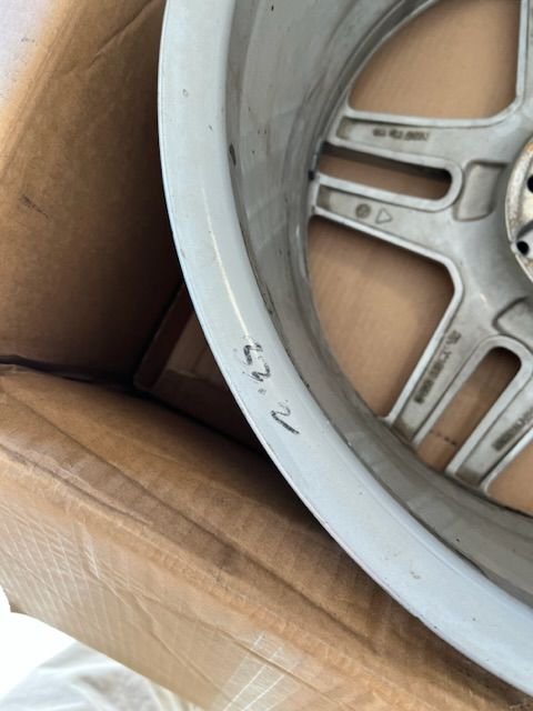

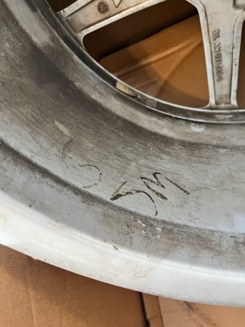

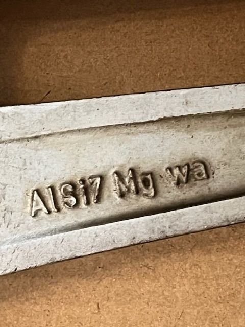

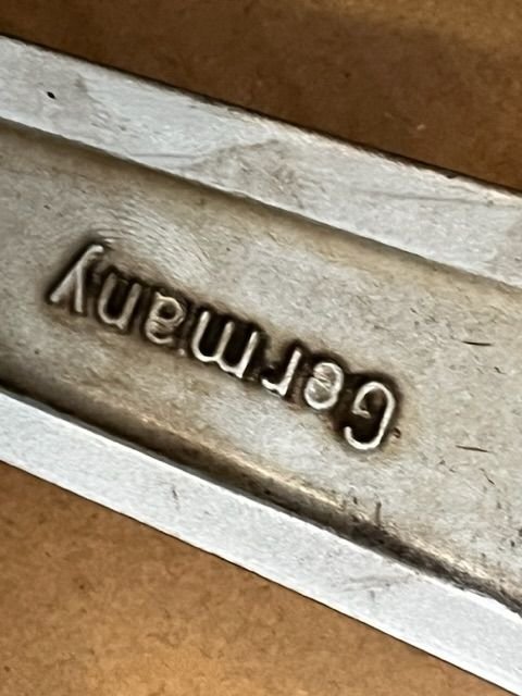

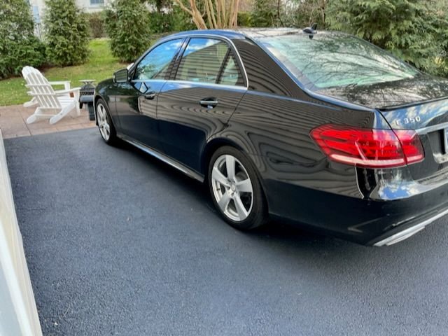

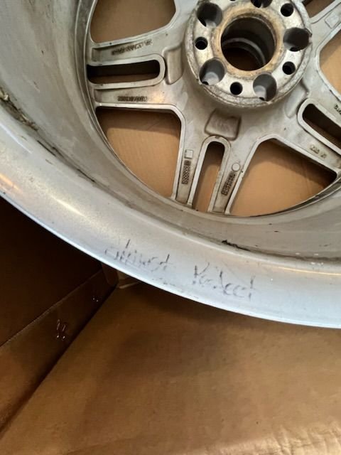

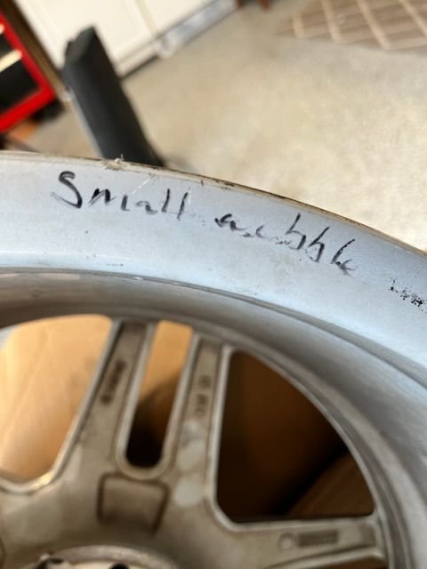

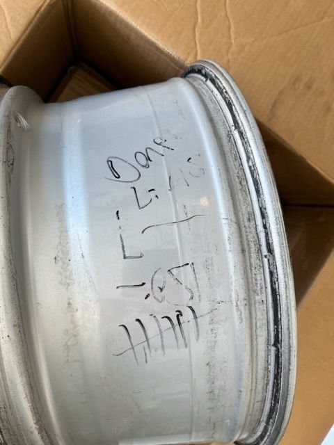

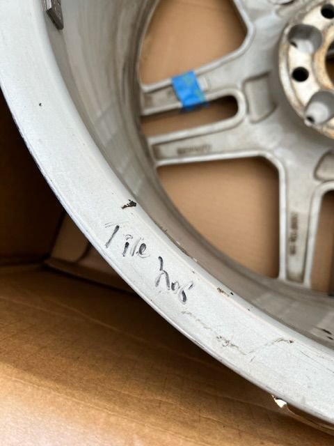

End result (can compare to the photo of before at the start of this thread).
The noise was absolutely the old wheels. It’s completely gone, and smooth as glass now. Sounds like it should at highway speed. So thankful to have this truly fixed now.

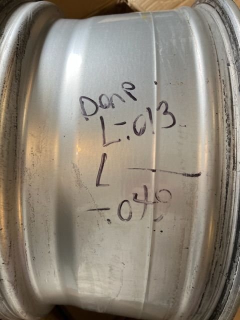

Here are some photos of the old rims. You’ll see comments written by repair shops in past attempts, like “almost perfect” and “slight wobble”. End of the day, I think just enough “slight” imperfections simply came
together as one and no way to truly get the wheels back in harmony with themselves. Interesting, only two had these markings, and the other two did not. Also interesting, easy for me to tell which two the dealership replaced in 2017 as part of the CPO process, and which two they did not…. Reason number 3,459 why I don’t trust a MB dealership anymore…

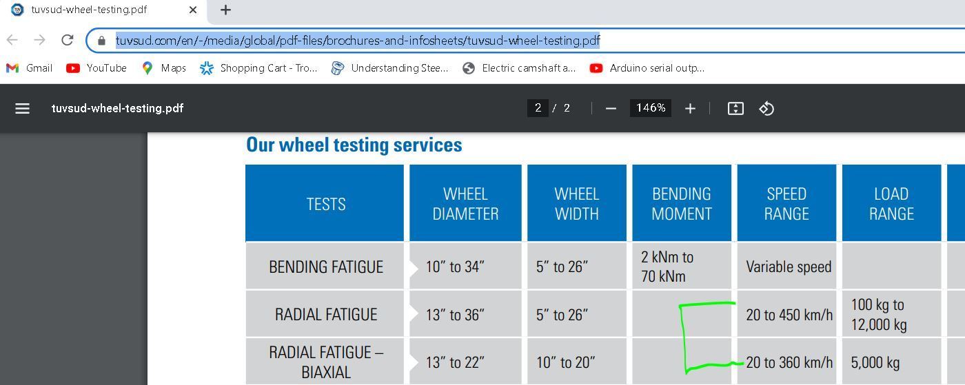

My original AMG or BBS has no load rating printed on the rim.
I have to go to BBS website to see the TUV / ABE certificate and the load rating is part of the data provided https://shop.bbs.com/en/certificates/CH-R?type=design
The AMG one I think if I know its P/N ( Ronald one ), I can extract the certificate from their website.
Germany is very strict so I read, even aftermarket rim must be TUV / ABE approved for one's car.
I am not surprised though. If cars can run at many section of the Autobahn at MAX SPEED legally, the last thing you want is inferior rim and tire.
TUV wheel certification service : https://www.tuvsud.com/en/-/media/gl...el-testing.pdf
What is TUV and ABE : https://rial.de/en/2020/02/21/abe-vs-ece/
I love the 450 KM/H speed range, so cool
Must be for Bugatti hahahaha
From left to right
JWL standard (Japan Light Alloy Wheel standard)
AM 033 maybe AMECA https://ameca.org/#:~:text=The%20Aut...nited%20States.
DOT-D Department of Transport , the extra D I dont know
I guess if MB has USA assembly/manufacturing plant in USA, it need is to follow USA standard and/or also have certification from USA DOT, aside from others.
