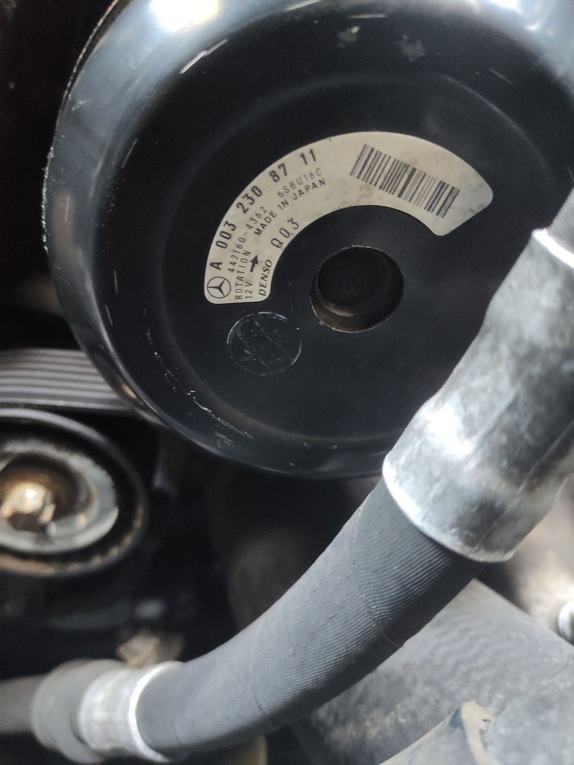

Also, post a photo of the old compressor sticker, and/or the photo of the electronic control valve installed at the back.
Alternative, if the new compressor is not in the car, photo of the sticker and the valve area. If I could see the valve completely I could try find which valve matches it w/o the diode.
There are two versions of each compressor, with and w/o the diode. So swapping the same valve type for one w/o diode is another approach

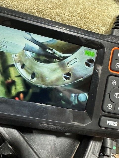

@JCM_MB I hate to bring up an old thread; however, I have a 2014 E350 Cabriolet with the same M276 3.5 as your W212. Over the weekend, my A/C stopped working, and when pulling the codes, it also came up with P064515. I took it to my local Independent Mercedes Shop, and they did a leak-down test and refilled the system. I checked for leaks, and there were none, but they stated that since the clutch didn't engage, the compressor was bad, so I should replace the compressor, drier, and o-rings for $2300. I have been reviewing your posts above and really feel like I should try to replace the magnetic clutch myself, as when I Disconnected the cable from the magnetic clutch and tried to measure resistance, I got Nothing, an open circuit.
I am slowly and methodically disassembling the clutch while waiting for the new part to arrive. I have one question, though:
When I pulled off the front pressure plate, I only saw 1 shim between the shaft and the pressure plate. Do you happen to remember if you had 1 or 2 shims? It's throwing me off, as the very nice ladies in the video who have a similar compressor have 2 shims. I've already lost and eventually found the 10mm deep in the engine bay (that was a fun hour with a magnet on the borescope), and I could have missed it falling when I wiggled off the pressure plate, and since it's so small I may not have heard the "clink" if it fell.
Thank you in advance for your time.Many others and I owe you your choice of beverage!

Honestly, I do not recall if one or two shims on the E350; however, I did fix the ML350 clutch magnet as well a few weeks ago, and there was ONLY one shim.
https://mbworld.org/forums/m-class-w...ml#post9122778

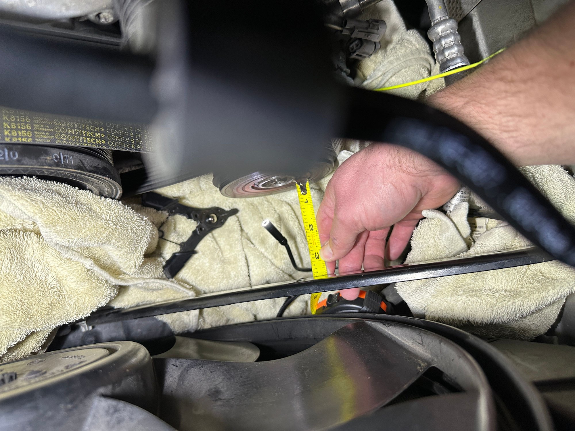

Distance to bracket
Distance to bracket
@JCM_MB Quick question does your W212 have this support bracket for the radiator fan ? While I waiting for the good set of snap ring pliers to arrive I cut down my cheap set to about 4.5 inches just to see if I could get any kind of headway here with the straight head that you recommended in your post. The good news is now I’m not into the radiator fan with the handle of the pliers.
However I keep hitting this bracket so I’m wondering if I should try to remove it to give myself more room.
It’s all a moot point if I could get a hold of this with the 90 degree head but they don’t open wide enough to do anything with the snap ring.

MIne car does not have that bracket. You can see the photos in post #5. Fan cover, and the frame at the bottom.

Hey guys i'm new to the forum and i would hope you would give me some of your experience.
I am having troubles with my ac which is not blowing cold air. It started working only when the car was cold and now it does not work in any case.
I suspected the magnetic coil which i disconnected the plug today and got open circuit but when I tried to measure the incoming voltage i got nothing.
My car has the Denso 6sbu16c compressor.
What would be the next step the magnetic clutch replaced or the control valve.

Hi, which specific codes do you get after scanning the AC module?
There are multiple variants of the 6SBU16C, a photo of the front of the AC compressor will help. Have you measured the resistance of the magnet coil? or the resistance of the ECV?

I have no codes. The resistance of the coil shows over limit. The ecv i jave not tested
I only have this photo from the car
This is from the web

Well, if the resistance is infinite, i.e. open circuit, the magnet is toast. Have you seen the magnet replacement on sale anywhere? The one I used should be similar, but I have never worked on that specific pulley. Not certain the diameter would be same as the one I used.
