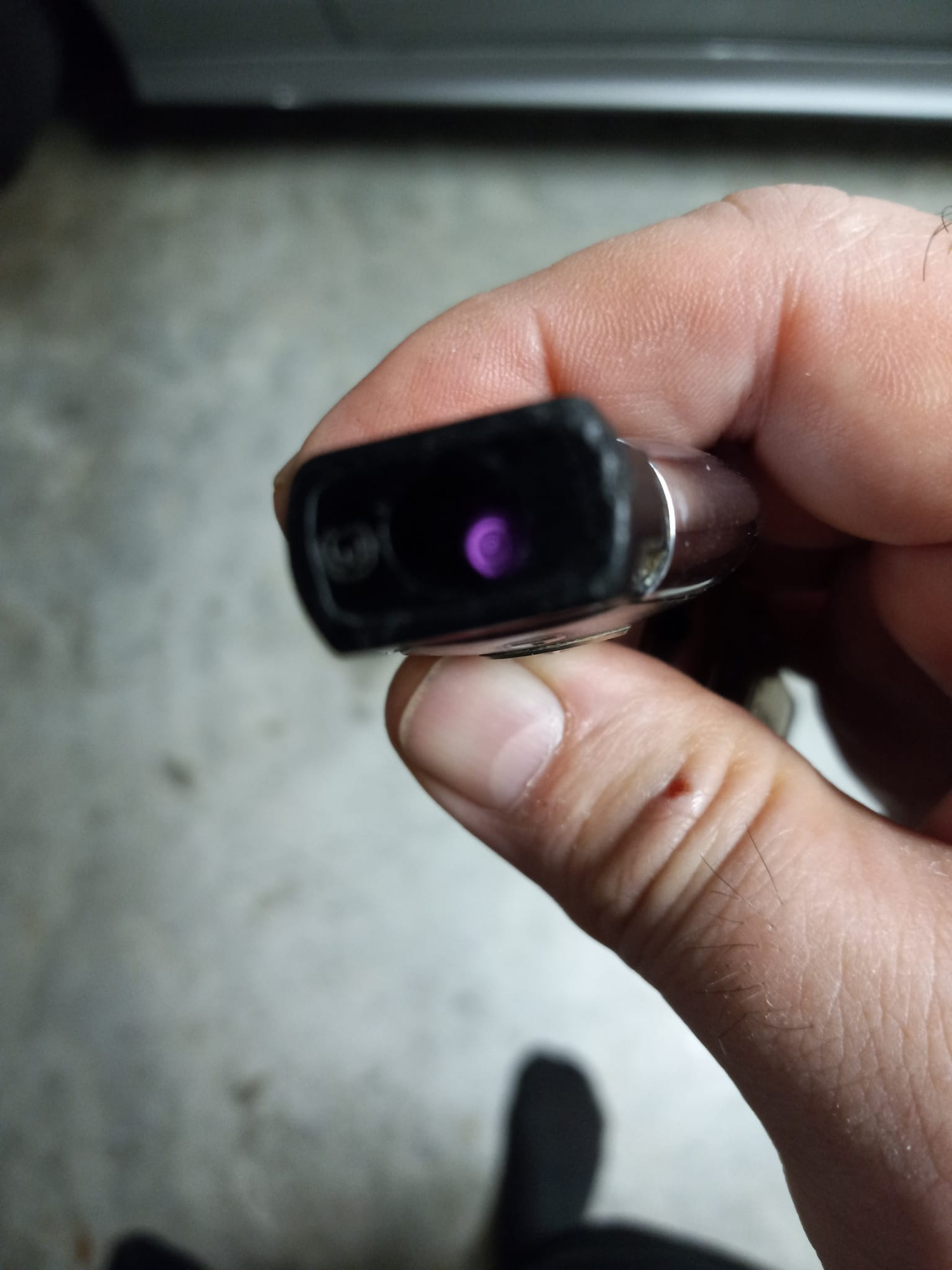

I went to the garage and tested the keyfobs for the W212 and both passed the red LED, and the camera tests. They should since I alternate keyfob usage daily.
However, sister's W211 failed both miserably. So I changed the batteries and both tests passed. Here is the picture from the camera test on the W211 keyfob. Yours is up to something, and the working keyfob should pass both tests.
Thank you for pointing this out since I was unaware the W211 had discharged already.

Did you check the working keyfob shows both lights: red on the button's side, and the one in the camera? Just to be certain your keyfob behaves like both of mine (I had done this test on an ML 2009's key fob and also worked).
I recall reading about these tests some time ago.

I do not have keyless-go in my 2014 w212, but the w211 has it. Both keys have the lavender color when the lock/unlock is pressed.
