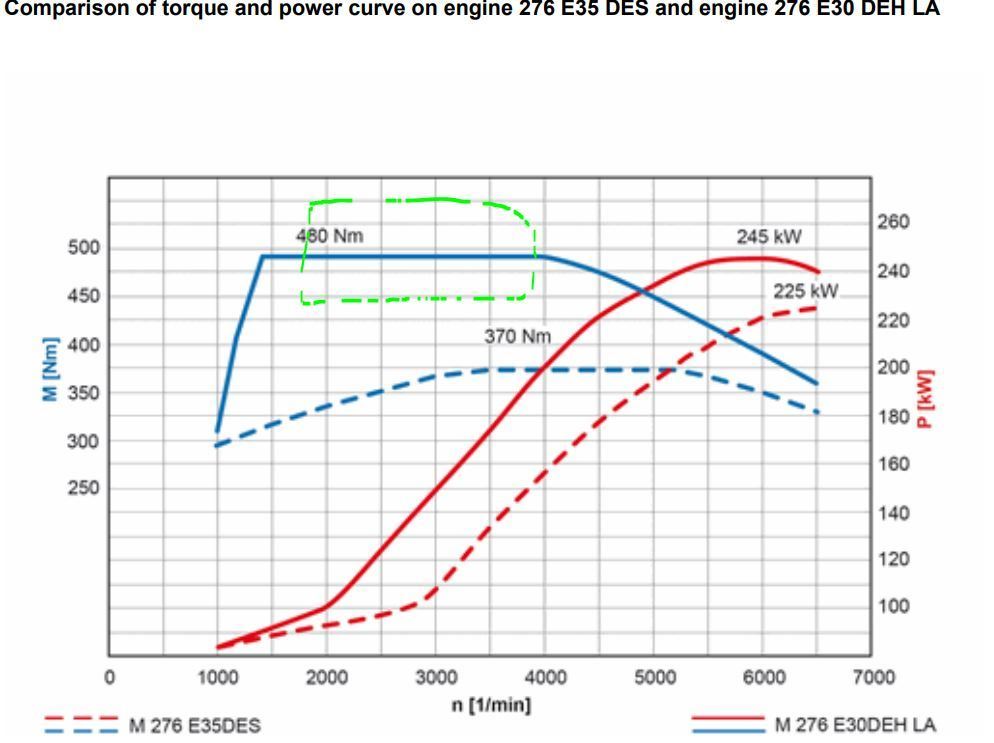

, I tried using dyno mode at the track and could not get the tires to be over powered by the engine, granted I was in 2nd gear as lowest gear , but was 4,000ish RPM during those corners
where I tried to turn using the car azz.
I find the engine torque curve is not suitable for azz wiggling unless at 2,000 to 3,500 RPM, pass this RPM its a flat curve. Its a city car power profile.
For some reason I also strongly believed that even traction controlled being OFF with dyno mode, the throttle management of my car is COMFORT/POLITE oriented.
It will be useful too for dyno mode that the throttle is a polite one since the rollers on the dyno meter may not grip well by too rough a throttle input.
