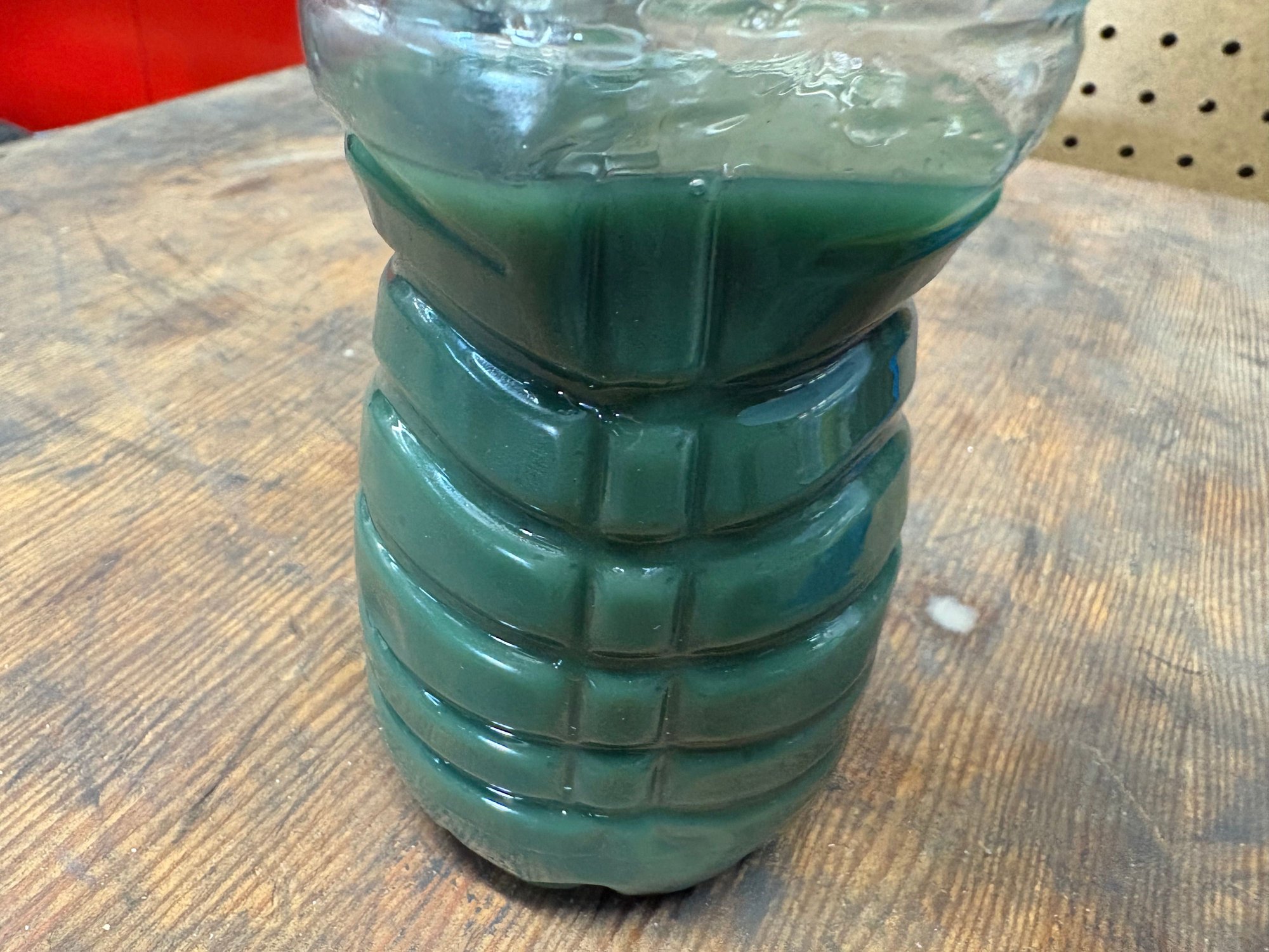

Thank you for your input sir.
The shop used the Pentosin blue ATF fluid not the OEM MB fluid.
There was definitely a sludge mix of the trans fluid and coolant in the reservoir. The oily smell of trans fluid was very noticeable when I opened the cap.
I am very sure the dealer replaced the transmission, the first time. They mentioned to me that they did not want any future issues so the protocol was to replace everything. The paper work had all of the parts listed including a reman transmission.
The independent repair shop only replaced the fluid that was in the pan, including the filter and gasket.

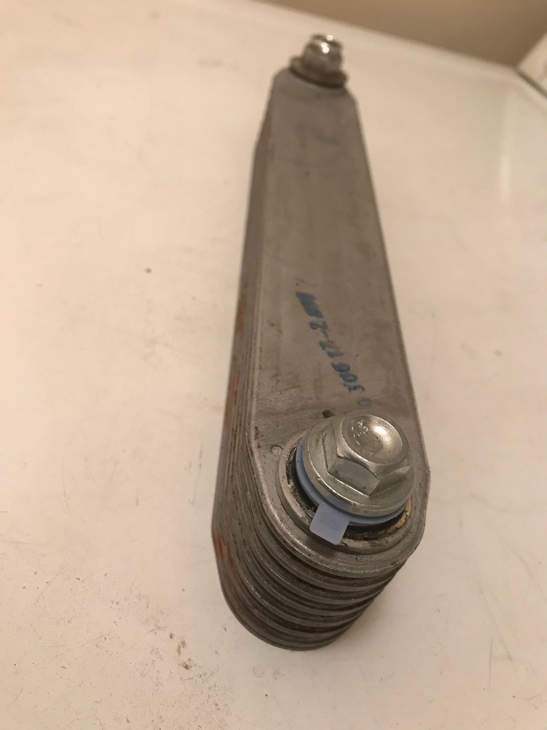

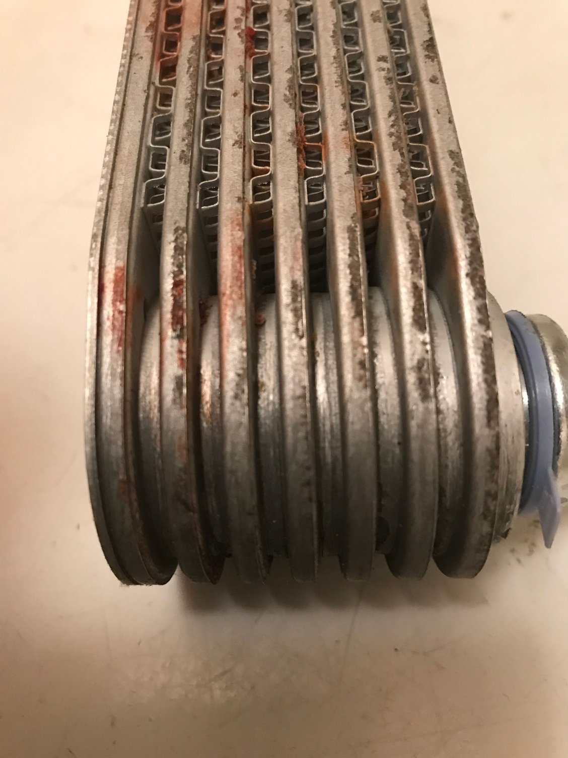

Same experience
Same issue with my 13 E350 bought two years ago - perfect car, 80k miles, all services done. After driving it less than 100 miles, coolant overheating.
First MB indy mechanic, flushed replaced coolant lines, and trany filters and fluid, same thing happen less than 200 miles later.
Trany was removed, rebuilt. Now all is well.
Culprit was the trany oil cooler in the radiator. Its seals failed allowing high pressure engine coolant into the trany, ruining the clutch faces.
Here is the photo of the problem. Note the red dye where the seals failed.
red dye at the end show failure.

Old May 1, 2025 | 11:36 PM
T2IV's Avatar
Joined: Feb 2025
ML350
Follow Up
Originally Posted by T2IV
Thanks for the response - I may have mis-spoke. Originally they did find a milky texture/appearance in the transmission fluid -- prior to the rebuild. I'm now doubting that they rebuilt it after the first rebuild. After discussions with the mechanic, it sounds as if, on the subsequent trips to the transmission shop, that they were trying to adjust the shifting adaptations via software. But after driving for a few months, the adaptations would get out of range and the problem would re-occur. It's back in the shop for a 4th time (in 11K miles) and apparently they are (again) finding the transmission fluid to be milky white (as it was the first time around -- but they found no leaks). The transmission mechanic apparently purchased test kits for water (negative) and also for coolant (also negative) so they apparently just sent a sample out to a test lab to determine what fluid is in the transmission fluid (seems like it has to be one of those two -- likely the local test kits weren't sophisticated enough to determine) to see if they can figure out the situation. They don't believe that there is any leaking between the radiator / transmission oil cooler - and they seem to be separate but conjoined, if that makes sense - but the more that I read about it, that seems to be the likely culprit.
The lab came back with water in the transmission fluid -- either through a faulty vent in the top of the transmission (AC condensation?) or condensation in the transmission as it only gets driven 4K-5K miles/year and the fluid doesn't get hot enough to cook-off/evap any water. Fluid is green.
