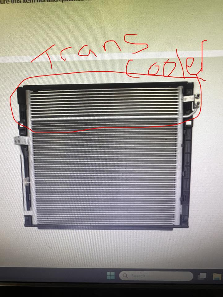

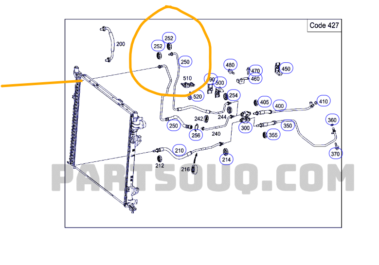

Related side note: I learned yesterday that, unlike the W212, the W166 (ML/GLE) has a separate transmission oil cooler attached to the AC condenser, rather than sharing it with the radiator.
I wonder why MB did not do the same for the W212, since they are contemporary designs.
