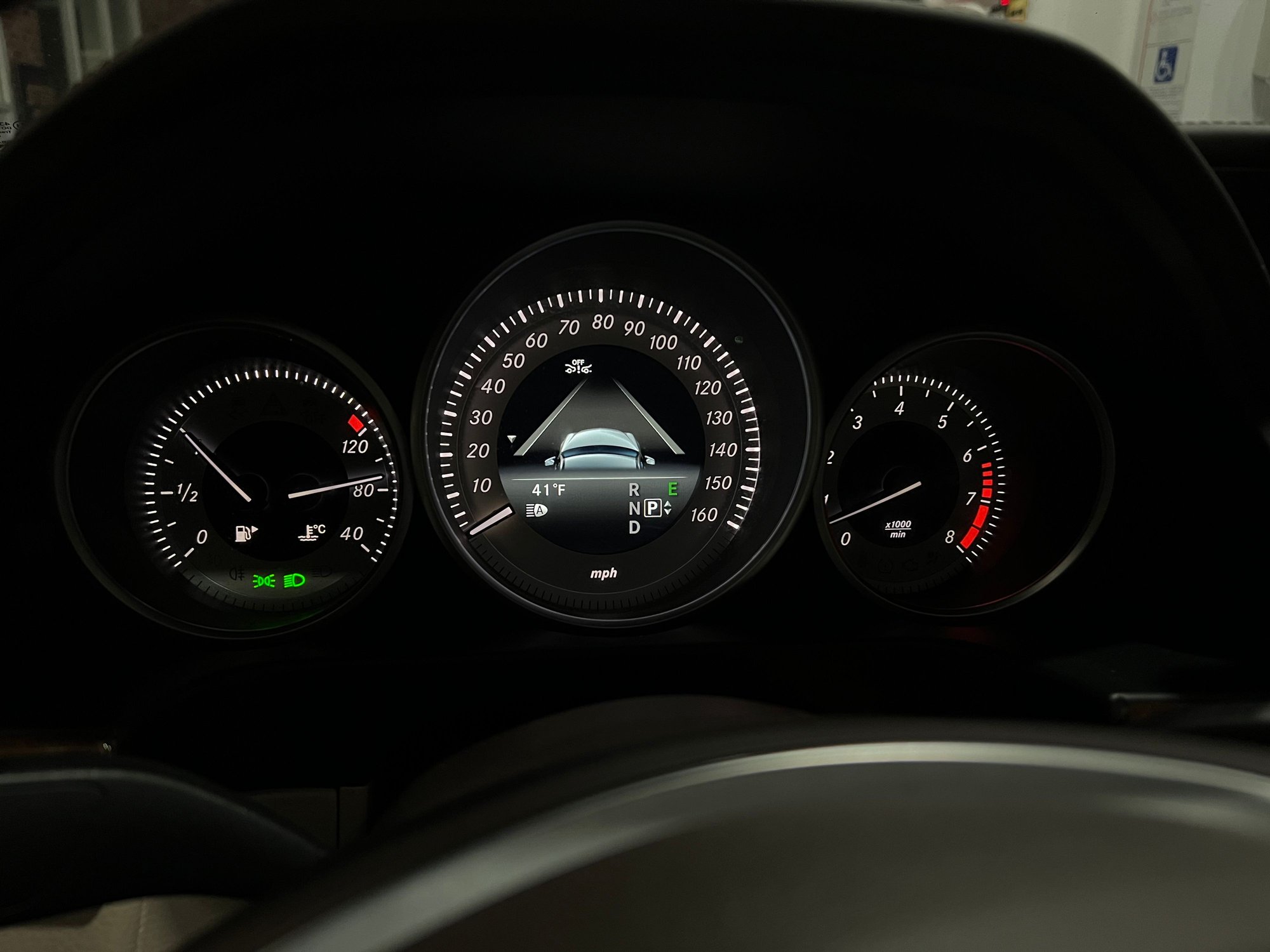

hey all, a week or so ago i was here asking about my temp gauge dropping further than usual. turn out it was the thermostat

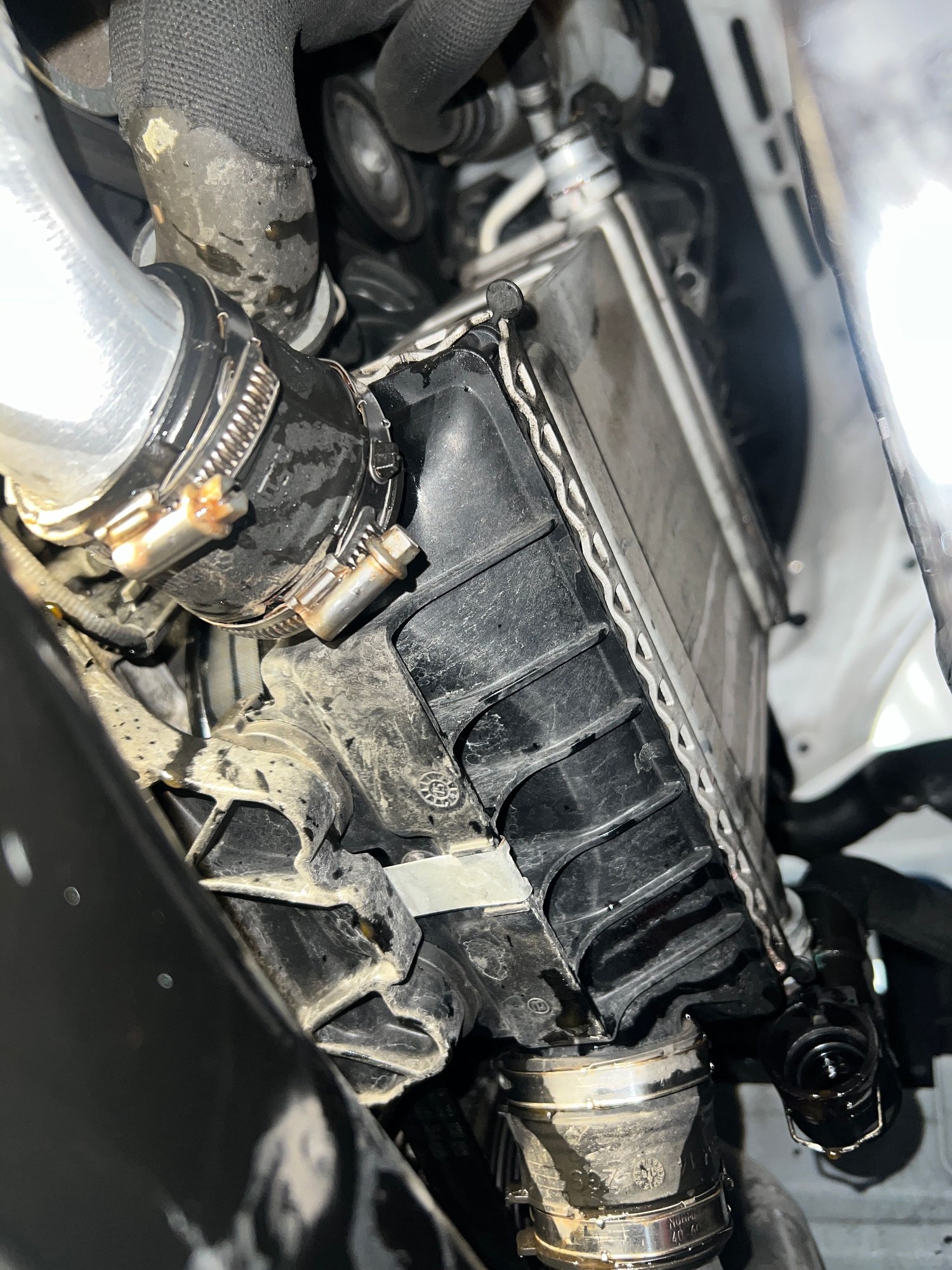

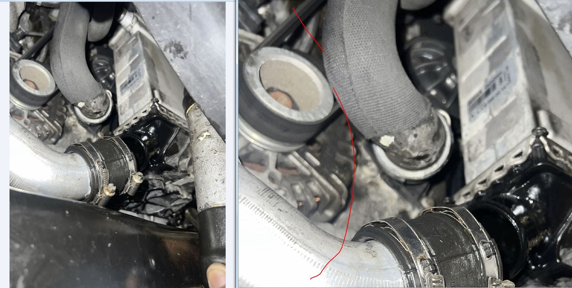

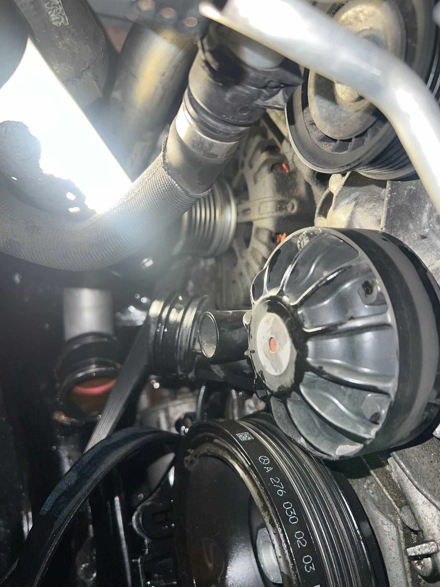

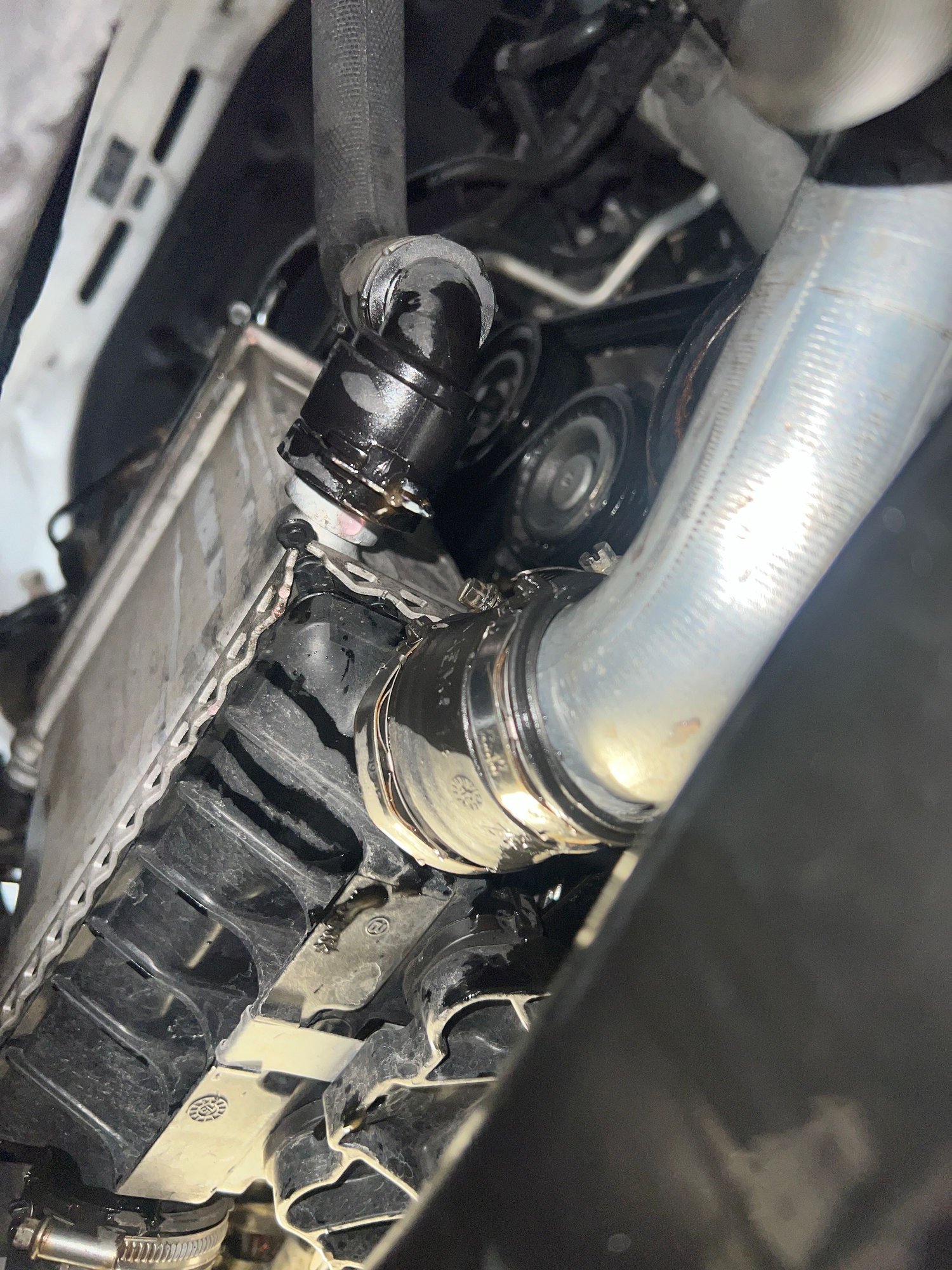

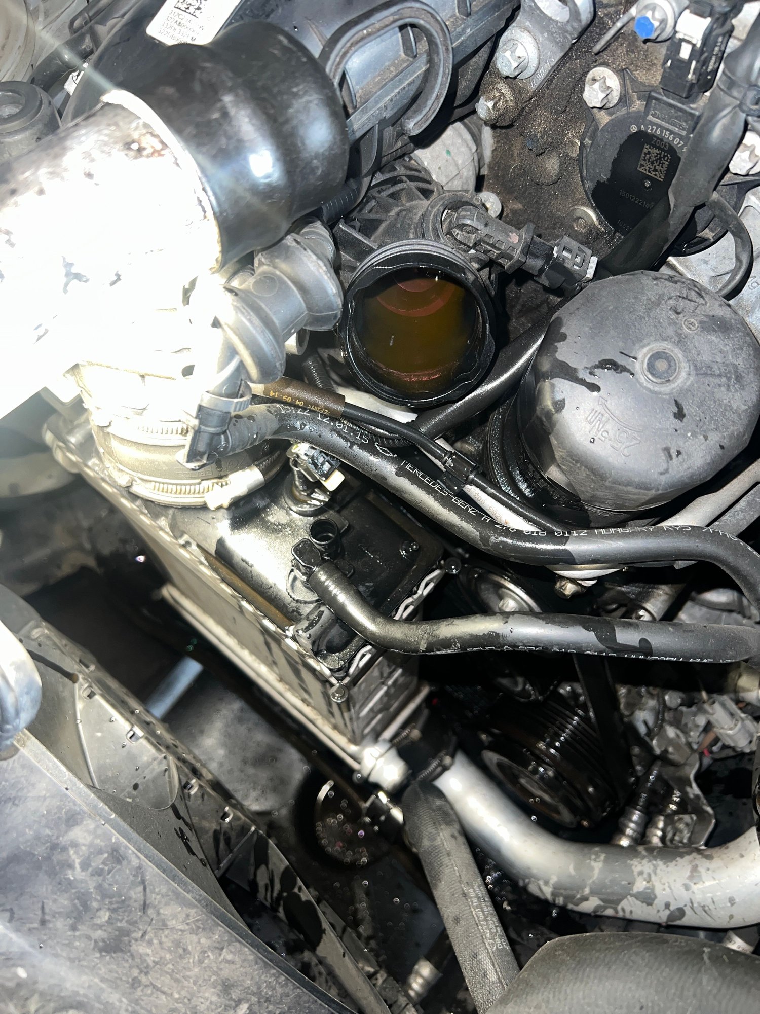

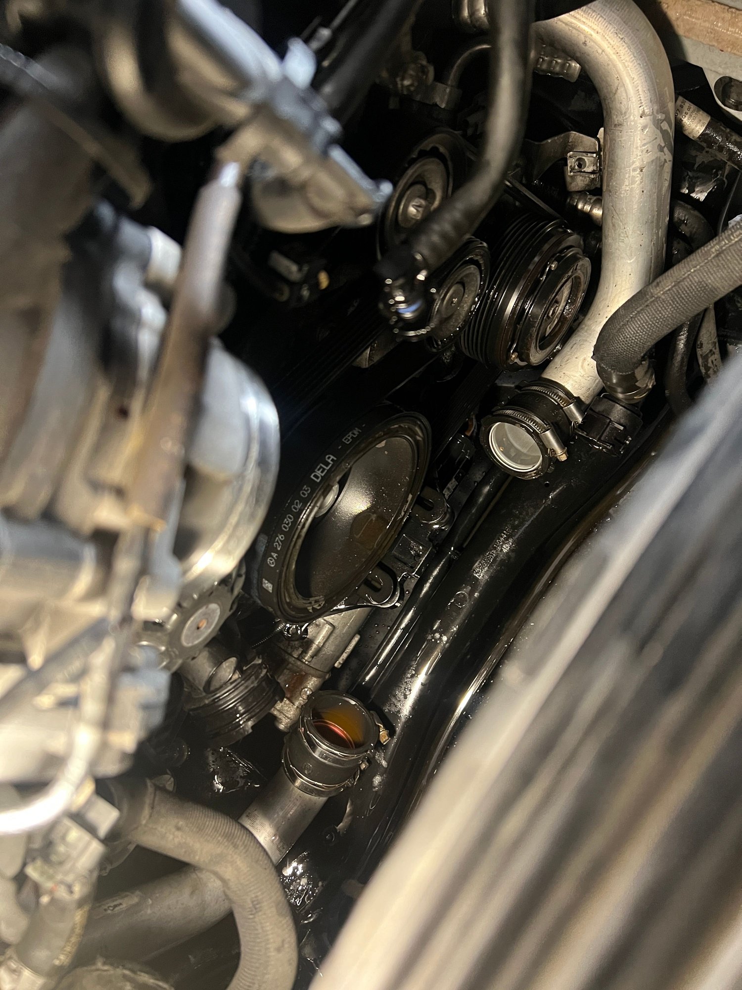

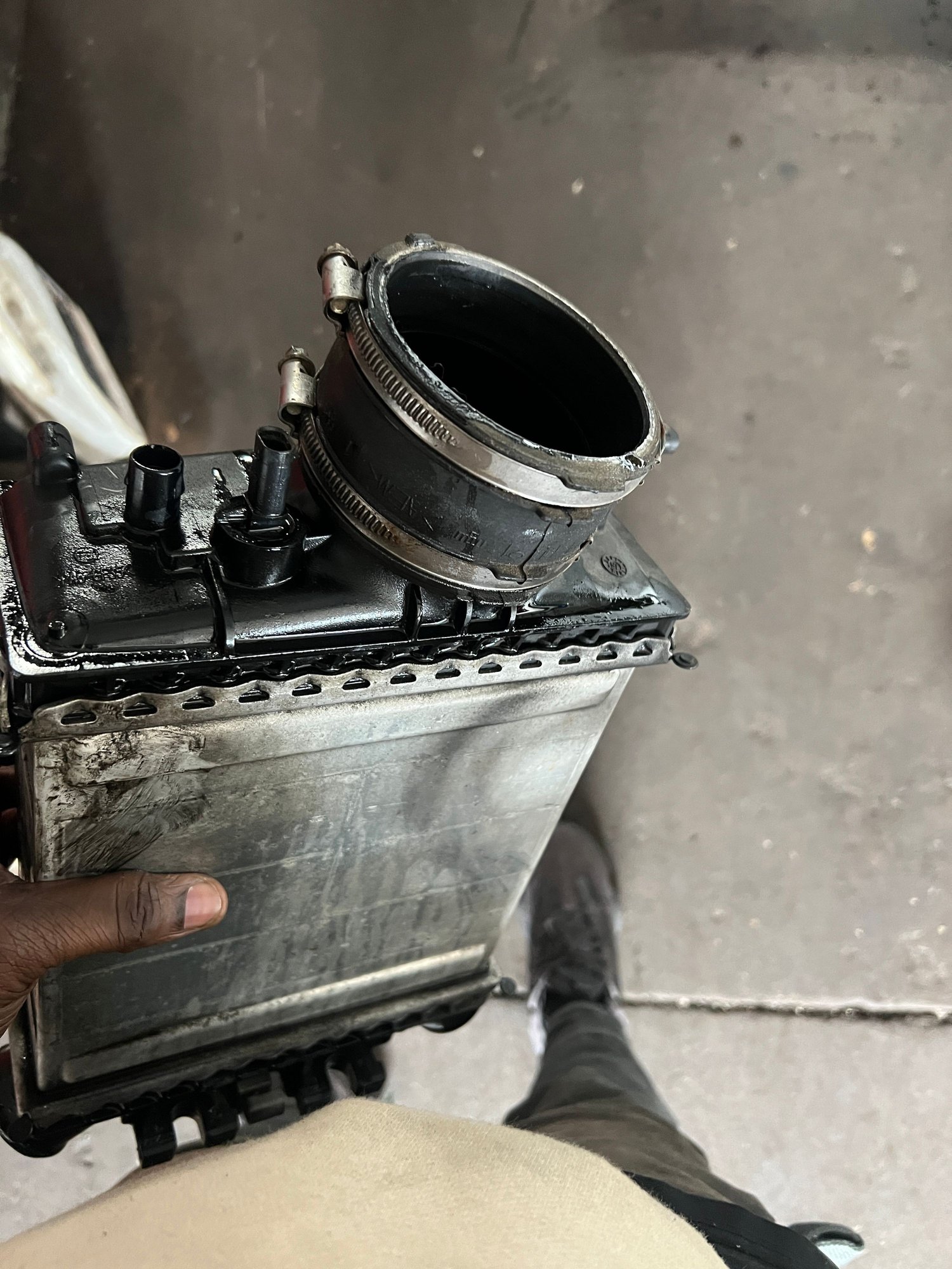

for those of us here with the TTV6, you have to remove the intercooler. i’ve posted a few pics here so you can kind of follow along if you like to DIY. sorry but if you need clarification let me know 🫡

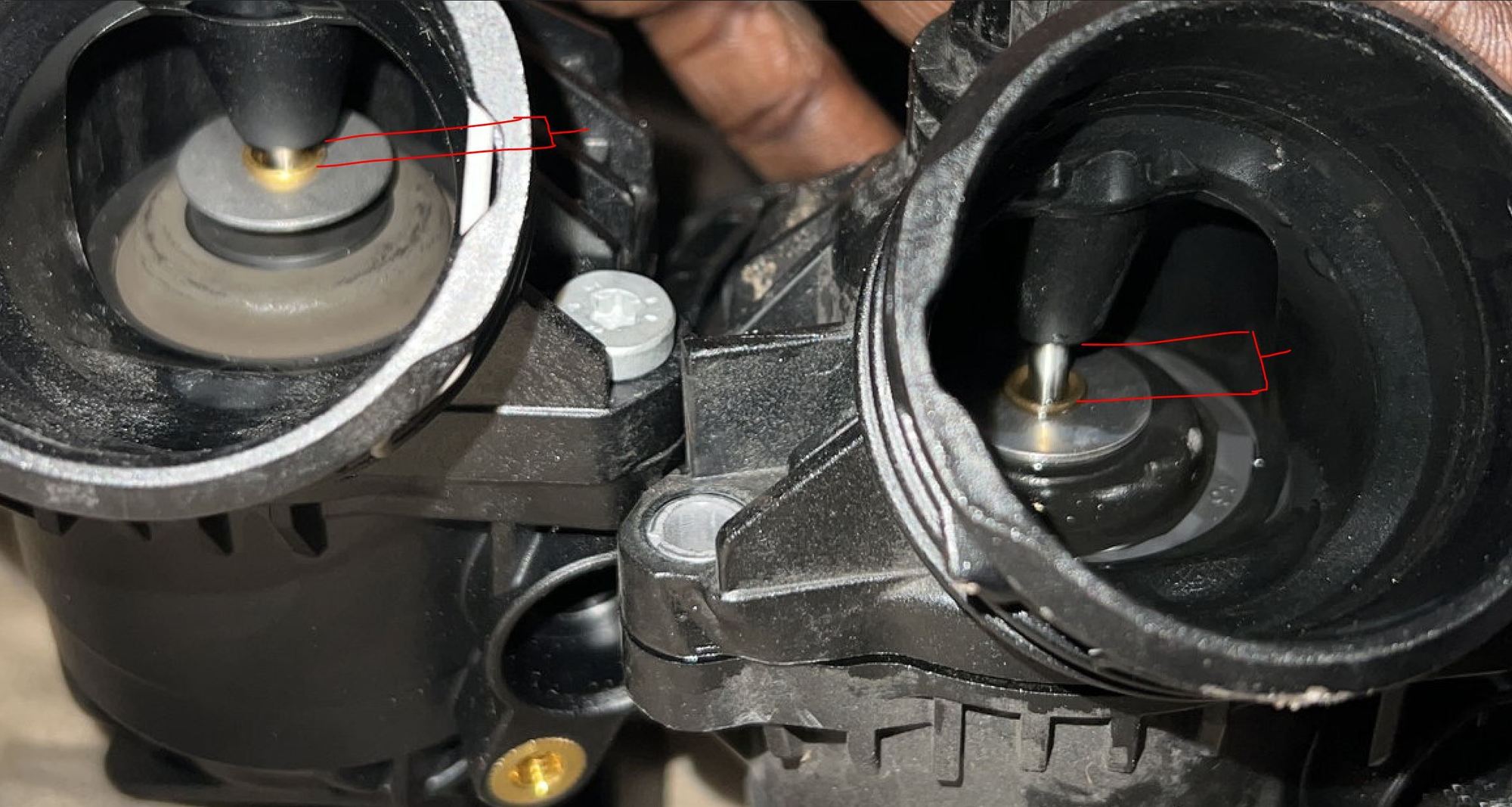

new thermostat on left, old one on right
you have to:
- take off the belly pan
- drain the coolant with either the little tab beside the driver side (left) front wheel [i didn’t i just pulled the coolant hose and then let it drain]
- i took off the oil filter housing to get some space
- loosen the clamp on the underside of the rubber that connects the pipes to the cooler, and the other big pipe up top that connect to the cooler
- (you slide the black rubber that the loosened clamps on on, downward into the pipes and away from the intercooler
- push that little piece up and slide the cooler forward and off
- gotta take off the belt, you know the deal, big ratchet and push left to loosen it and slip it off (mark it with a marker if you want)
- there are like 3 bolts to take off, to remove the thermostat
part cost me 145 and work was freeeee because it was personal work 🫡

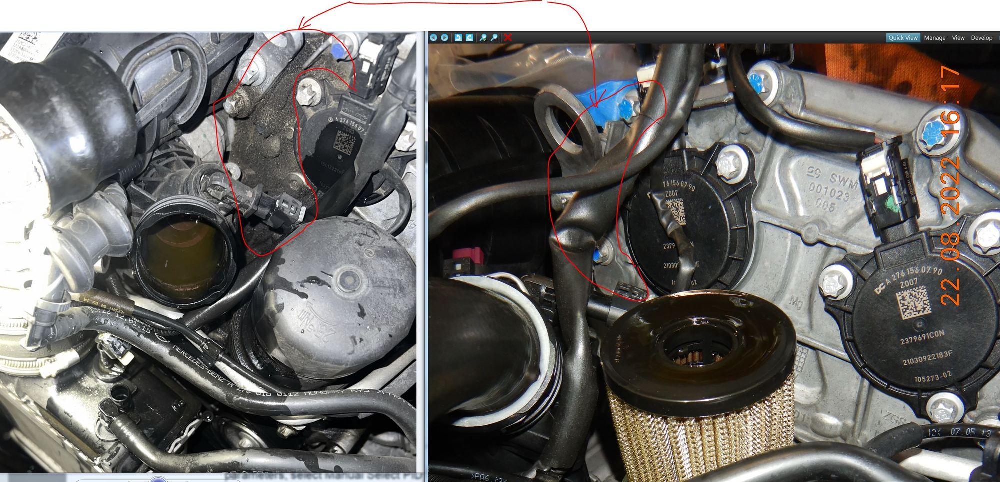

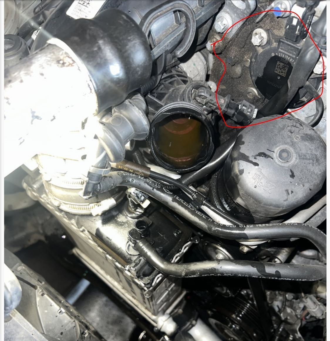

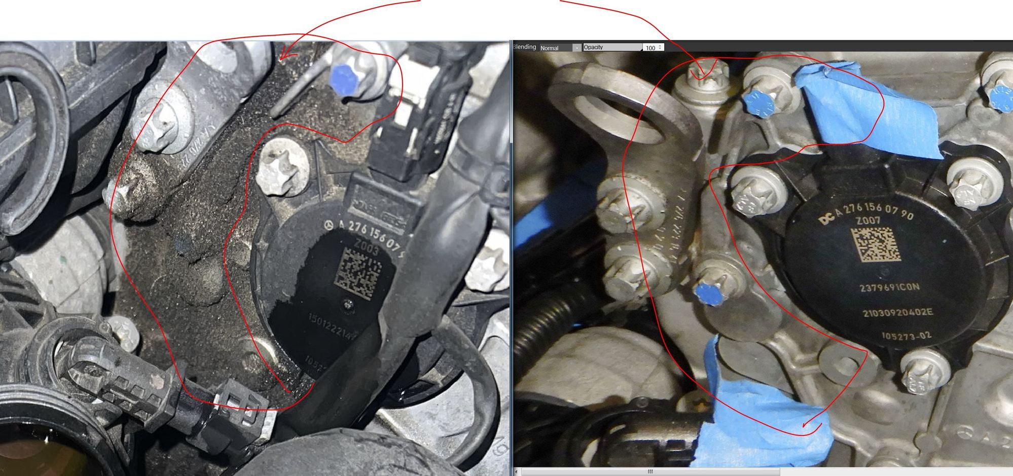

Wow... that is a lot of self-opening aka stuck
Shock,
You do have the VVT window leaking oil ... it would happen sooner or later.
Your alternator, its closest side to the engine lower block too.
Best to get rid of this leak.
hmm, those were dry before i got coolant all over the place so i’m not sure but i’ll look again and double check. you’ve given me something to look for. appreciate that

The VVT window leak , read here : https://mbworld.org/forums/e-class-w...lant-work.html

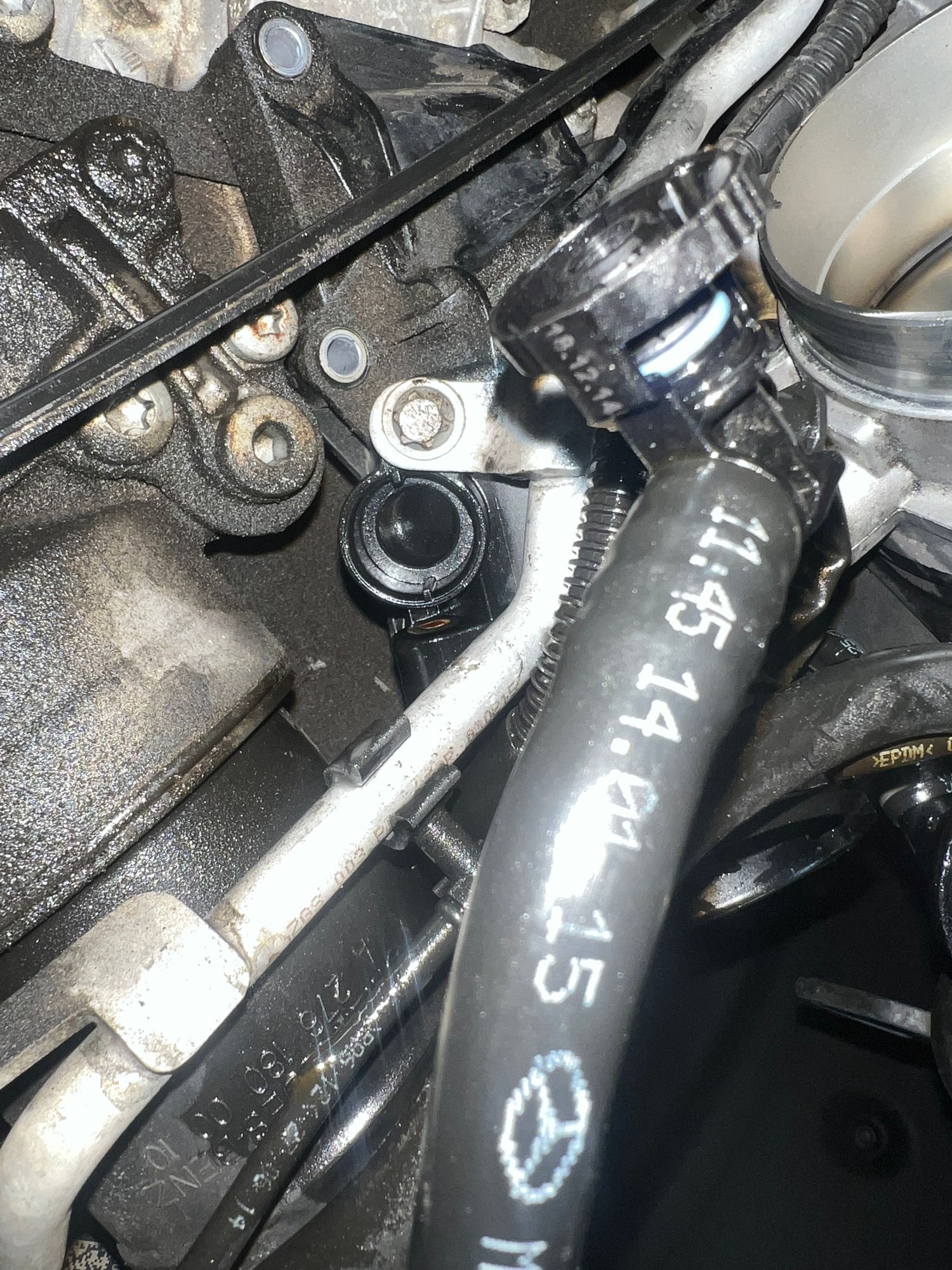

what i was saying was here is where i pulled the hose from, so it splashed a lot. but i’ll check and update you 🫡

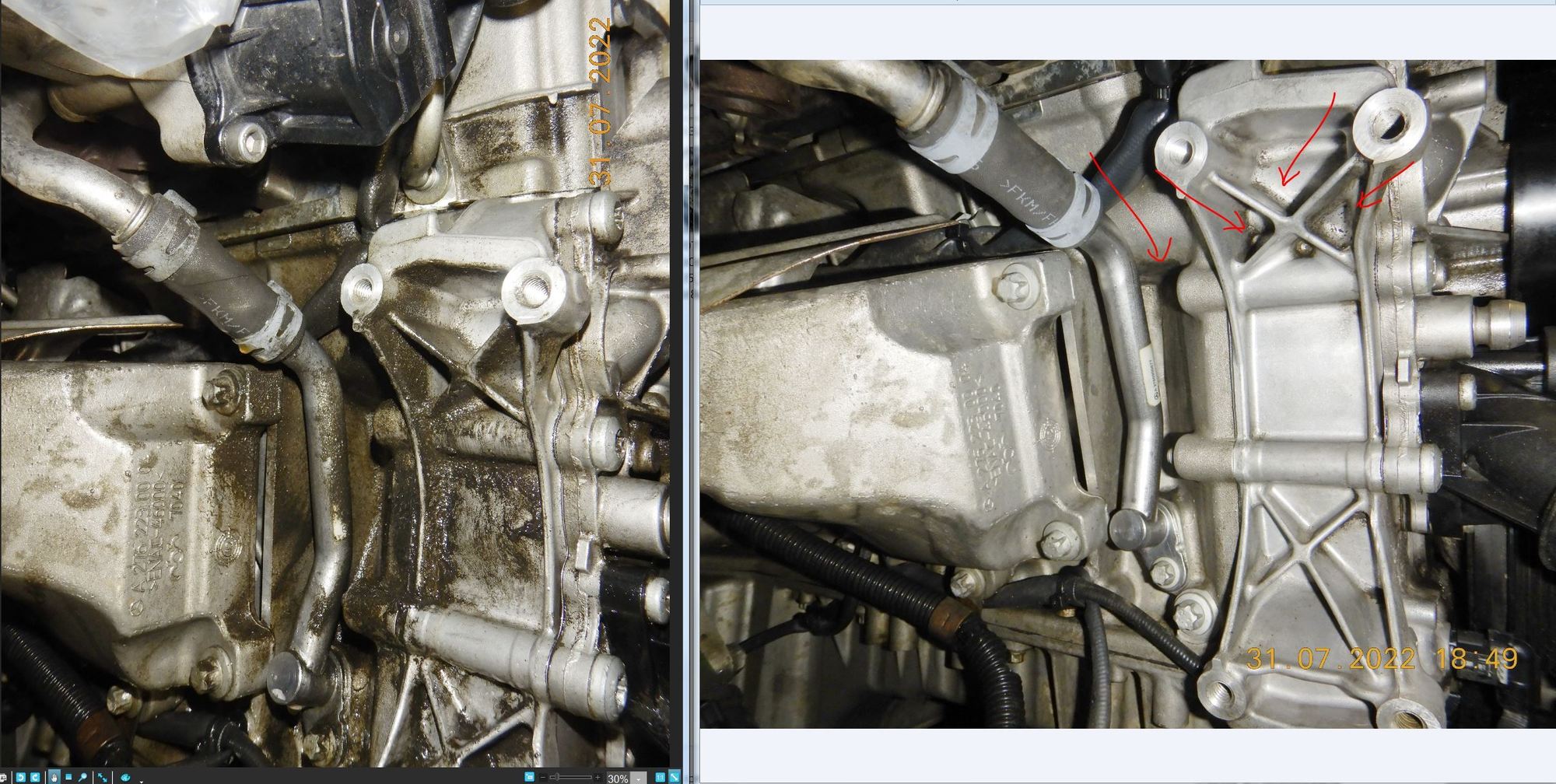

Wet from liquid coolant and oil trace accumulating dust are so very different visually.
We see better using photos, because when we work on engine bay, our eye height is too tall to see those oil trace accumulating dust. Flash on the camera also give us good definition.
Me with bad near distance eye and rely a lot on camera images...age related, what to do
To clean these area below I marked red on your photo, which is the engine block side of the alternator, I rely on photos a lot and its so difficult to feel only with fingers when the eye can't see.
Until you remove your alternator and start to spray de-greaser ( I use Simple Green & some Carb Cleaner ), a dried up oil film wont look so bad.
The red line above, is the engine side of alternator as seen at image below
Red arrows below is areas VERY VERY difficult to clean.
Happy cleaning............

ohhhhhhhhhhhhhhhhhhhh i see now, you’ve got a good eye thanks for the tip boss
