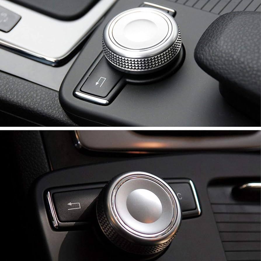

My command knob module, including:
the knob
The C button
The arrow button
has stopped working. All actions are dead
is it a fuse? Anyone know which one?
Also, dones C button and arrow button illuminate in Orange? I dont remember and it would help to know if the module has no power for a broken fuse
This model
This model

This is an electronic module built with marginal connections.
Either replace or resolder loose pins if it was not liquid soaked
rotary dial + tranny selector module
rotary dial + tranny E/S selector module
Nearby tranny button is the same way: solderless module.

-- These LIN modules are built with poor connections that oxidize.
-- Sometimes drinks get spilled...
You can SIMPLY DO A FAULT-RESET that will last sometime until poor networking condition is flagged again.
I have pics of the inside of these units... I got the whole chassis surveyed for gremlins nest
solderless connections
OPTO-COPLER + loose pins
OPTICAL SENSOR + loose pins
The optical sensor is sensitive to dusty contamination.
Same thing inside EIS Module as well.
Repair is either replace $$$$ or a 5mn quick 4x solder job... As mentioned: free reset also effective.
