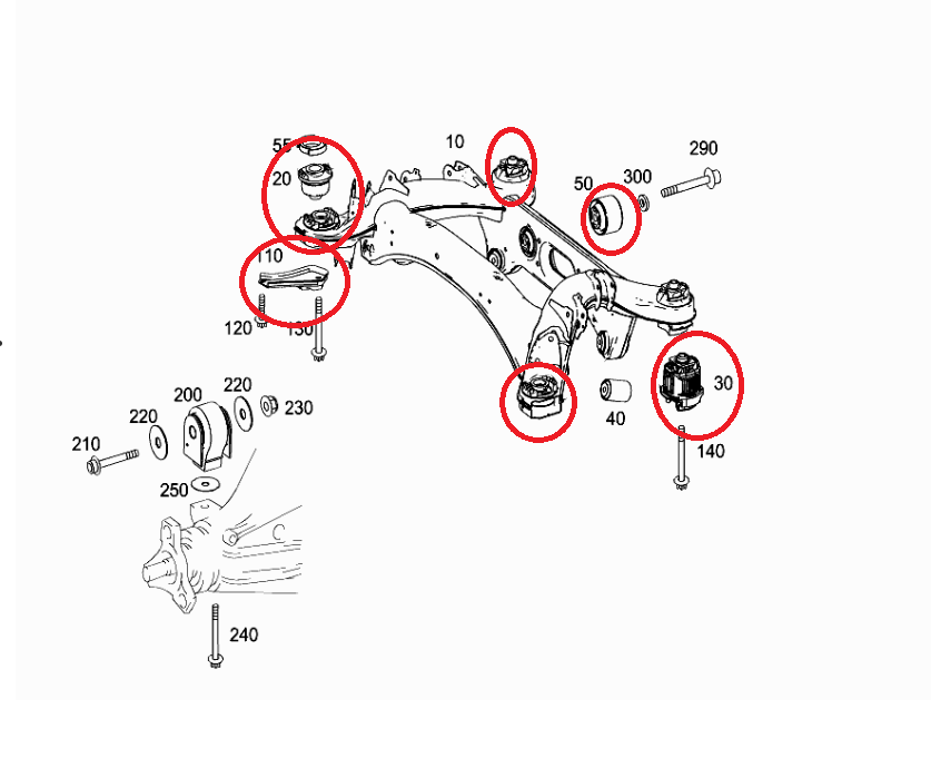

I just received the news today. The car is scheduled for a new rear subframe in two weeks.
Did the dealer supply new bushings and subframe suspension for those who have completed the dealer-covered subframe warranty service?
Specifically these items:
Axle Sub-Frame Suspension - Mercedes-Benz (204-350-02-75) x2
Axle Sub-Frame Suspension - Mercedes-Benz (205-351-00-42) x2
Rubber Bushing - Mercedes-Benz (204-352-10-65)
Rubber Bushing - Mercedes-Benz (204-351-04-42)
Bearing - Mercedes-Benz (204-350-02-15)

I would ask them to provide you with exactly what they will be doing to the car and list of all parts being replaced.
And if theres anything you want done now is the time to do it. Subrame bushings, control arm bushings, differential bushings, Control arms, sway bar, rear passenger brake line for example.
If my subframe were going to be replaced I would have all the bushings on it replaced including spring control arm bushings, differential bushings, and all the control arms replaced. Since the sunframe has to be lowered to do most of this work. I'd even have the sway bar replaced. I would buy all the parts and drop then off to have done though.

In the photos above where someone had the subframe replaced under warranty it looks like all the bolts and bushings are new. Thinking about it all the bolts should be replaced with new at least, im even guessing the bushings should be new also. I cant see pressing the old bushings out to install in a new frame being legit. And in my MB manual is says to replace all the bolts when performing the work.
I can see them not including new control arms. I would have that done. Along with the sway bar which isnt that expensive. And the stop plates since they are around $10/each.

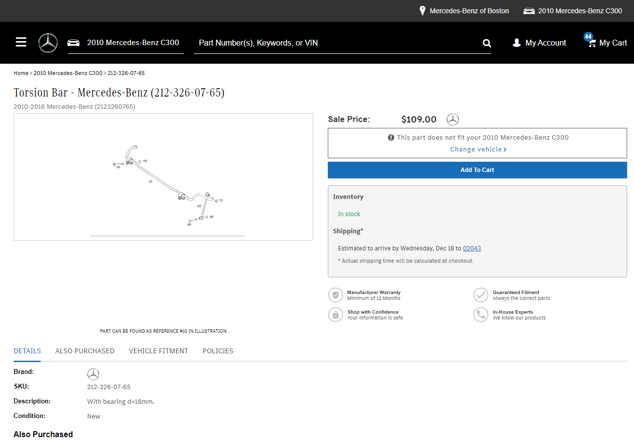

Parts list:
KIT-2043501606KT / KIT-212350 Meyle or Lemforder rear control arm kit $500 / $700
MEY-0141522109HD Meyle flex disk$74
MER-2123260765 Rear suspension stabilizer bar (Lemforder?) $102
KIT-2043200489L Lemforder Sway Bar Link Kit $44,
CTO-80001003 Corteco Differential Mount $35
MER-205352080064(x2), MER-2043520146,
MER-2043520246 (4 total) Stop Plates $60
OEM Rear Differential fluid - on hand
$806 / $1006

I was recently pricing new sway bars for my W204 which are similar to the W212 so I know they arent expensive. For that part # its $109 at my local MB dealer. From my personal experience I would go with Genuine MB whenever possible.
Alot of the time things like bolts and fasteners are less expensive at the local MB parts dept than places like FCP.
I picked up a set of stop plates at the dealer for around $12/each. There should be two, a left and a right at the front bushings.

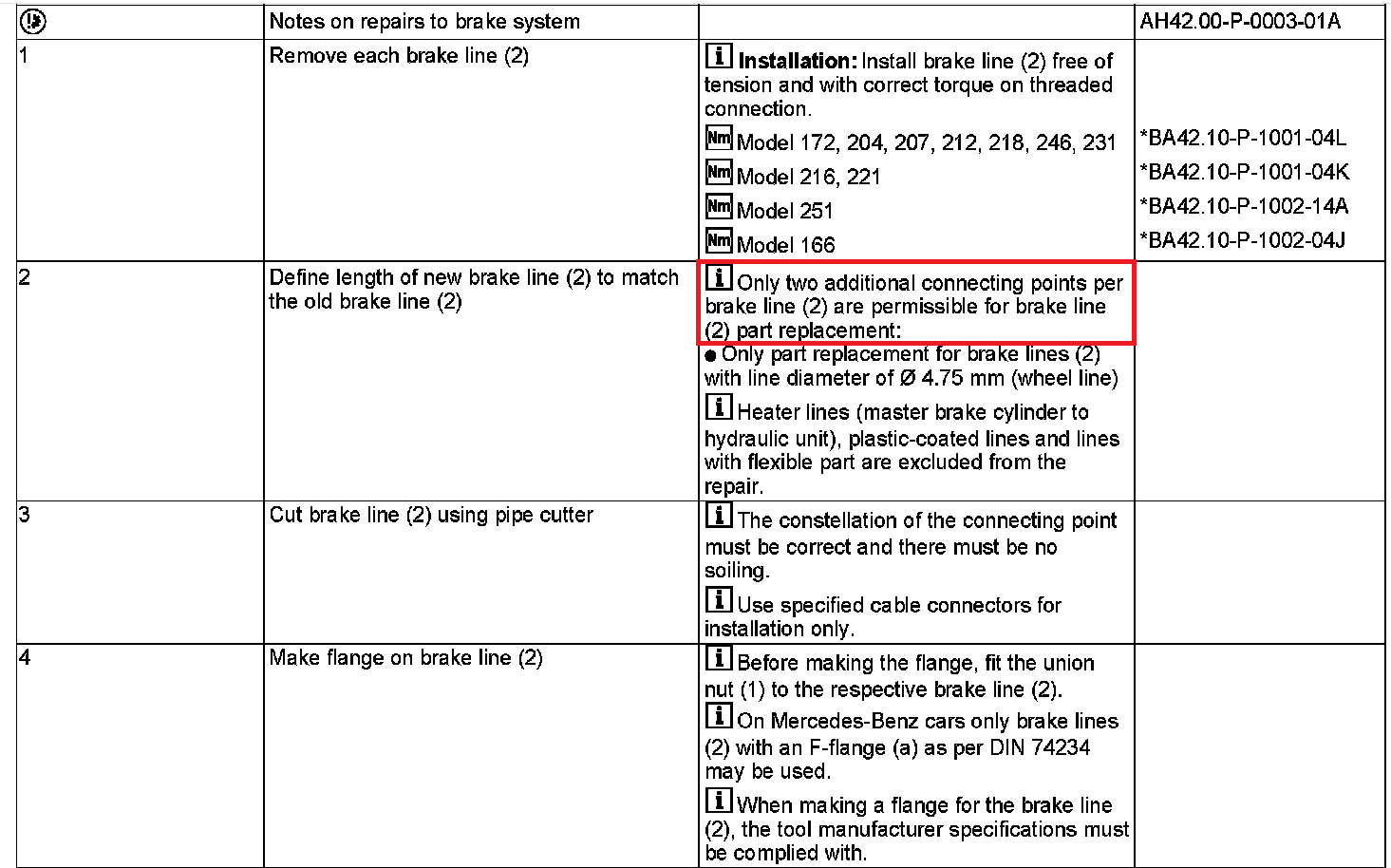

I forgot where i commented on splicing into the brake lines for repairs.
I was doing some reading and came across info the Mercedes manual. looks like it is an acceptable procedure to splice into the brake lines.
