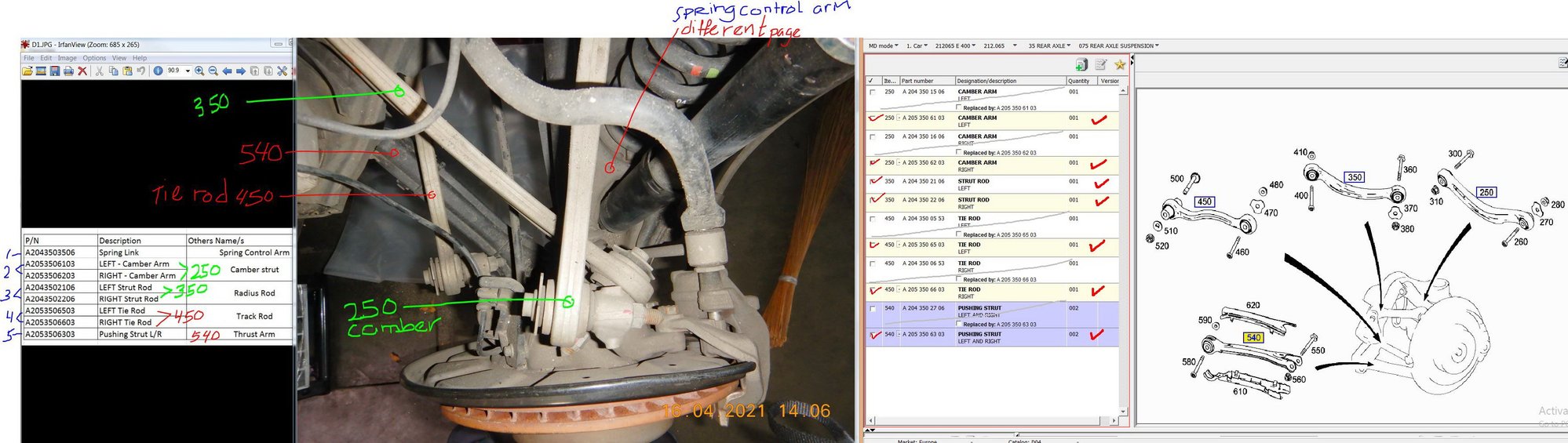

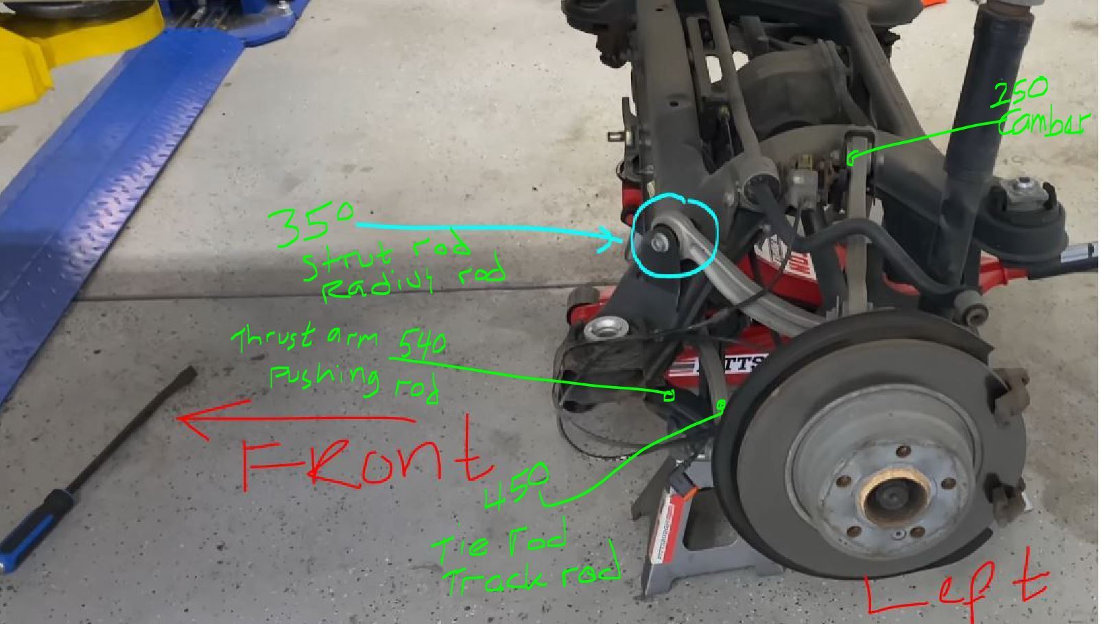

Starting to wonder about other things that should be looked into and or done as part of this repair. For example at a minimum determine the health of the rear shocks. Another question is do they drop the exhaust as part of this repair and would that facilitate a check / replacement of the flex discs / center support bearing?
If the subframe is free and ONLY SUBFRAME, there are two items you can do/replace while subframe is out and can only be done with subframe removed.
Arm #350, Strut Rod/Radius rod
and the stabilizer/sway bar assy.
Make sure the techy tightened the arm #350 at subframe side at PROPER simulated ride heght.......... while subframe is on the ground.
That #350 bolt and nut can not be tightened & torqued while subframe on the car...no room for the tools. Car body blocking our work.
The ride height can actually be known while subframe on the floor, by the cv drive shaft romess angle.
Or.......
Using marker pen on bushing and subframe arm holder, when subframe is still on the car and we do the simulated ride height.
This is how I set my arm #350 ride height subframe side when I renewed it. Yes, I had my subframe out of the car.
The suspension arm ride height is for both bushings, subframe side and wheel knuckle/carrier side.

In your picture it looks like the shock was connected to the assembly and disconnected from the chassis of the car. I would have thought that it would have been easier to remove them at the bottom. Do you think that is how the dealership will do it or did you do it that way because you were going to replace the shocks anyway. I am asking because if the dealership does it that way it should be super cheap to get them to replace the rear shocks.

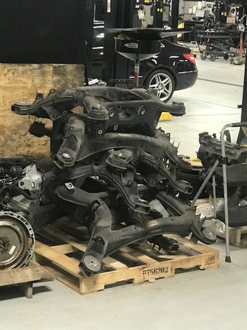

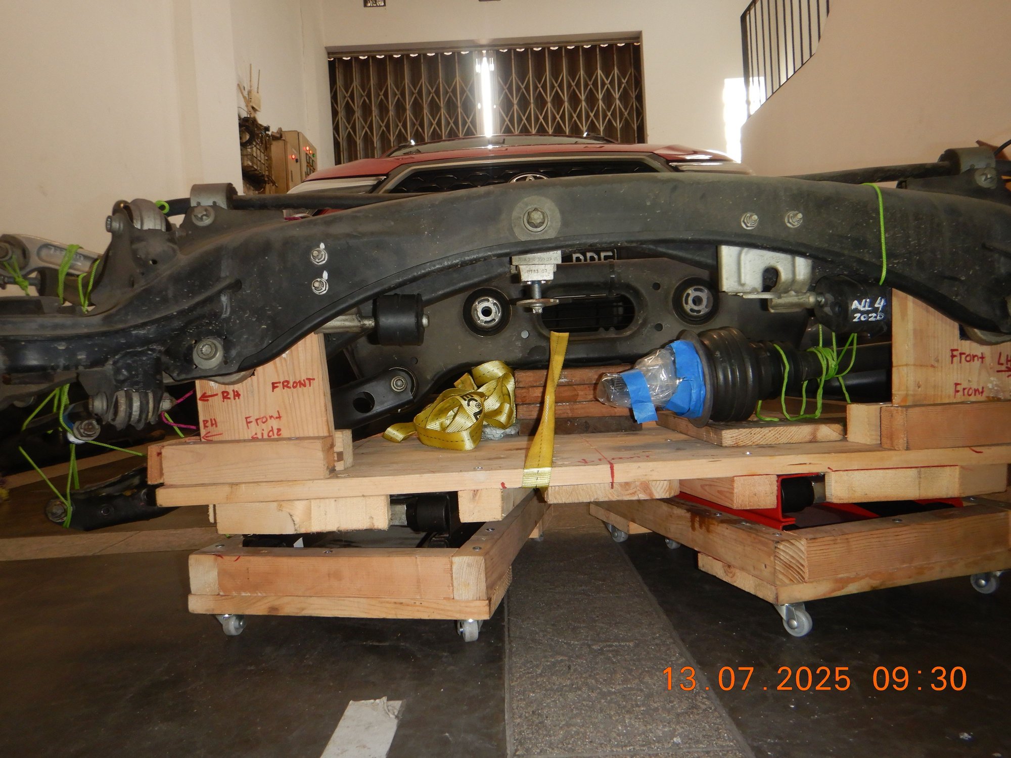

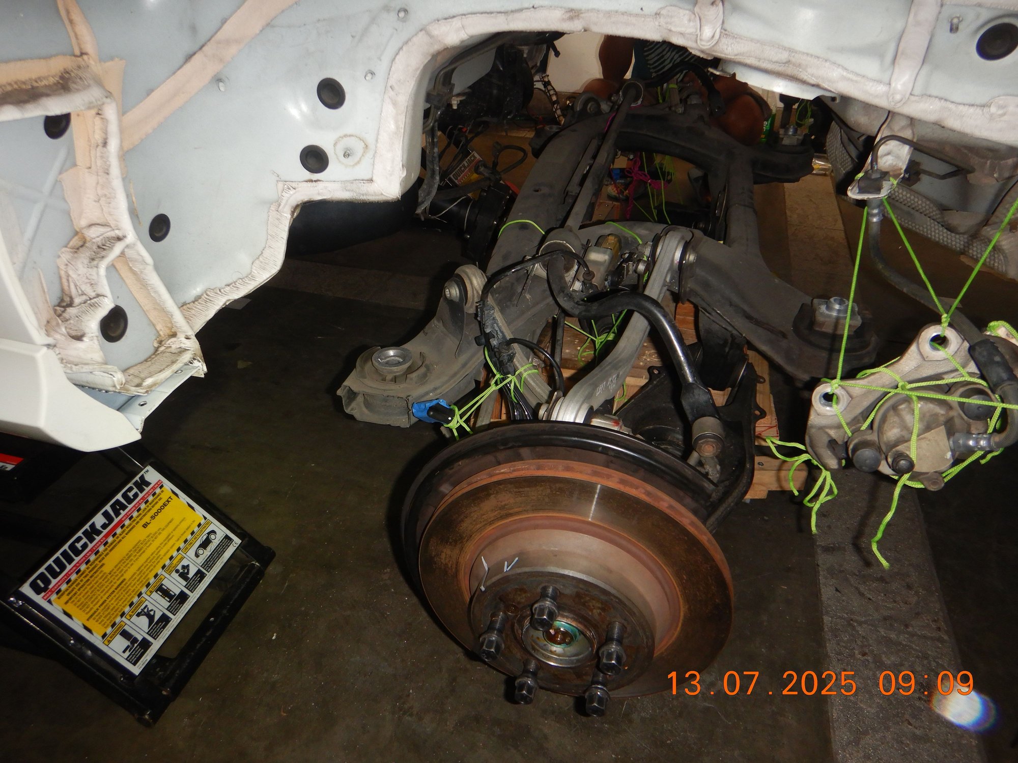

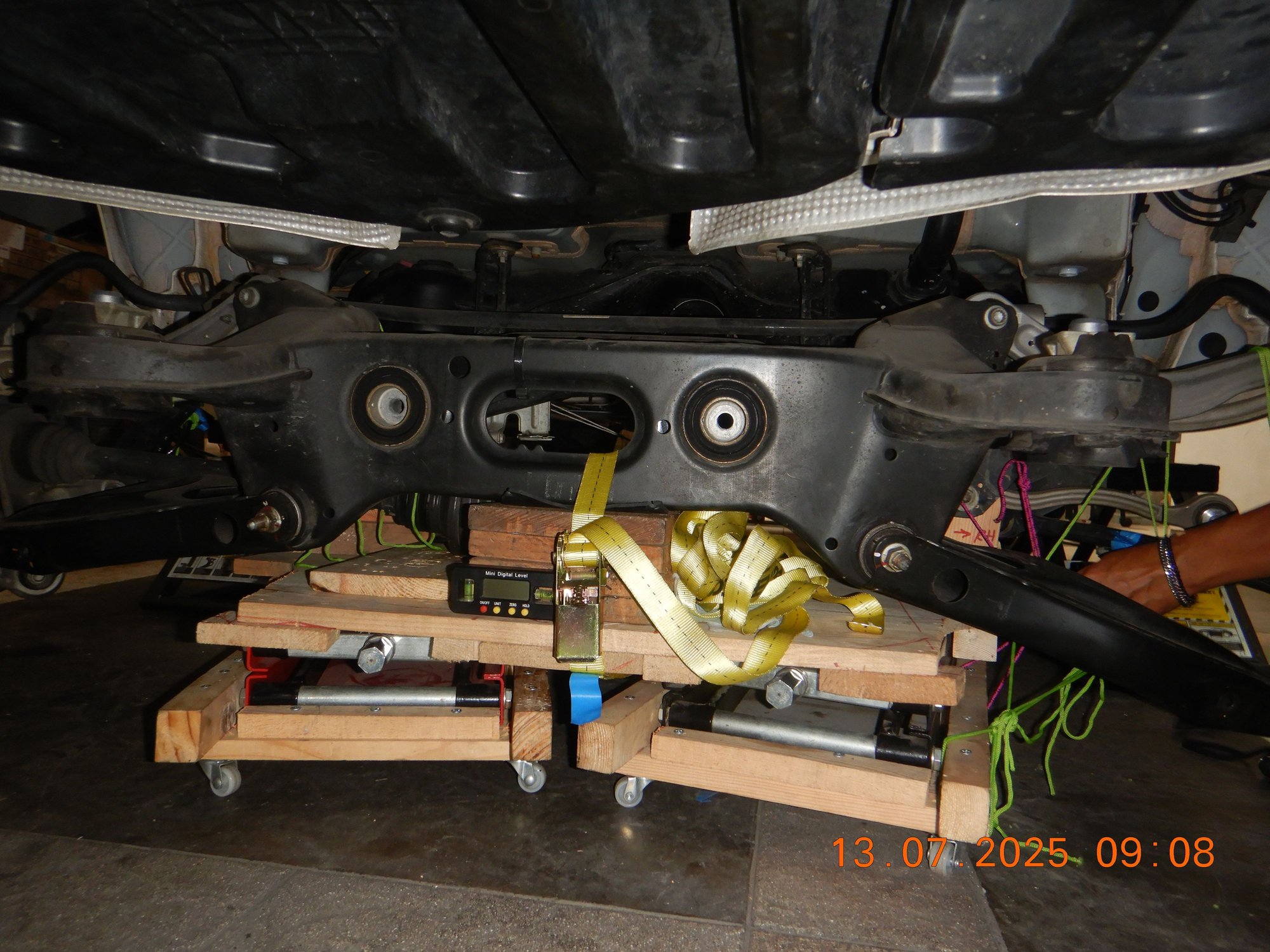

When I removed my subframe, shock absorbers get removed first. I only have 50cm Quick Jack maximum height.
The 1st photo I show you is not mine, that is from USA car.
2nd photo is mine, but subframe is not removed yet.
This is my subframe, removal process.
I even removed the DIFF first, while subframe still on the car. DIFF is heavy, easy 35kg.
I also replaced the DIFF busings (2) and DIFF mount (1), thus I need the DIFF to be removed anyway.
You will get all these new bushings with NEW subframe, must be :
4 subframe main bushings to car body. 2 front and 2 rear. (2025)
2 DIFF bushings ( 2025 )
2 spring arm bushings. ( done in 2023), no need subframe removed from the car.
Me, I replaced all these 8 bushings myself. That is why I need the subframe to come down, for 4 main bushings refresh.
