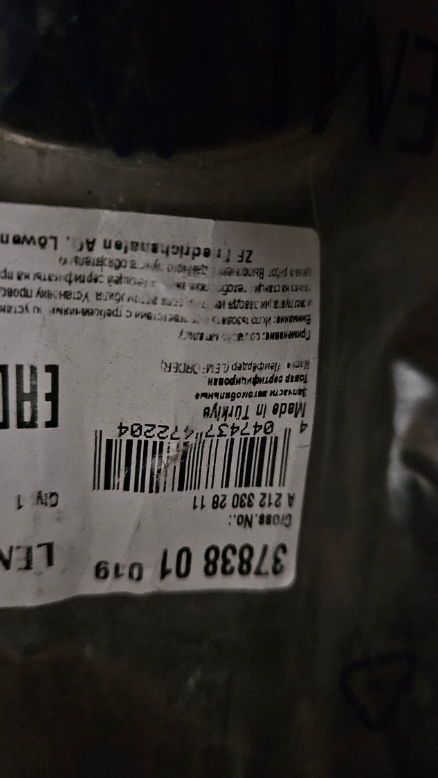

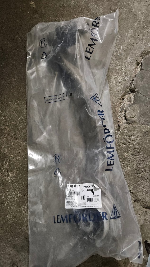

fwd arm
fwd arm : soft bushing + BJ
I used the Lemförder product.

fwd arm
fwd arm
I used that
Ahh, Pic res isn't high enough for me to read the label
In MB world the spare parts are best identified by VIN ie. my part# do not fit your car.
trim, year, options create different part mixes.
