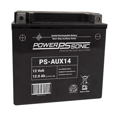

Sam's Club is out of stock on the Duracell ETX14, so I decided to desulfate the AUX battery while waiting for stock. After removing it and plugging it up to the battery charger, it instantly read "Float".... So, I assume the charge is not a problem?
The negative terminal and connector does show slight -- and I mean slight -- corrosion. So I scrubbed the post and connector with baking soda, and reinstalled the battery.
Next, I placed the main battery on the charger, and it showed the typical 25% charge for this battery not used for a week or more. I'll give it 2-3 hours charge until it reads FLO, then clear the error message and see where we go from there.

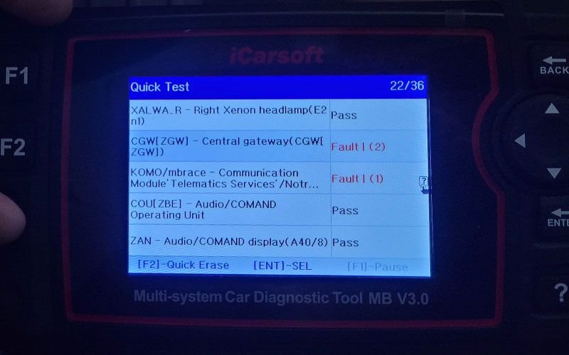

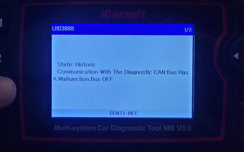

I have an iCarsoft V3 for Mercedes. The only errors I get are Gateway types...
I can clear them easily enough, but it doesn't seem to have any affect on the "AUX Battery Malfunction" message. So, I don't think this message throws any codes.

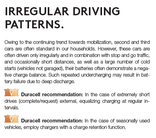

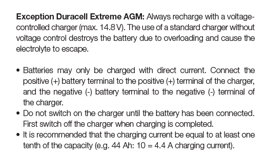

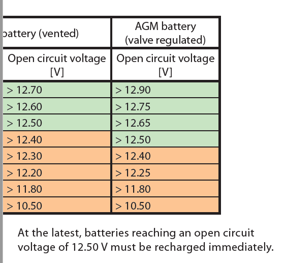

To complement @CaliBenzDriver , here is in my opinion a nice document from Duracell (I am not promoting their products) https://www.duracell-automotive.com/download/?file=230
Here are a few snapshots from it:

I am very curious on icarsoft method naming of modules :
Is this N93 Gateway at Front SAM or the other gateway inside the cabin, for model with certain options, it is called N93/3 or something... if I remember correctly.
Any time I do not see MB official modules name from non-Xentry scanner, I kinda worry if the mentioned modules has a few variants...like N93 vs N93/3.
DFWdude,
Why do you think the AUX Battery is the cause ?
