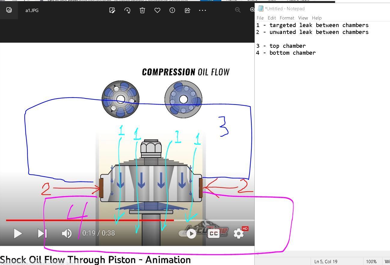

You need to see how dampers internal valving works and do not think a gas damper works because it is using gas pressure as damping medium.
Our damper is hydraulic based damping, the shims acting as "spring" , shims deflect/open like reed valve on 2 stroke engine at a known deflection and hence oil quantity flow.
It is all about oil transfer between 2 chambers, as the damping method and medium.
There is also a main piston o-ring or seal, which can also have a mild leak between chambers, but not to outside of the damper.
http://www.kybweb.com/en/shockabsorber/Structure.html
Don't imagine suspension dampers like a gas strut of our engine bay hood which is a 100% gas.
Imagine our dampers as two chambers for oil to migrate. The migration of oil between these 2 chambers are the damping effect it produces thru resistance of oil flow.
Controlled chamber to chamber leak would be a good way to call its operation.
I am not discussing nitrogen gas leak or oil leak to outside of the damper, but the internal valving leaking between chambers.
Over time these shims and piston main seal get tired and will leak more ( unwanted ) oil between the two chambers and that means damping force also drifts out of spec.

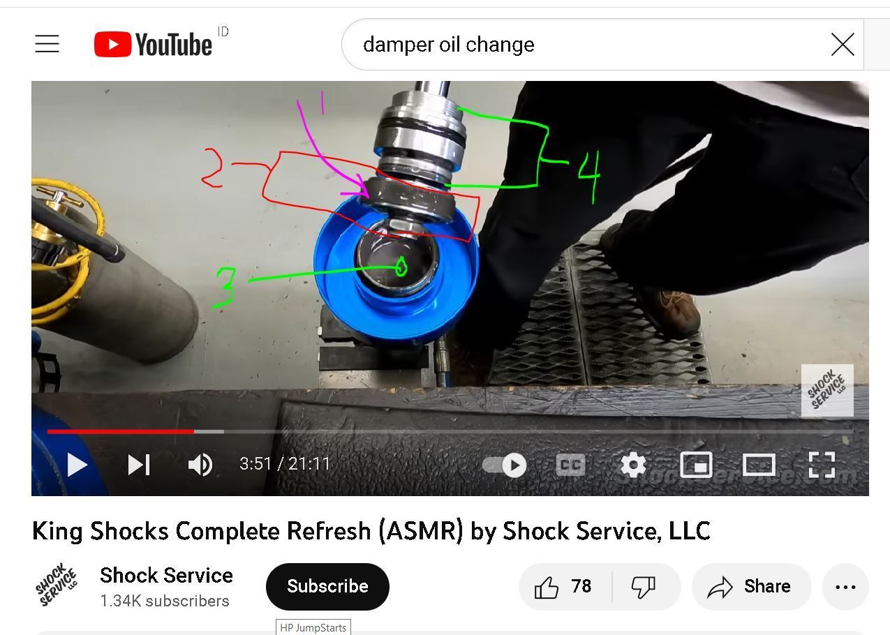

Some dampers can have the valve and seal kit rebuild and designed to be easy to tear down.
Wear and tear on internal valving of a damper is based on friction/movement cycle, so much millions times rubbing up/down or shims deflection and that is distance covered by the car and not bad roads per se.

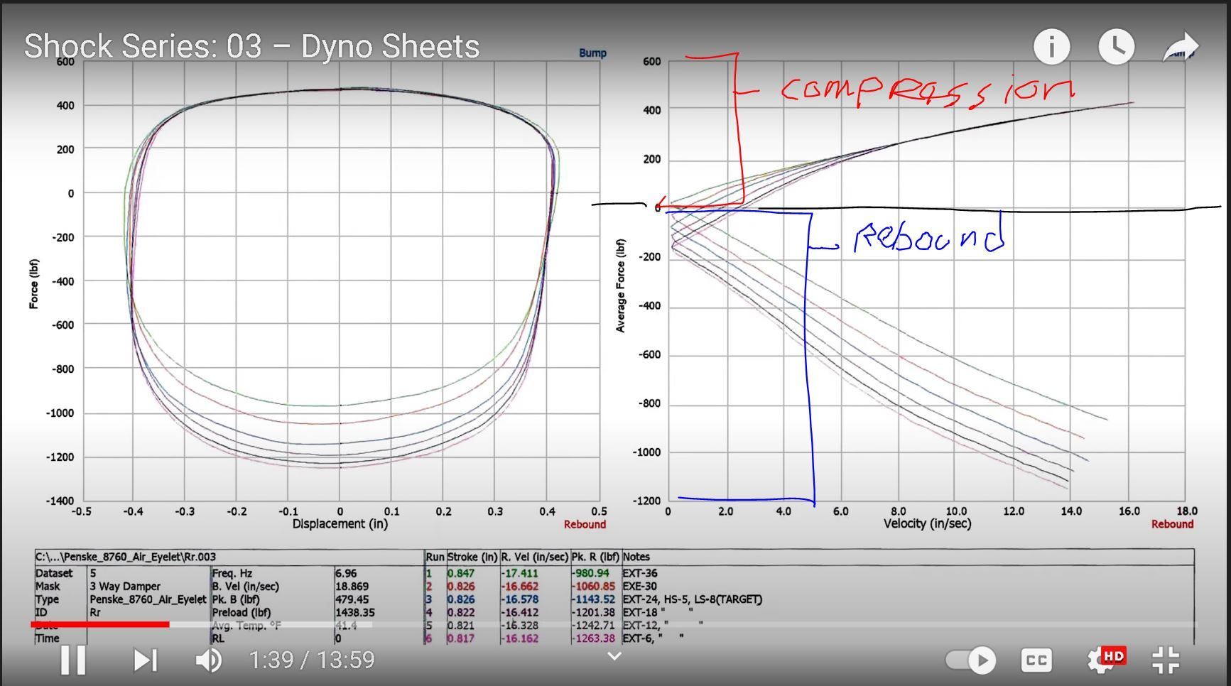

The only way to measure those internal valves "leak" behaviour is using damper dynometer, spring not measured, just the damper.
If one knows his car well enough, one can feel when the compression and rebound is no more as precise as it used to be or a bit more excessive piston travel,
that is them internal valves are leaking between chambers more than it should.

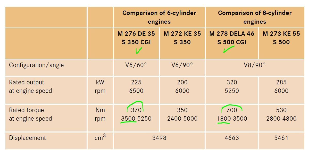

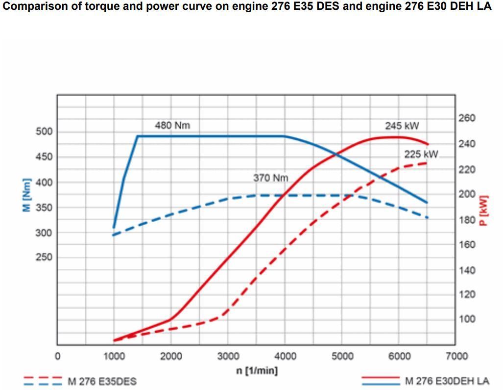

Your 3.5 NA engine has 370nm, but it develops that torque only at 3,500 RPM.
My 3.0 TT produce 480NM at merely 1,400 RPM and still has that much all the way to 4,000 RPM.
An M278 pumps out brutal 700Nm at 1,800 RPM to 3,500 RPM. This engine and its M157 & M177 more brutal brother will eat thru engine + tranny mounts like breakfast if driver is throttle happy.

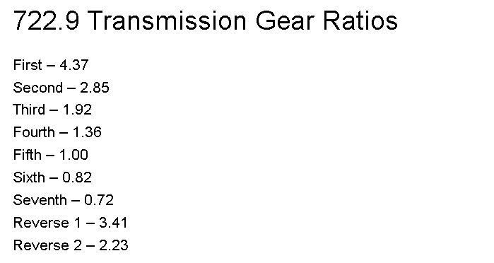

Use the gear ratio to multiply the torque.
So when I said your 100,000 miles car will feel much better with simply a new engine + tranny mounts and Bilstein B4 dampers, I am not kidding you.
