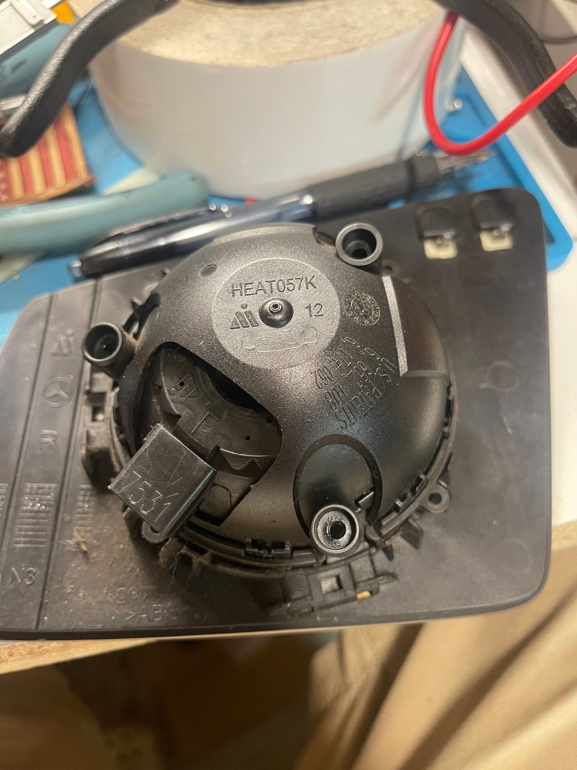

Side mirror maintenance
Housing for 2 motors
does anyone have instructions how to remove this cover on the side mirror motor , I need to lubricate the motor

This the backside with mirror attached
Old Jul 28, 2023 | 12:42 PM
CaliBenzDriver's Avatar
Joined: Apr 2019
Posts: 12,002
Likes: 6,827
From: Silicon Valley
W212 MY'14 M276-3.5NA @75kMi

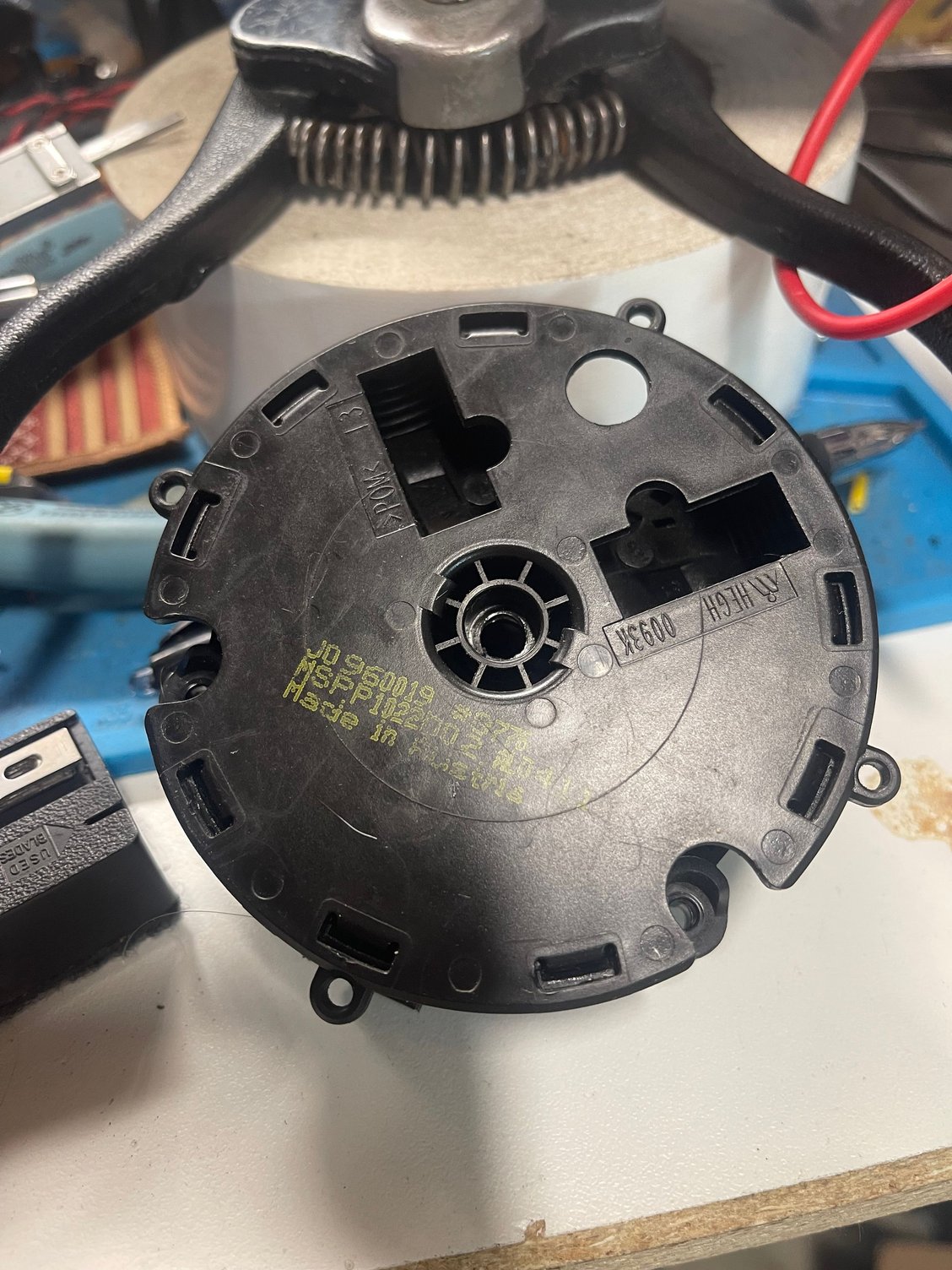

Mirror disassembly & more...
coming along...
plastic snaps
I see you have all screws removed, good 👍
now, gently loosen all snaps as indicated
As eluded to earlier what makes mirrors crazy is the solderless DCM controller. You can replace, recode or resolder...
THEME: many mechanical assemblies use light grease that evaporates. This results in unlubricated gearings ... rough movements stress the solderless connections until failure glitches the module crazy.
The failure stay local if the controller is not on CAN-BUS. Else if it is a node, then chaos is materialized as a delayed CAN traffic ("X-Mas airport traffic jam" @S-Prihadi )

how do you loosen the snaps , I am afraid of breaking them

plastics or electronics
these snaps are latches. Thing is they are all latching so one gets you nowhere with the one on the left + the right, all around.
Don't worry anout braking things up, you are being careful already beyond that epoxy is here to help.
If you don't feel like dealing with the plastics then go right ahead and fix the control electronics because that's where the main problem lays. Door Modules controls power to these mirrors directly.

Thank you for your replies , I opted and didn’t proceed to remove the latches but instead reached in a small opening and put in silicon grease and so far it worked perfectly the binding when the mirror changes position when I put it in reverse is gone
