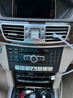

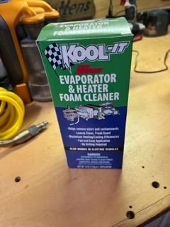

Thought I would share just how easy it is to fix your smelly hvac. Think the pictures speak for themselves. I have done this through the cabin air filter a few times as well. But this way also does it and also helps to clean out the main air channel too.
two tips - you’re going to insert the tube resistance free about 3/4th of the tube length. If you feel resistance, then you’re not into the air channel and try again (it’s towards the middle of the two vents. Second - MAKE SURE you have the setting set to just the main cabin vents. That way the passege way is open to the coil.
Takes maybe 5 mintues to do this. Works every single time for many many months, leaves a fresh and clean minty smell for the entire car thst lasts a very long time. For me, I won’t have to do this again until next summer.

I can assure you my way works. The evidence will be sitting on the ground afterwards. But drying it out before shutting the car off is certainly a way as well. Unfortunately, I either don’t remember to do that as I approach my destination, or not in a situation where that would be ideal (have people in the car with me), or simply not an option (turning on heat at full blast to dry out the evaporator when it’s 90+ outside, no thanks).
The root of the problem for all cars is the evap coil gets wet from the ac process, and it sits in a pitch black small container. Perhaps it’s damp bot because of the ac, but rather just a humid / rainy week. Once the moisture gets in there, the closck starts for mold and mildew to form. Especially on the fins and sides of the box. Only way to truly eliminate it is with a disinfectant chemical to kill the mold and mildew.

I’ve been happy with it, no complaints, but I’m sure the others are pretty good too. My point was just to show an easier way to get to the evap and its box if you don’t want to go the route of pulling out the air filter under the glove box. The can instructions actually recommend go up the drain under the car, which I’m not able to do at home.
