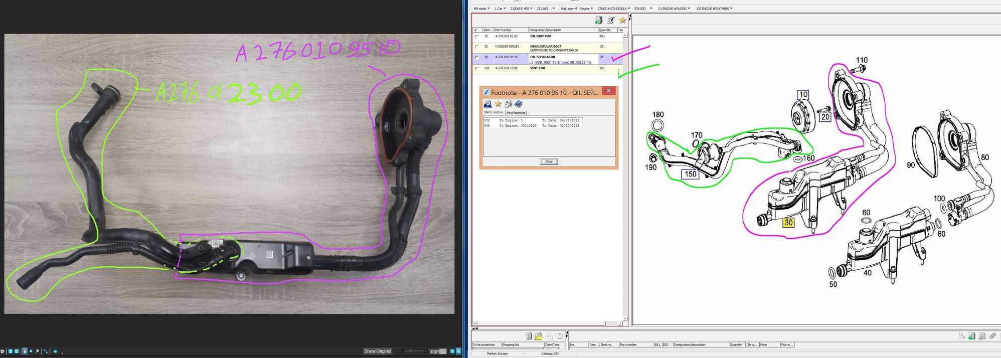

Yes, that is the 2nd oil vapor separator you speak of of 3.0 Turbo M276. I will replace mine next year, on its 10th Bday.
Pay attention to item #150
I will replace basically all the plastics and rubber hoses at engine bay.
I see ur engine code in ur signature is M276 3.0 Turbo
Once in a while you need to test this check valve, part of item #150
Mine has a tiny tiny reverse leak at higher pressure.
You must buy hose assy #150 to get that check valve, it is not sold single piece.
