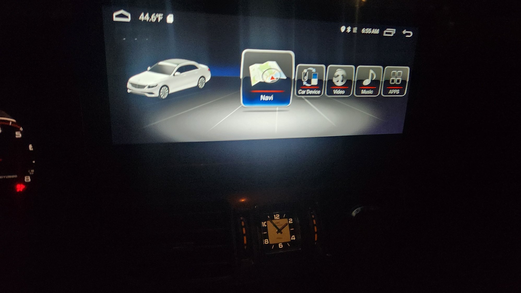

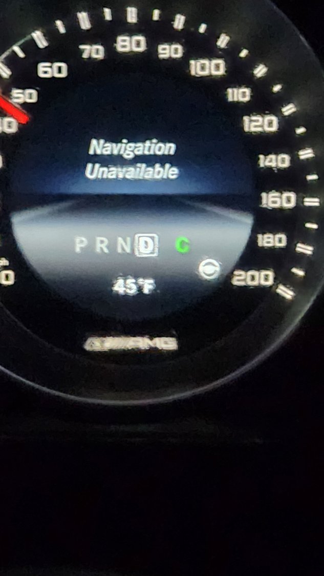

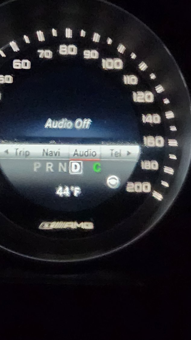

Thanks for the info. Here's a couple picture of what I get on the dash.
Nothing I press or do changes either of those screens...All of the labels on the screen itself are in a different language, but I'll see what I can find. Here's a picture of the screen, if anyone has a wiring diagram for this one please let me know.
