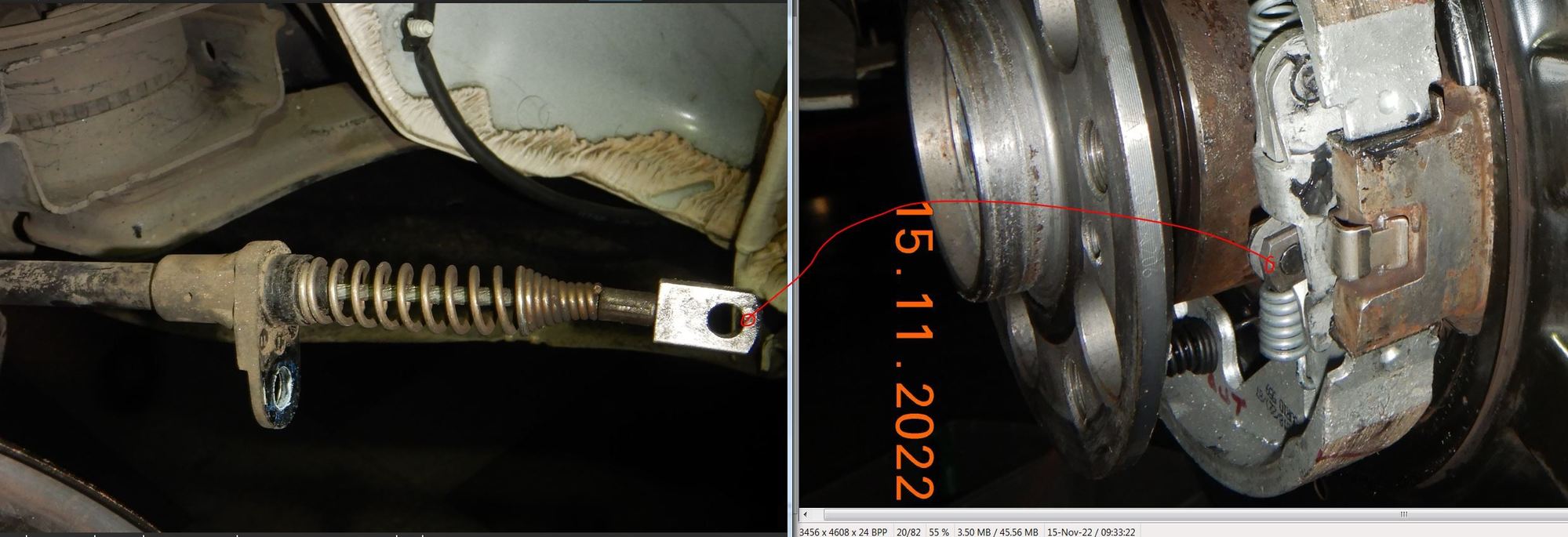

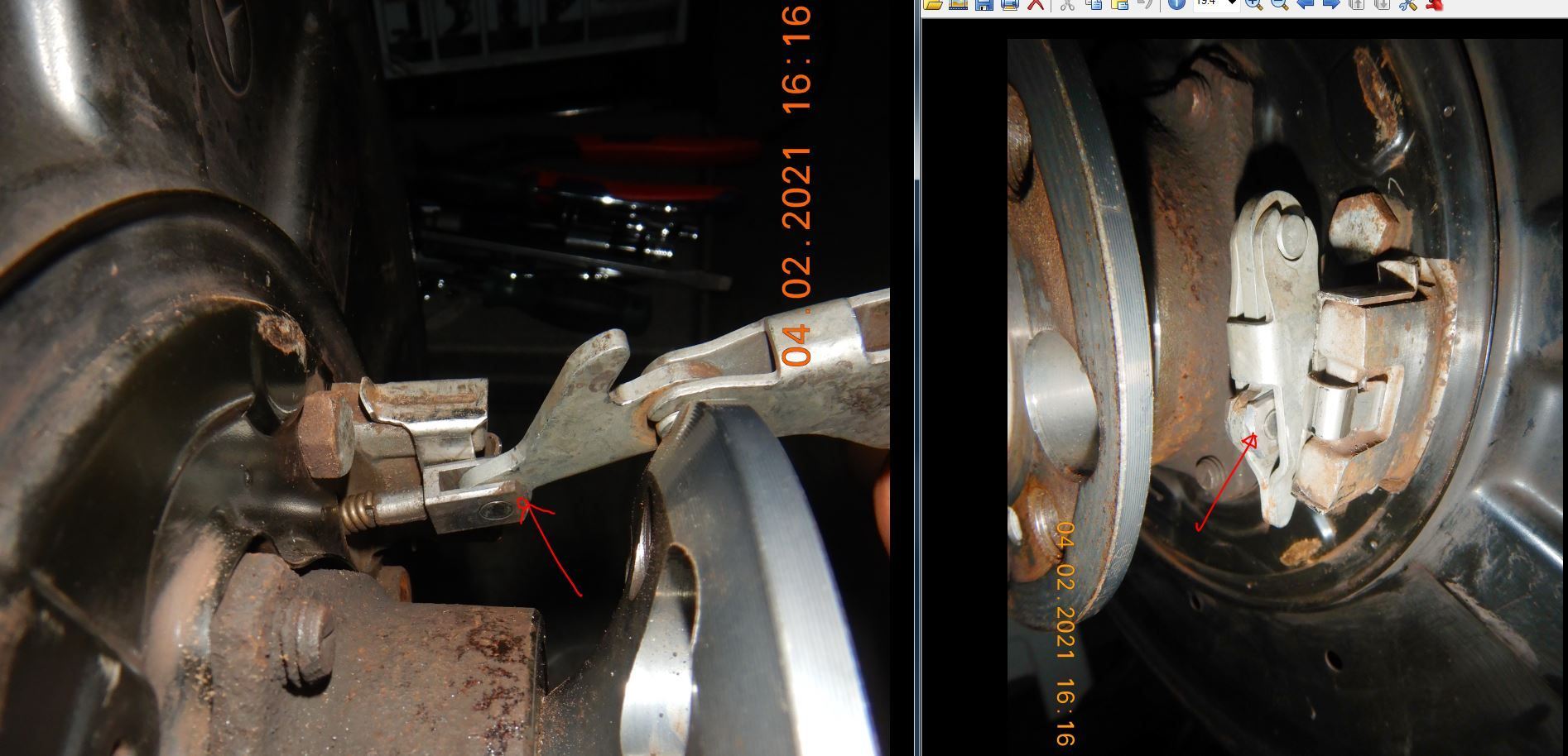

I can show you at the parking brake side internal drum brake, how the PULL CABLE may stretch.
I have lots of photo on it.
When the parking brake is not depressed at all, the PUSH CABLE pops out this much at the rear inner drum brake.
ADD
Geez, every year I visited my parking brake shoe & mechanism ....LOL

Thanks for the pics and effort, but it's not the pull cable, it's the release cable that is the issue. I pull the handle and maybe 1 out of 8 times the handle is at max pull and the brake isn't fully released. Wait, as I type this it just dawned on me, could it be the sensor that turns off the dash light that needs adjusting? Hmmm, I gotta think about that the next time it hangs up and see if the brake actually did release fully, and it's just whatever switch that isn't turning off the dash light. Where is this sucker and is it threaded/adjustable at all ...anyone?
Sorry if this is nebulous as I am thinking on the fly here and this just dawned on me. It's an intermittent problem so it's not like I can reproduce the malady. Thoughts welcome on the switch?

So you are a 100% sure that mechanically you are seeing that the PUSH PEDAL did not go back to zero position......
or..... you rely on the warning light to confirm that PUSH PEDAL did not go zero/relase-ded position ?
The switch can come off a few millimeters out of its seating and create a bogus BRAKE LIGHT activation when actually the PUSH PEDAL has totally gone back to zero position.
It happened to me once.
Note my car is a RHD, so you visualize it mirror yah, on a LHD car.
The 2 locking latch you inspect, does it sit well.
