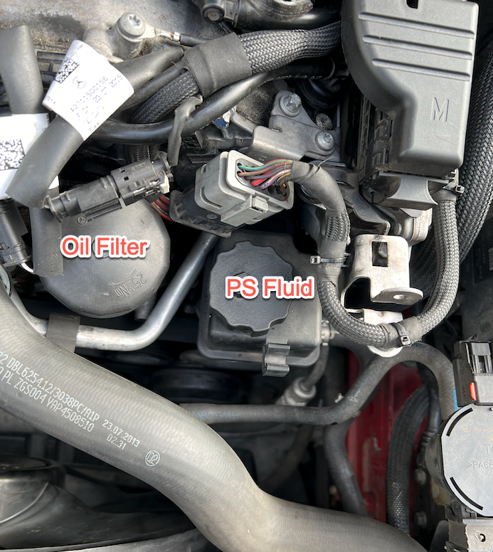

My 2014 C350 is I think hybrid electric-hydraulic (or maybe just hydraulic). The reservoir is next to the oil filter.
So MY'14 features a mix of power steering:
  • E350 has electric power steering rack
  • C350 has hydraulic power steering rack
