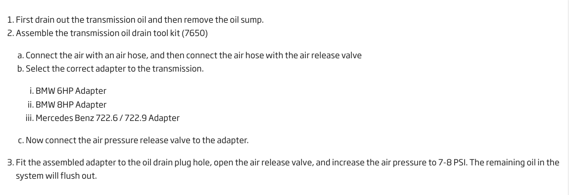

I'd have to go read the instructions, but from my understanding, you use very low pressure to move the fluid from the torque converter. As I said, I have the kit but haven't used it yet.

Here are the instructions:
