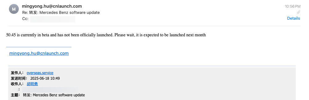

Apparently, LAUNCH Benz version 50.45 has not been released yet.

I was thinking about that too, hence why I thought they joined the beta program, maybe asking for it through the email auto enrolls them to a beta program? At least we know the beta version fixed a few things and didn't break something.

Hmm, that must be why he asked for the serial number on my device. He was likely able to push it out to me directly but made no mention of it being a beta!
