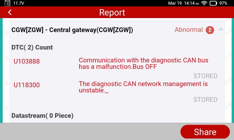

Here is the one module where I have STORED codes... I put the car on a battery tender before running this diagnostic.
Can I clear these by disconnecting the battery for 20 minutes, or what?

GHOST CODES... LIVE SOURCE
Your answer is YES
These faults will clear temporarily.
Exact same pair will come back... "not fixed"
I used to have these exact same two faults regularly.
The common mind share had me thinking this was caused by disconnecting the scanner. Nope!
I dont think so anymore because now the pair is gone.
This condition is a genuine "tip of the Iceberg".
These two faults showing up mean CGW got swamped with disrupted data flow.
I don't EXACTLY know why but have clues...
This quit bugging me when I switched scanner from AUTEL to MS. cReader - I thought: great this works better. It was just a scamner bug like the ghost LIN 70b1 temp sensor.
Now I guess not, you have it on LAUNCH SCAN.
Then I'll conclude it was my CAN-C ISM causing this latency jam that disturbs CGW.
There are too many un-terminated connections pilled up across the gateway that have not expired - That's what rebooting car helps with. It took me over 10 years to understand this bug.
When CGW is upset, ESP is too. I think its the broken ESP traffic that fills up CGW queues.
ie. hance REBOOT EVERY 2 WEEKS. Simply disconnect GND at the strut tower and AUX GND too.
A reliable CAN-C HELPS ECU timings.... here:
Have you noticed fish-bites misfire when scanning engine ON, yes? Can-C HAS PROVEN Impacts ECU TIMINGS
+++ clearing CODE is like clearing RAIN +++
Resetting codes is like windshield wipers during the rain: it's great but does not stop the source.
