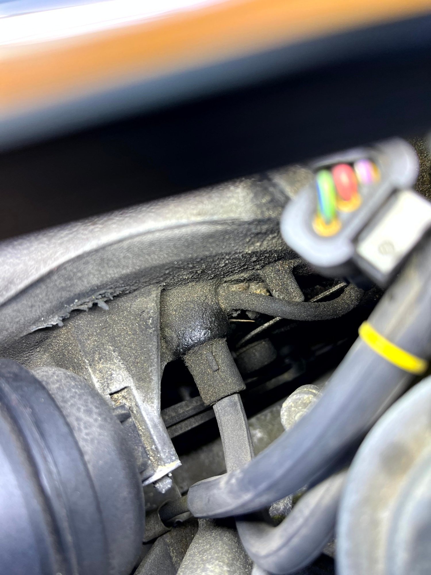

-Took photos of PCV Breather before touching, after wipedown, photos of old and new PCV, and final installed replacement

Microphone location for the below video
<iframe width="560" height="315" src="https://www.youtube.com/embed/J-vJVFYzn-U?si=KWrnPRRIACAVt0nW" title="YouTube video player" frameborder="0" allow="accelerometer; autoplay; clipboard-write; encrypted-media; gyroscope; picture-in-picture; web-share" referrerpolicy="strict-origin-when-cross-origin" allowfullscreen></iframe>
https://youtu.be/J-vJVFYzn-U?si=mkLRvuqoCYtBfyoP

Originally Posted by mgiara
I will try to get an answer on this!
Note: the engine has a consistent stutter now when idling. Roughly every 3 seconds, RPM will dip very slightly. So slight that the change cannot be seen in the tachometer, but heard and felt if sitting still with quiet surroundings.
One arm appears to be intact, the other I can see about 25% of it. That 25% is intact.
I've attached a video of a "gurgling" sound coming from the driver's side of the engine. The gurgle is followed by a slight dip in RPM's.
The sound comes from this circled area.
