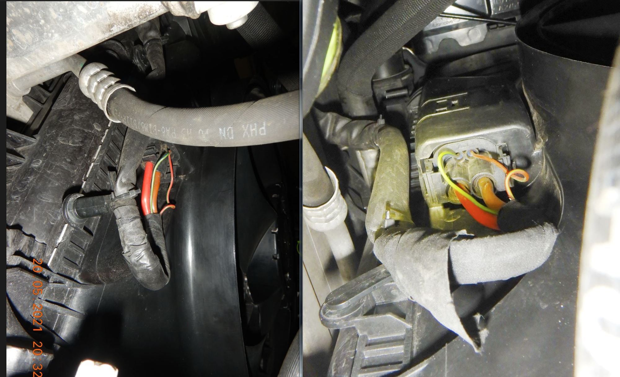

Is you fan connector and wires set like mine below ?
