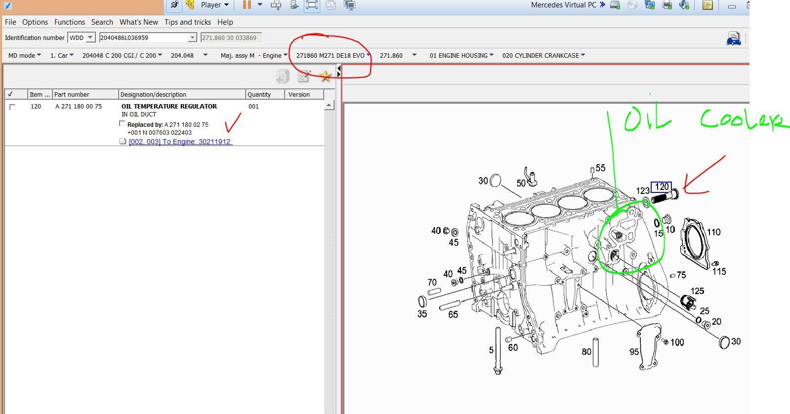

12V electric pump is for aftercooler ( charged air cooler ) coolant only and stand alone cooling system with its own radiator and coolant reservoir.
The turbos coolant is tagging along main engine coolant system and engine oil system.
I am still waiting for the 1 of engine oil spray nozzle I ordered, have not arrived yet.
I want to test how many PSI does it actually open, it has some sort of ball + spring inside it.
For the time being piston underside oil spray and its relation to engine oil temperature and coolant temperature needs more testing/investigation.
The engine oil cooler gets what I call early coolant flow, the not so hot one.
The coolant sensor by position gets the hot coolant which has done its work and on the way back to mechanical coolant pump suction side.
So engine oil in theory would not be as hot as coolant, as coolant is cooling the engine hot oil or we can say that the coolant is being heated up by hot engine oil.
I am used to oil cooler being air cooled ( older engine ) or seawater cooled if for my marine diesel, but never yet like now, cooled by a coolant already hot from engine combustion.
I understand MB also wants the oil to warm up faster too, more so in cold countries.
My last test showed that if the thermostat open maximum, and radiator fan speed is high enough the coolant into engine block after being cooled by radiator
while car is stationary, I seen a cool 64C from coolant of 98C coolant temp . If car is moving 40MPH or faster, it will be cooler I am sure but my test rig is not designed to be used for moving car.
Unlike M271.8 engine, which actually has oil temperature thermostat ( regulator ),
I think our M276 generally will have cooler engine oil temperature because there is no such thermostat.
What I am saying is, hotter oil temperature on my M276.8 might not mean only that the piston oil spray is doing its job well, not as simple as that.
For my turbocharged engine, it is even more confusing, the aggressive driving will result in more often higher turbo boost occurring and the oil will be heated up more too.
Its been bugging me this question because I really want to know, how much of the extra heat to the oil is actually from piston oil spray alone.
