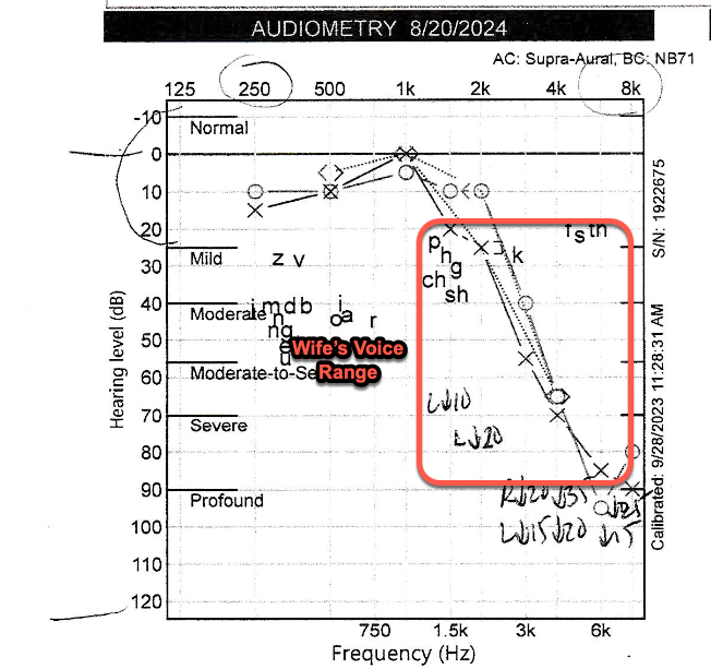

My problem! My latest hearing test results.
Just kidding! Please keep this between us.
Back in the late 90s, I had a similar hearing test. Once done, I was asked why I was there, my results were normal for a man in his late 30's. I answered, "Apparently I am not hearing well, " and the audiologist replied: "you are married, correct?". I started laughing. My ex was not happy when I mentioned it to her.
