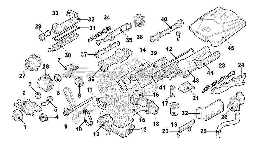

I do see a shaft in there looks like a balance shaft. What part number is the Secondary chain tensioner?
The above diagram appears to be a M273 V8...
8Cyl NA 1X extra Long timing chain
8Cyl. NA
single extra long timing chain (#10: oil pp chain)
M276/8 chains look like this:
4x chains setup
4x chains setup
One primary timing chain to intermediate shaft then two secondary chains to twin DOHC (+ oil pp chain)
