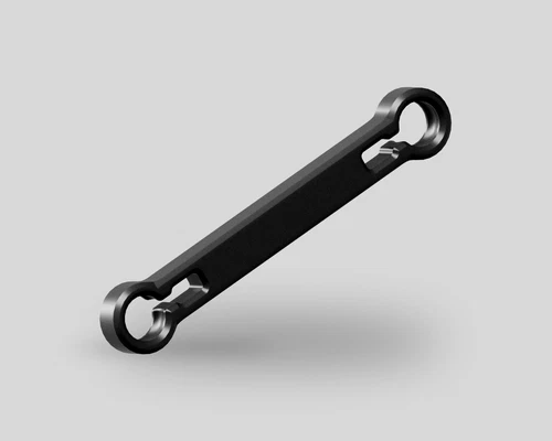

Ride Height Sensor Links - Anyone Tried These?
Mine are broken, and these look like they will work, anyone tried them? Someone plastic printed these and they are available on Ebay.

the plastic link brakes because the steel ball joint rusted surface is rough and grabbby.
Perhaps sanding the ball surface smooth plus a new linkage will go another 50kMi...

I replaced them with metal joints as shown in the picture. Connect two of them with a threaded bar.

It took 3 weeks to get these from Europe, but they look good, I will put them on tomorrow.

Great idea, if these don't work out then I will follow your idea.

Grease them with white lithium too. Clean them up every 2 years. I am still on the original almost 13 year old ones.

I installed them, quick and mostly painless. Fit perfectly and at $12 a piece they were a bargain. Entire job took 20 minutes.

Factory ones were plastic, so my guess is at least 10 years.
