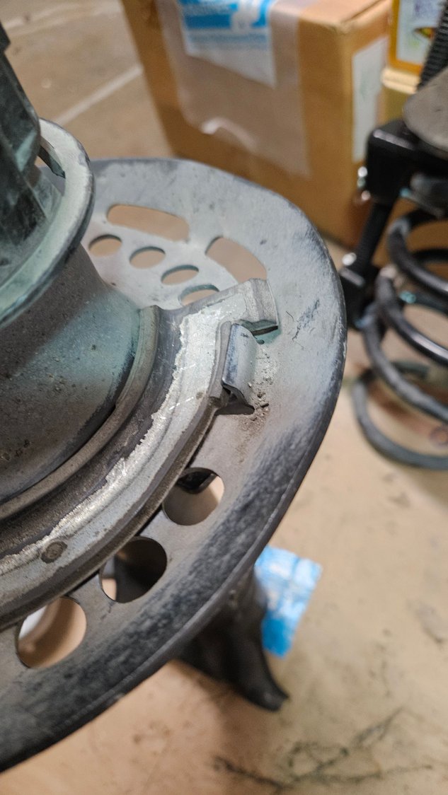

Something missing here?
I provided my shim 20 to my mechanic when he replaced the front and rear shocks and springs.
If this was applied, shouldnt i be able to see the bottom shim on this image?

yes, correct. It does look like your parts count got simplified.
If you get "spring noise" going over bumps as springs compress then replacing the missing shim is the solution.
Your strut... no shim showing
My strut... with shim installed
If the noise is driving you crazy... try to simply apply grease around spring base or repeat installation to correct.
