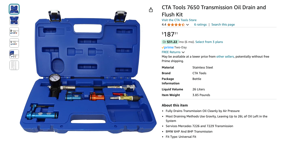

The WIS procedure does not call for draining the entire system, i.e., the transmission cooler. The procedures for a fluid and filter change only includes draining from the transmission oil pan and torque converter if it has a drain plug. Otherwise, draining is sufficient. The service cycle for the newer blue fluid (ATF-134FE, MB 236.15) varies a little from year to year, but for my car and year it is 77,500 miles or 5 years. My car was 8 years old with only 43k miles when I discovered there was also a time interval recommended. The service was done by the dealership with parts I provided and no comment was made about the color or age of the fluid. Some people want to do a complete flush of the cooler as well by removing the oil feed and return lines, but a normal service does not include flushing. Unfortunately, the WIS does not state when and why to flush, only how. And with all the warnings about possible dirt/debris contamination when disconnecting the feed lines, I would be reluctant to do so unless there was an indication that it was needed.
Oxidation is caused by heat. Apparently, if the fluid never exceeds 170°F, the fluid should last 100k miles. At 190°F, about half that. However, my normal operating temperature of my transmission fluid is 180°F, so the 77,500 interval is safe.
@georgiuzunov should be fine with the intervals given without doing a complete flush. Though I have not used it, there is an adapter from CTA Manufacturing that uses low air pressure from an air compressor to force out all the fluid. It has fairly good ratings and is also offered by FCP Euro, whom I trust.

OP ..."should be fine with the intervals given without doing a complete flush.", but it's not fine...
OXidation came from long contact with the Oxygen
Of course if you drain the TC is not necessary to clean the radiator of there is no complaints....
I would not use air pressure inside the transmission, as inside is everything about.... pressure, pistons, brakes, valves, etc.
I agree, ideally, removal of all fluid is preferred, but not practical or necessary as long as there is no existing internal damage. Since there was minimal material on the magnets and no performance issues prior to changing the fluid, there is no indication of internal damage.
WRT flushing with air, it is done at lower pressure (~7 psi), which is probably less than the pressure used when Mercedes does a fluid flush. The CTA tool has been around for a long time. If there were problems, they would have shown up by now. The tool is also demonstrated on Legit Street Cars YouTube channel, beginning around the 23 minutes position.
