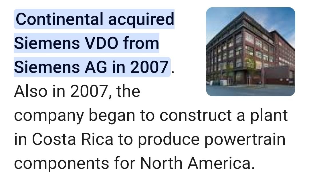

CONTI
Is oem the latter?
It's the "same difference"....
mega mergers
early mega mergers
Conti owns Siemens 👏

I actually did not know that, good to know. So both of the TCM is built identically?

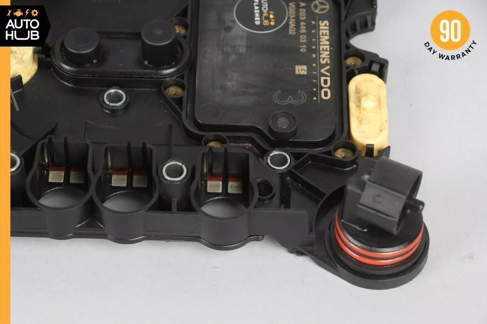

It may be quite late for this info, but incase a future reader comes along curious...
If memory serves, Siemens makes the VGS1 & 2 Conductor plates, while Continental makes VGS3. I also understand there are compatibility issues between valve bodies originally paired with VGS1 (& also 2?) conductor plates. There were cases of new conductor plates being needed, only Conti VGS3 units available, said units were NOT compatible/could not be successfully programmed & coded to the cars in need & the only remedy was the purchase of a new conductor plate AND valve body as an assembly.
I'm going through a mild Hell w/ TCM issues which is looking to be a GND fault w/ the TCM's chassis ground, however my electrical connector is also leaking & still cannot confirm/deny that a new conductor is the only remedy to sort this on a 722.9. Don't you wish you had a 722.6 instead?
I know I do. Or better yet, a 718? (The 6 spd manual).

ATF came pouring out! There is also of course a seal here. Likely not sold separately as far as I know
Aforementioned o-rings located here. Also likely not sold separately?

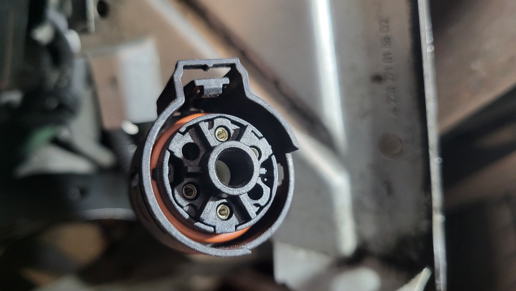

How can this be?!
So upon inspection of the connector the other day, I was shocked to find a completely clean & dry connector on both male & female ends!
Roughly 3-4 wks after initial finding of leak
Hard to get a clear pic of, but confirmed clean/dry with mirror
Regardless of this nice find, I do still have low voltage instability remaining and a possibility of conductor plate failure, or at the very least, selection range sensor failure. Both I still doubt given the fact that once these errors are triggered, the car continues to drive flawlessly.
