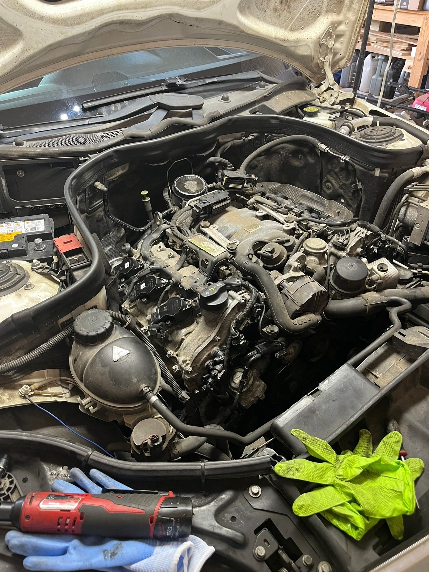

Starting my intake manifold replacement. Wish me luck guys!
So i've got the infamous DTC 0521 / P2004 "The charge movement flap (cylinder bank 1) has a malfunction" along with multiple misfires, rough idling, poor acceleration... Got a Pierburg shipping from FCP. Time to open her up. Hope i don't screw up.. Anything else I should do while I'm at it? Tips??

I noticed you disconnected and removed the complete ecu from the top of the manifold. Some of the videos I watched on YT detailing the repair procedure, especially the one from FCP Euro, had just the passenger side disconnected while the driver side remained connected and the ecu resting near the firewall out of the way. I believe MB also recommends it being done this way as well.
This is the one I'm following. He mentioned in the comments that he removed the ECU many times on this repair with no issues. I did disconnect the battery before I disconnected the ECU if they even matters but we'll see once I have everything put back together.

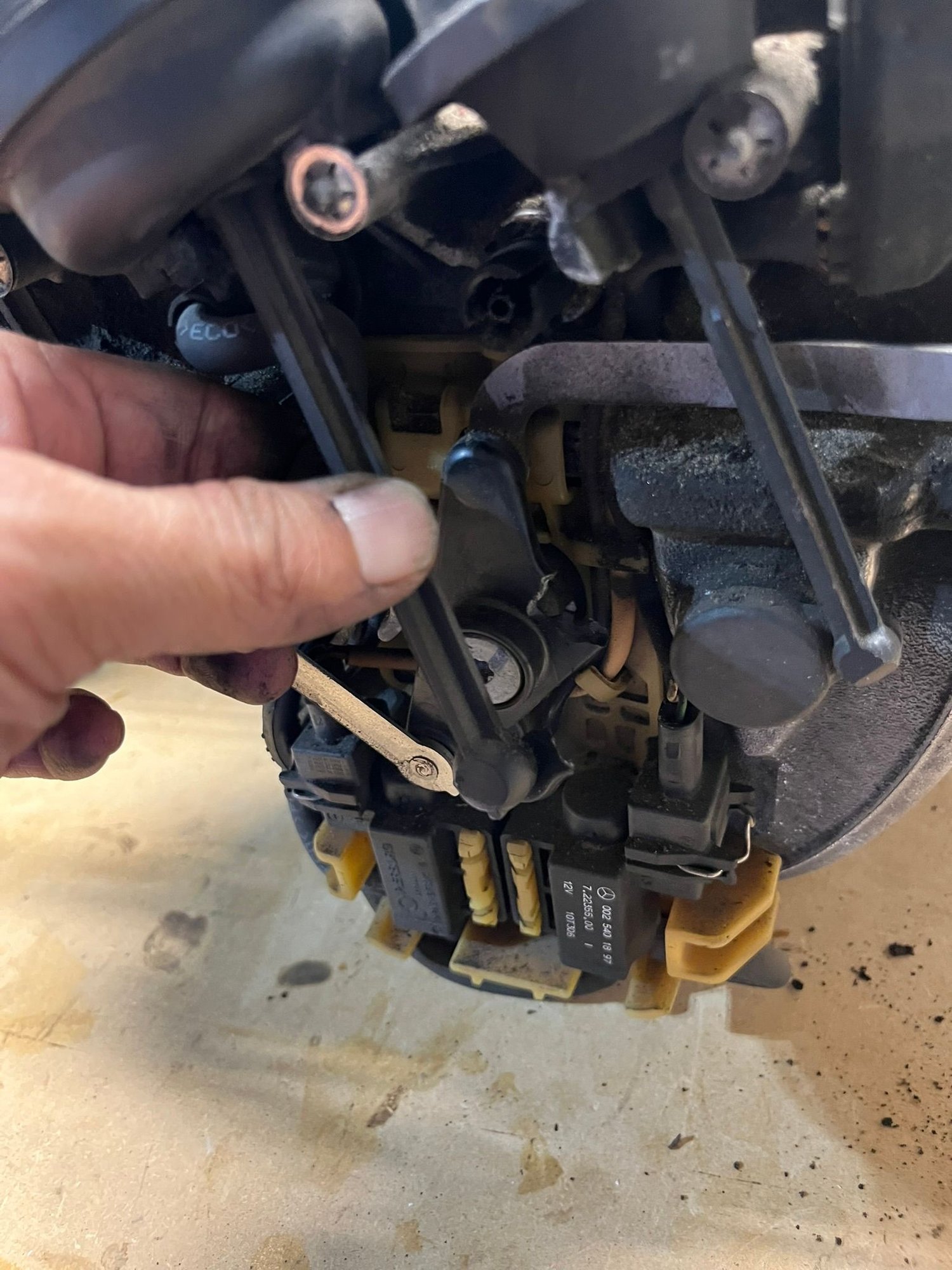

This confirms it. one of the levers are broken.
