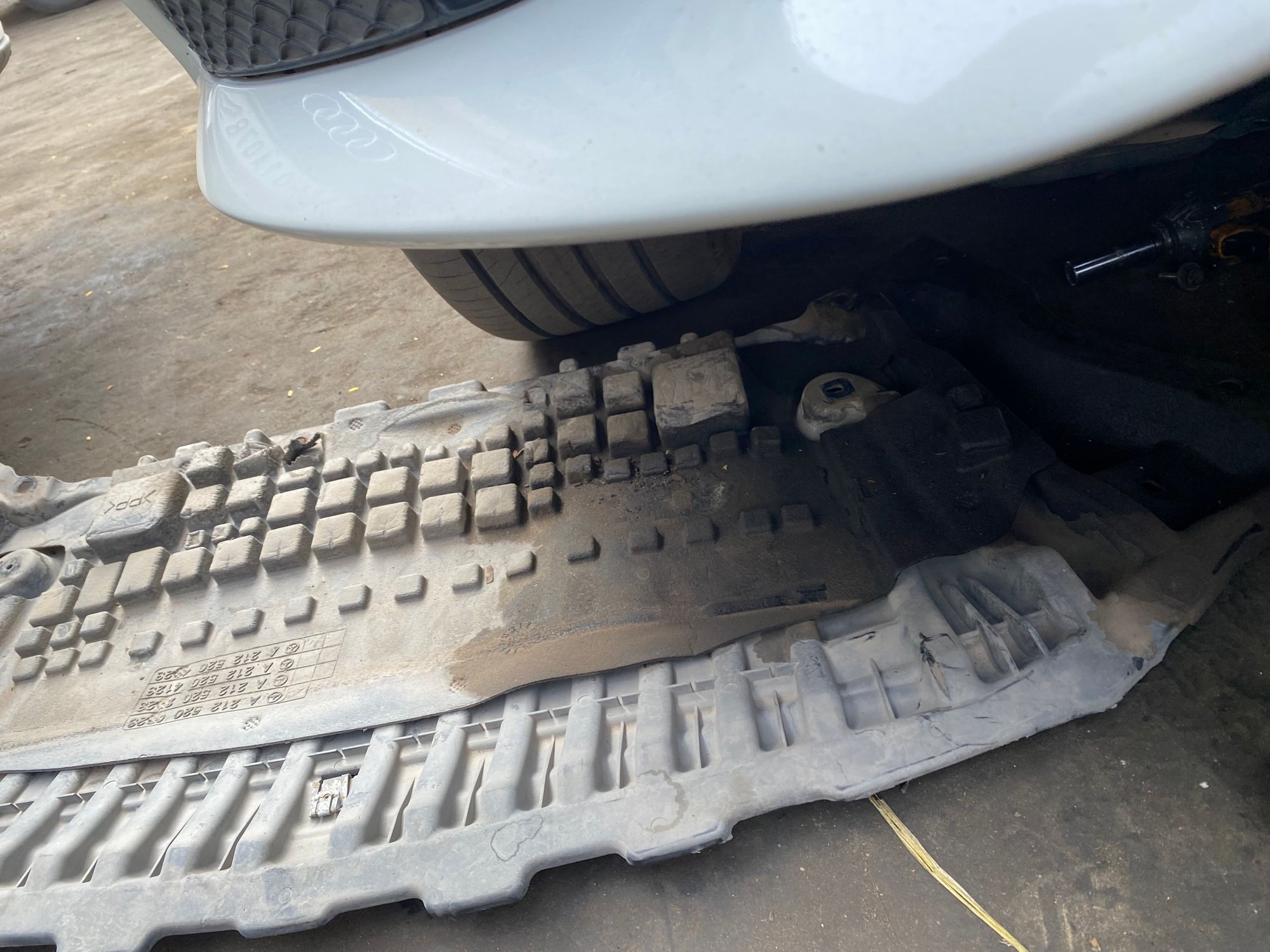

I went to my mechanic and according to him upon opening up the bottom cover shields he found that Intercooler Hose pipe was the culprit and was causing the leak and he replaced it with a new one. But when he showed me the old hose pipe there were no cuts or damage and I asked him the same he said that it’s the seals that sometimes leaks and gets weak due to age (Car age is 10 years old). Is he right?
I don’t know whether the issue is fixed or not as whole night the oil didn’t drained. Currently it’s not dripping

Those hoses provide a flexible connection between the moving, vibrating powerplant and its stationary support components. If some of the variables were calculated, one could surmise this particular hose "flexed" over a concentrated area. Further, materials used in the manufacturing process make up several layers depending on a given application. If any layer fails, pressure will simply move between them and build up until this fluid (or gas) reaches a layer without a resistance to this pressure. If a hose is wet anyplace along its length, it has probably failed.

But how come the hose leaked this much of oil on undertray. Does the hose have this much of oil which is present on the underbody cover.

That really doesn`t look like a big leak and it looks kinda old, probably a small leak over the time so that may not make a noticeable difference on the oil level, if its fixed nothing to worry about, I`d keep an eye on it next few days and if nothing happens just enjoy the ride.
