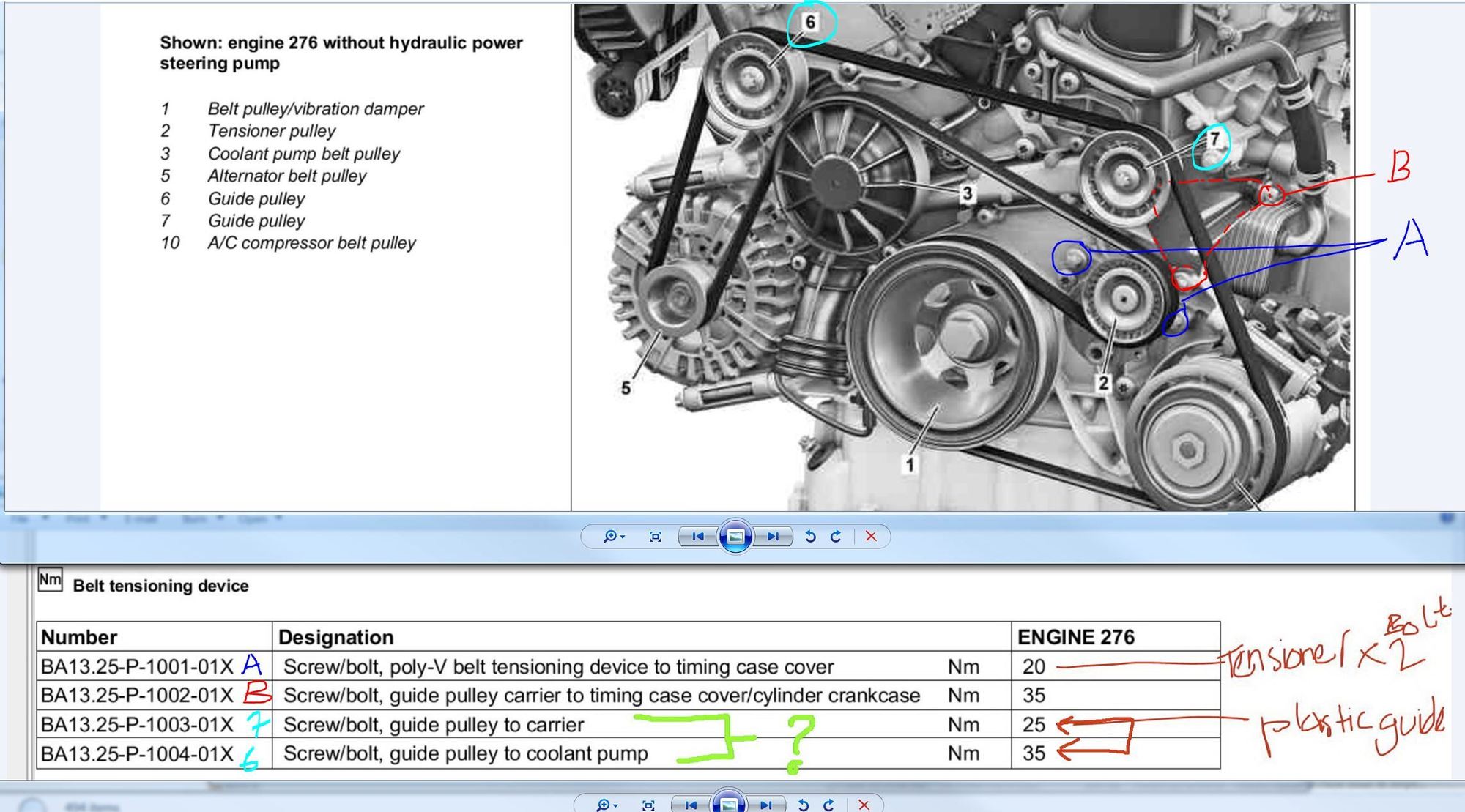

yep aftercooler must be removed to access the serpentine belt for removal , otherwise you can't loop the belt to the water pump pulley and main pulley
If you are in there, best to replace the 2 plastic pulleys and the tensioner.
I already did mine and I am only at 36,000KM or so at that time.
