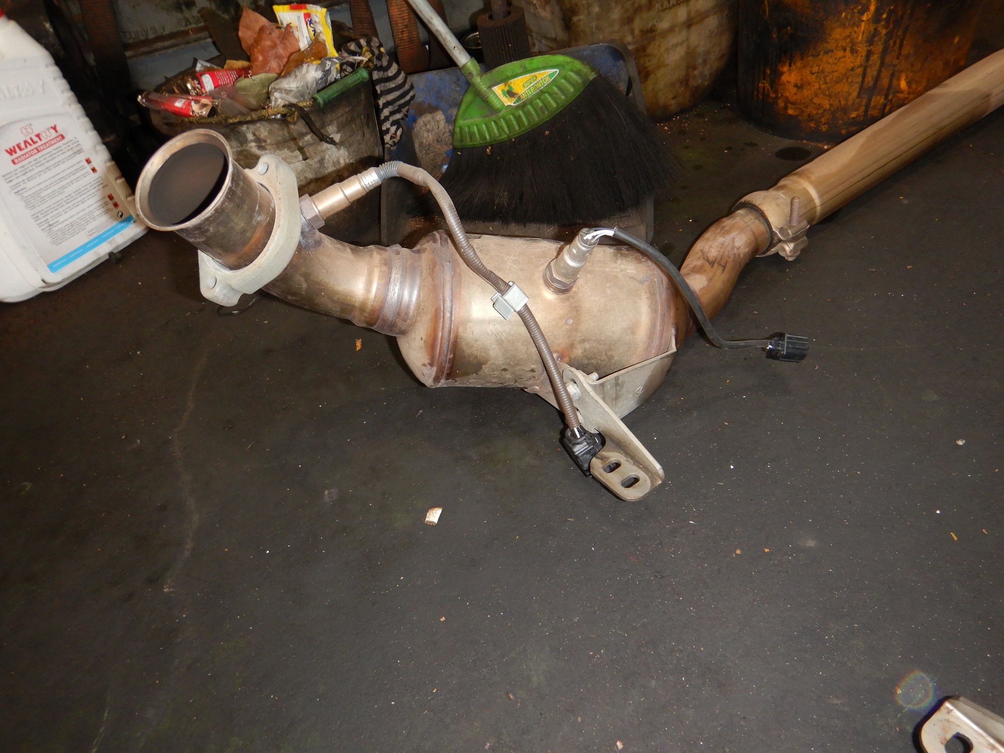

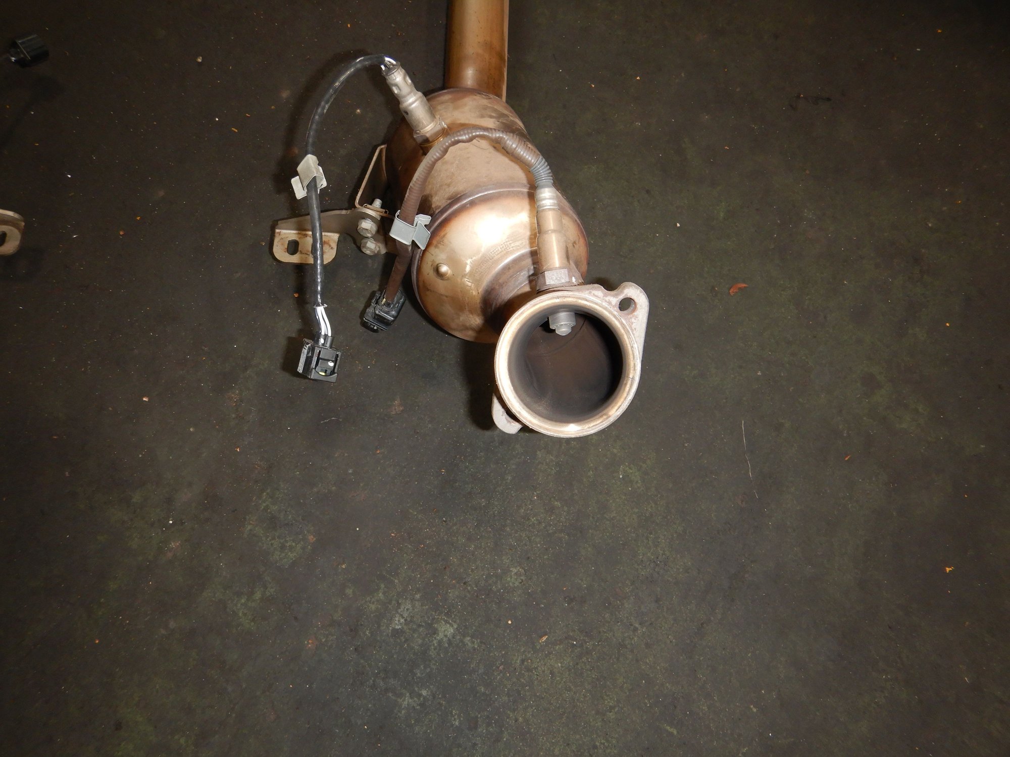

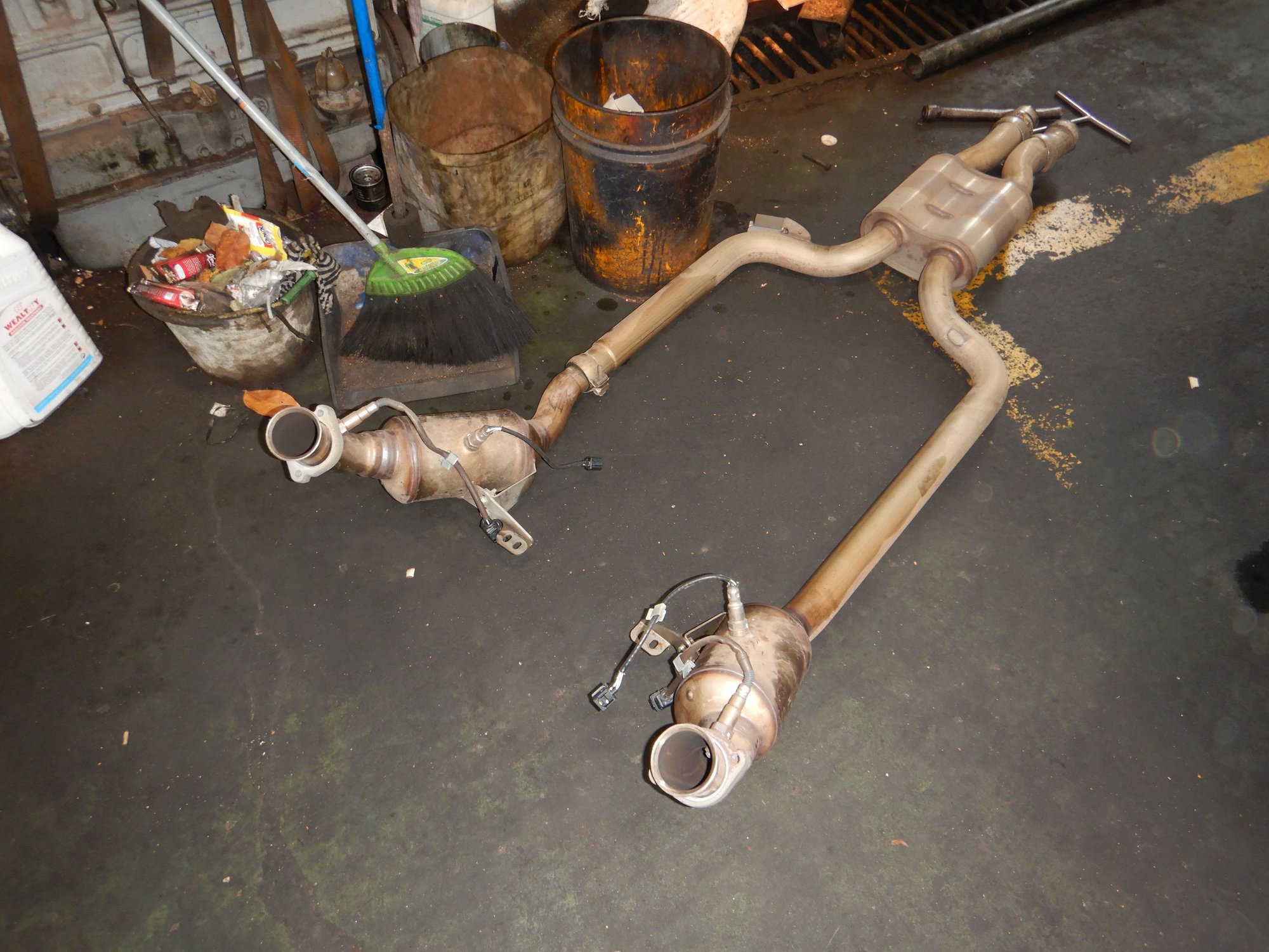

Based on mine E400 W212.065 M276.820 , it is 2 core.
Engine---->>>Core 1 and the rear or 2nd 02 sensor hole in the empty middle and then core 2
Boroscope into the CAT 02 sensor hole. See two cores.
I cant remember which photo below is front or rear core, sorry.
2018 archive for below:

Many, many, many thanks, Prihadi for your photos! They are extremely useful to me!
That confirms that you have the same exhaust setup as mine, with that stupid distribution of left catalytic converter plus middle muffer in a single piece, while the right one can be separated. Why??? stupid design.
I have found a company here that can repair mine for around 550 euro, I don't know if they are fully aware that there are two cores inside, I will make sure to avoid surprises.
Why did you disassemble your exhaust and examine your catalytic converters inside? Did you have similar issues with them?

Indeed, I have always wonder WTF was the engineering thinking when they/him decided to do that ? Why why why ?
It is extra leak point if only one side, if both sides at least I have greater flexibility when removing exhaust system.
Must be some real good "weed" beside the drawing board of the engineer.

Well, I took the car to a Catalytic converter expert. I already had a quotation by phone to repair it there, but when I took the car there to make sure, the guy was honest and he said that the sympthoms didn't match his experience: a loose converter core doesn't fix by itself when hot, it continues rattling. Also, a loose core lets some air passing around it without restriction, so it is impossible that the car would pass MOT gas inspection, as it did. He recommended NOT to replace or repair the catalytic converters without further inspection.
He lifted the car and punched the cats a bit (hot, that's true), and he couldn't notice any signs of looseness. So he suggested me to leave the car there one day, let it sit overnight on the elevator and check the noise again when cold, and even remove the middle O2 sensor to put a camera inside and check the condition of the cores. What we DID see was an exhast leak back at one of the joints from the center muffler to the rear section (one of the rings was black all around). So that's the first thing to correct.
On one side, I am relieved that I don't need to exchange or repair the cats, but now, I don't know again where the raspy sound comes from when cold...
