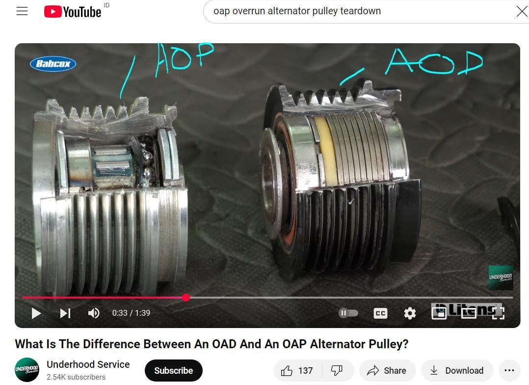

Who here has GOOD experience with Overunning alternator Pulley OAP and OAD ?
Gents,
Need help here pleasse.....

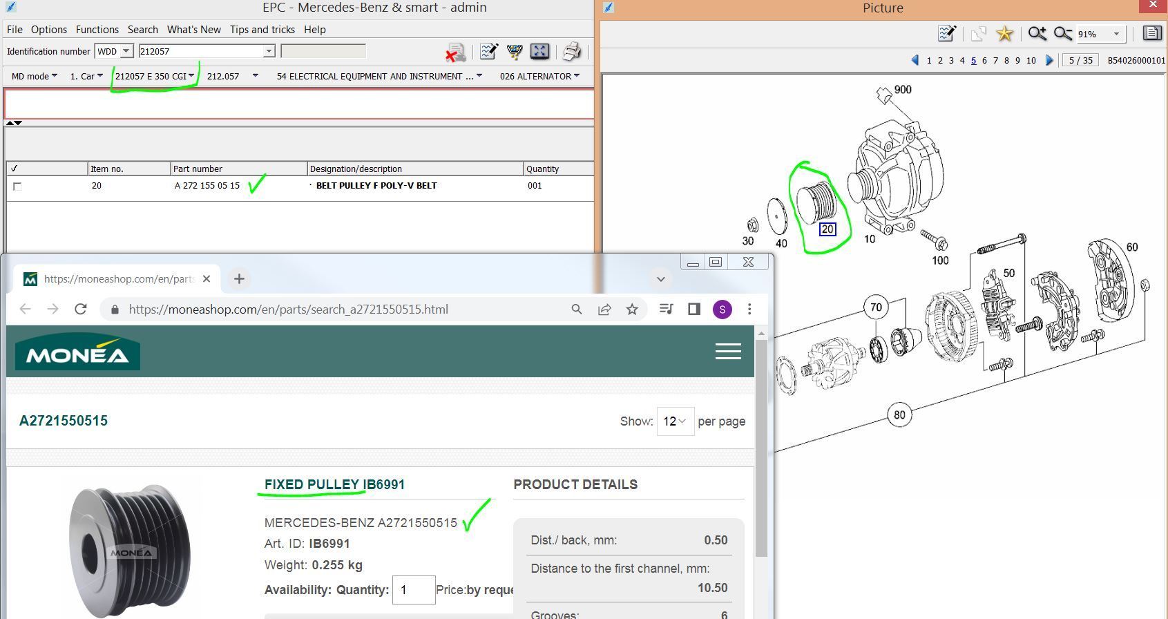

My M278.8 3.0 Turbo and M276.9 3.5 NA and M278 got the oldie usual fix pulley. No fancy overrunning capability
A2721550515 for both M276.9 and .8 and the M278
Mine, M276.8. Fixed pulley.

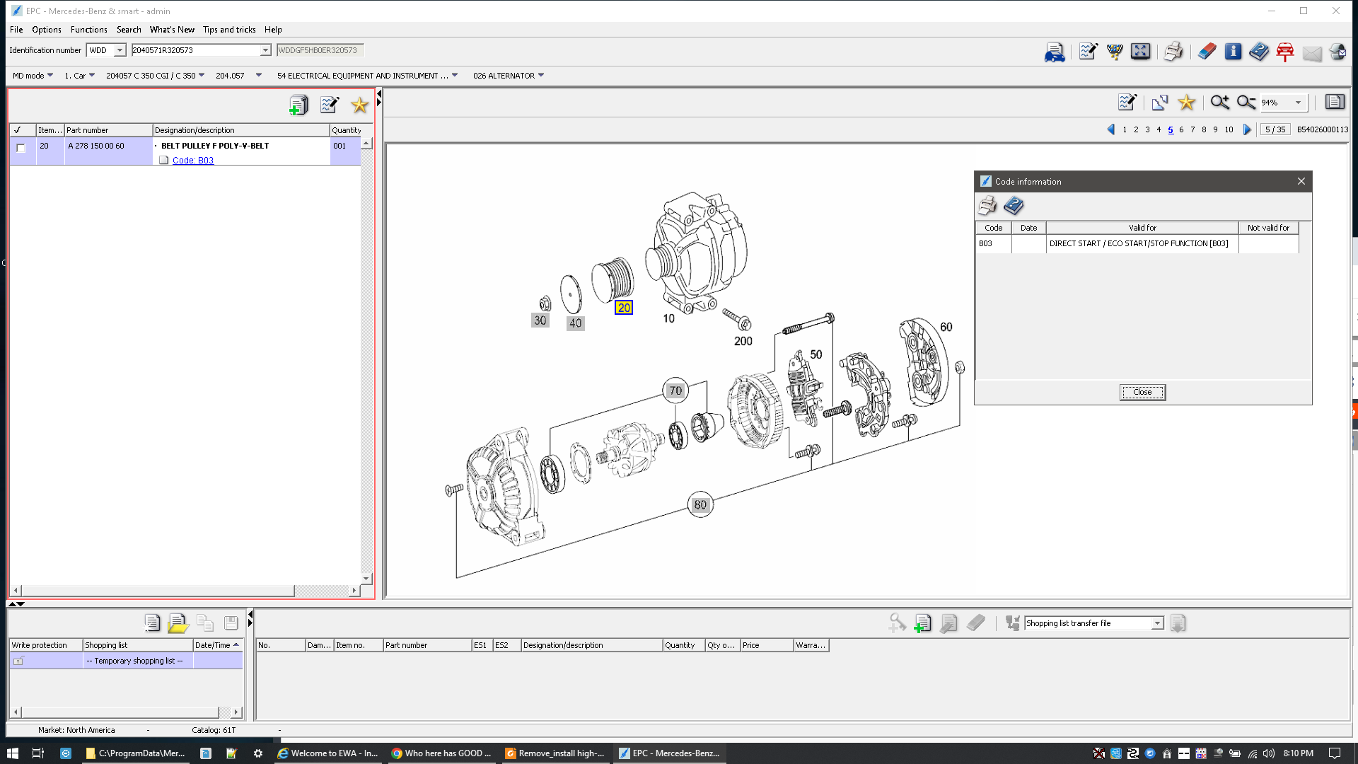

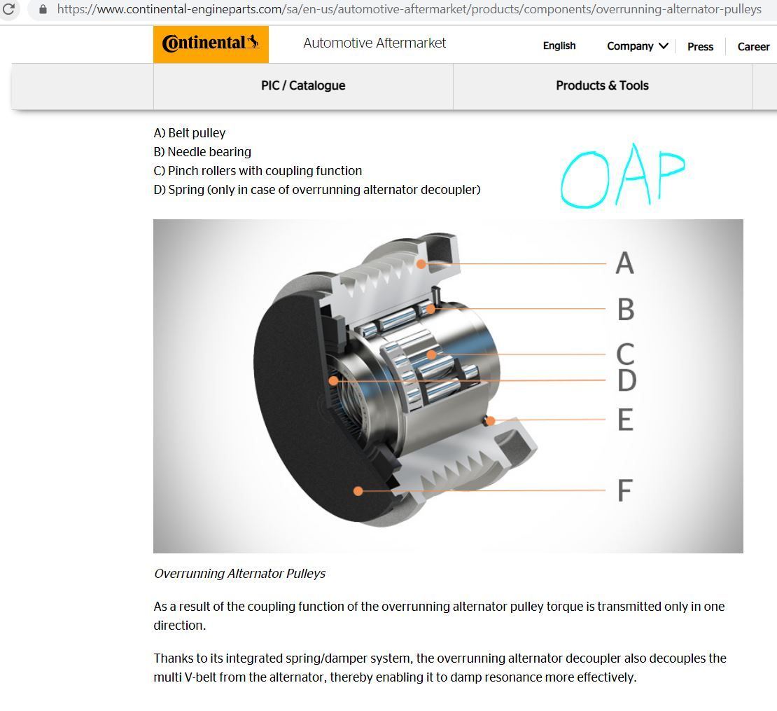

M271.8 E200/C200 W212/W204 gets what I think is the Overrunning Alternator Pulley OAP
M271.8 below photo, uses A278 150 00 60 , same as E63 W212
Other W212 engines using the same A278 150 00 60 AOP pulley. M157 engine is among them.
Note : I never knew there is such a thing as E260
I am asking this question :
Have anyone seen a fault on this AOP pulley , where it will only work at certain minimum speed/RPM ?
Like a slippery /slipping manual tranny clutch due to wading in deep water and then finally full engagement when the clutch is dry enough.
Many Thanks

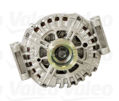

Actually I am trying to figure out if my friend's M271.8 C200 W204 with AOP overrunning pulley,
could it be that his AOP pulley is not 100% healthy at lower RPM or an AOP pulley has unique first time engagement requirement as in a bit faster RPM than idle ?
Remember I told you that during during WARM start where RPM is as low as it can get 650-700 RPM, the throttle blip to approx 1,000 RPM-Engine is needed to get the alternator to start charging.
Once alternator start charging, keeping low idle 650 RPM is not an issue. Thus now I am thinking of the AOP pulley.
M271.8 gets Valeo 150A, I checked.
If say his AOP pulley is not 100% healthy or has unique first time engagement requirement....and needed that 1,000RPM-engine to start AOP full engagement,
this then is a possible answer as to why the 1,000 RPM-engine throttle blip is needed during WARM START.
Otherwise how and why could this alternator keep charging at low idle RPM ?

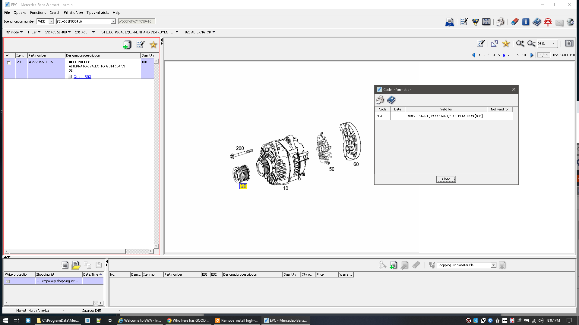

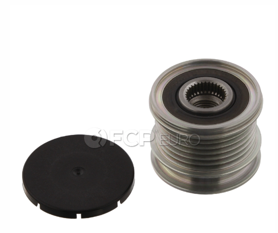

Interesting. My 2015 SL400 with the M276.8xx engine has a solid pulley, while my 2014 C350 with the M276.9xx engine has what appears to be an OAP pulley based on the style of the cover.
SL400 Alternator (M276.8xx)
C350 Alternator Pulley (M276.9xx)
Old Mar 2, 2025 | 08:11 PM
JettaRed's Avatar
Veteran: Army
iTrader: (1)
Joined: Nov 2016
Posts: 7,847
Likes: 3,495
From: Maryland
My SL400 (M276.825) and C350 (M276.957).

There are quite a few different models that get that pulley.
https://www.fcpeuro.com/products/mer...-33473#fitment

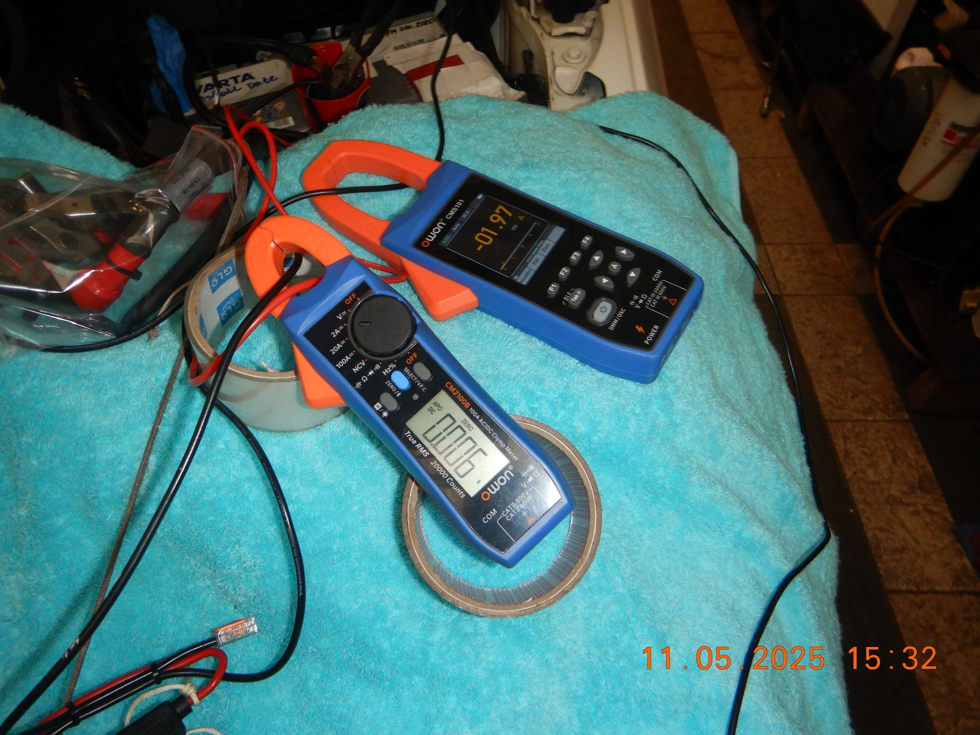

The car built in AMP + VOLT menu only reads what the battery get as charging amps or discharging amps of the battery, it can't read alternator total gross actual output.
You need stand alone currrent clamp, prefer wireless bluetooth which has Apps you can record and it is very low cost now for up to 100 amps AC/DC.
Like below during alternator load test : 93.1 amps is gross output of alternator and battery is also supplying 15.7 amps, thus the car was consuming 108.8 amps during alternator load test using electric steering. among others.
This video is a bettery view....
The best low cost bang for the buck wireless 100 Amp AC/DCcurrent clamp money can buy at the moment.
https://mbworld.org/forums/e-class-w...s-awesome.html
You must clamp the positive alternator output wire before it enters F32 prefuse box. That is the gross/actual alternator output.
F32 fuses/devices are the consumers of alternator power and battery power.
Battery can also be consumer of alternator power when alternator is at higher voltage than 12.8V , depending on how low the battery state of charge at that moment, it can be up to 25 amps for battery alone.
A non heathy battery is easy to see when ALT-LIN is disconnected, even after driving in a highway ( not stop and go ) for 20ish minutes and AMPS into battery is not under 5 to 7 amps, that meant the battery
is not very healthy.
This is at idling and battery is full , thus 0.2 amps only charging into the battery...

If you want bigger one, OWON has a bigger brother 1000A current clamp. I got it too. Also wireless.
Below is me trying to use baby Owon for Leakage Current test and the bigger OWON as regular current clamp.
See how I clamp 2 wires using baby Owon. Feed and return wires, while I "leak" out 6 milliamps.
This is how RCCD breaker works too. You are from Europe, they call such breaker RCCD, in USA its called GFI.
Them OWON are so cheap, it is worth it.
Wireless and logging capable makes troubleshooting much easier.
