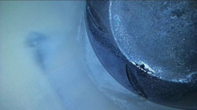

I noticed in the video I posted here too, of the borescope. Even though the piston looks very close to tdc. Does that look to be scoring in the bottom half of the video?

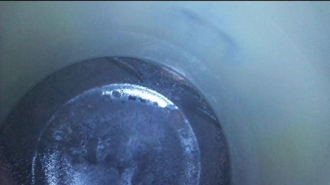

so he did a good borescope on two of the cylinders they seem to look good to me can you let me know what you think please?

These two pictures show honest stock wear... not vertical scraping with low compressions.
wear marks match oil cleaned piston
this translates as moderately increased oil consumption.
These cylinders are a PASS on 2 only.
You need to see every cylinder walls and piston tops numbered, not only the best lookings.
