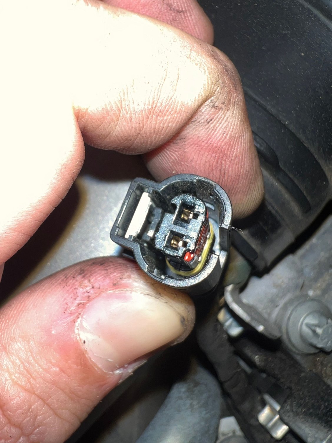

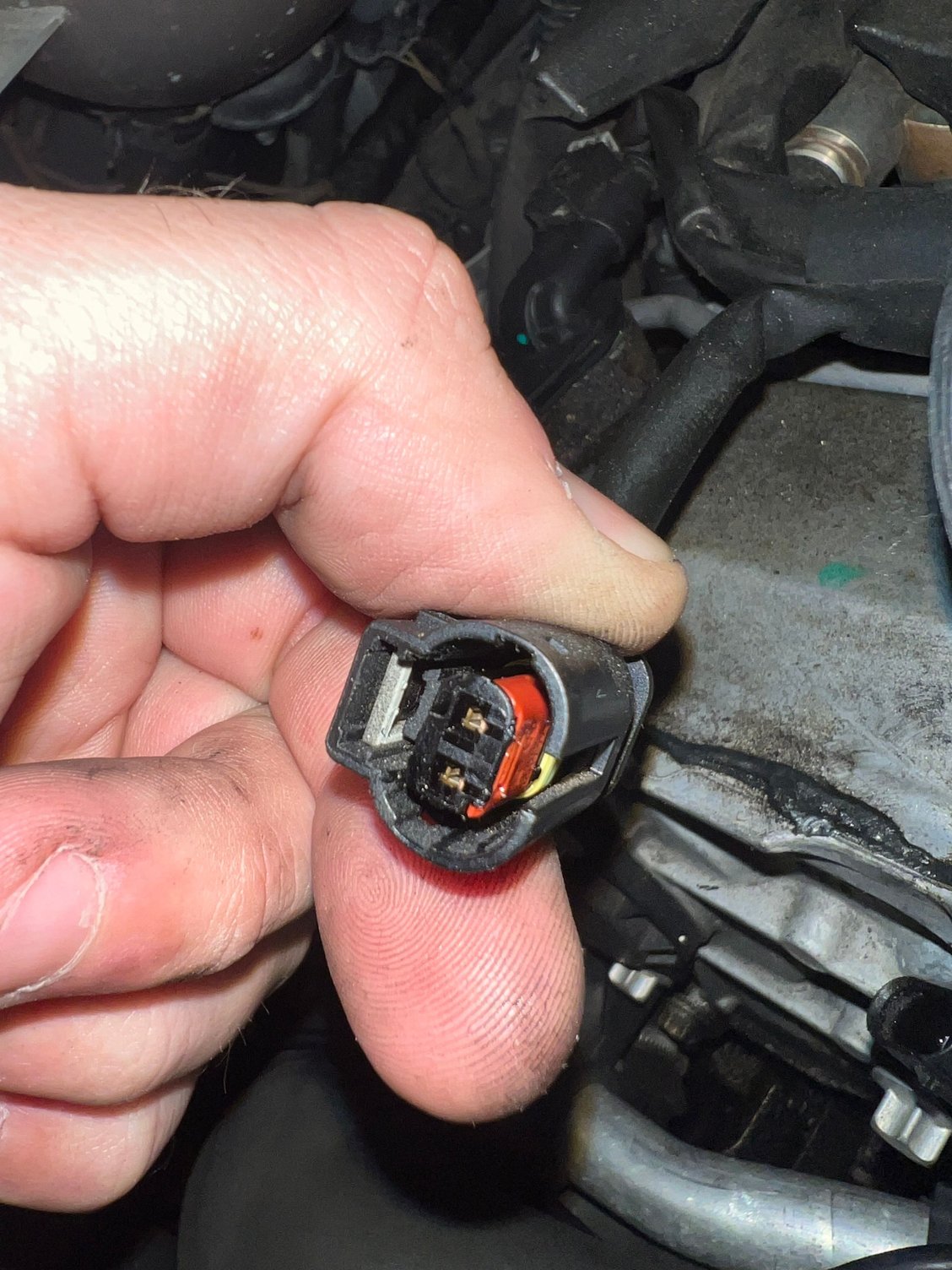

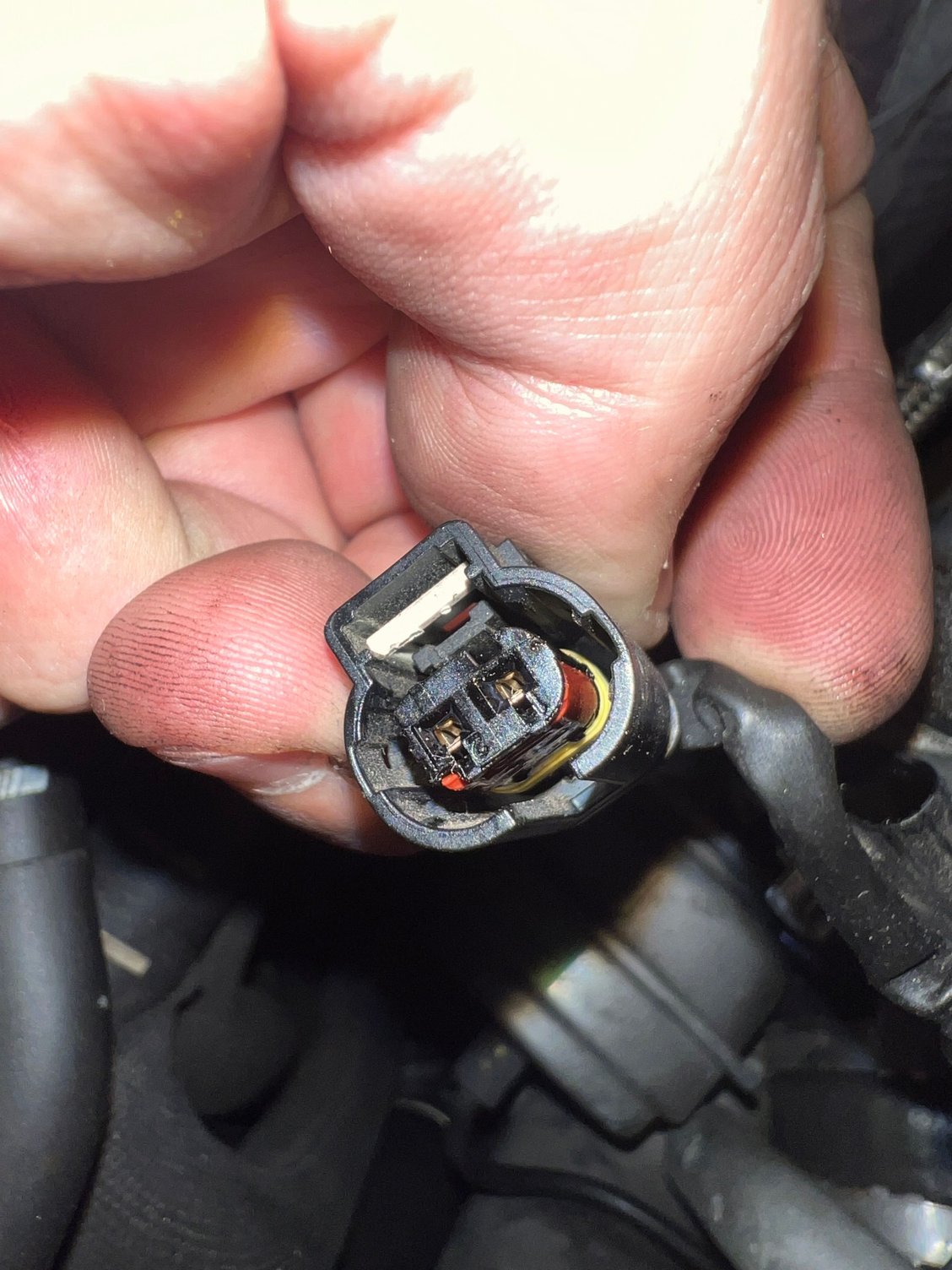

sensors are good
he’s doing a borescope of the cylinders right now, any specific cylinder more prone to scoring?

NOTE... These are not the leaky CPS sensors
these are the VVT "magnets" recognized by 2-wires.
They are dry and don't usually fail.
The hot leaky ones are the Cams Position Sensors on engine top with 3-wires...
There are CPS units to see.
