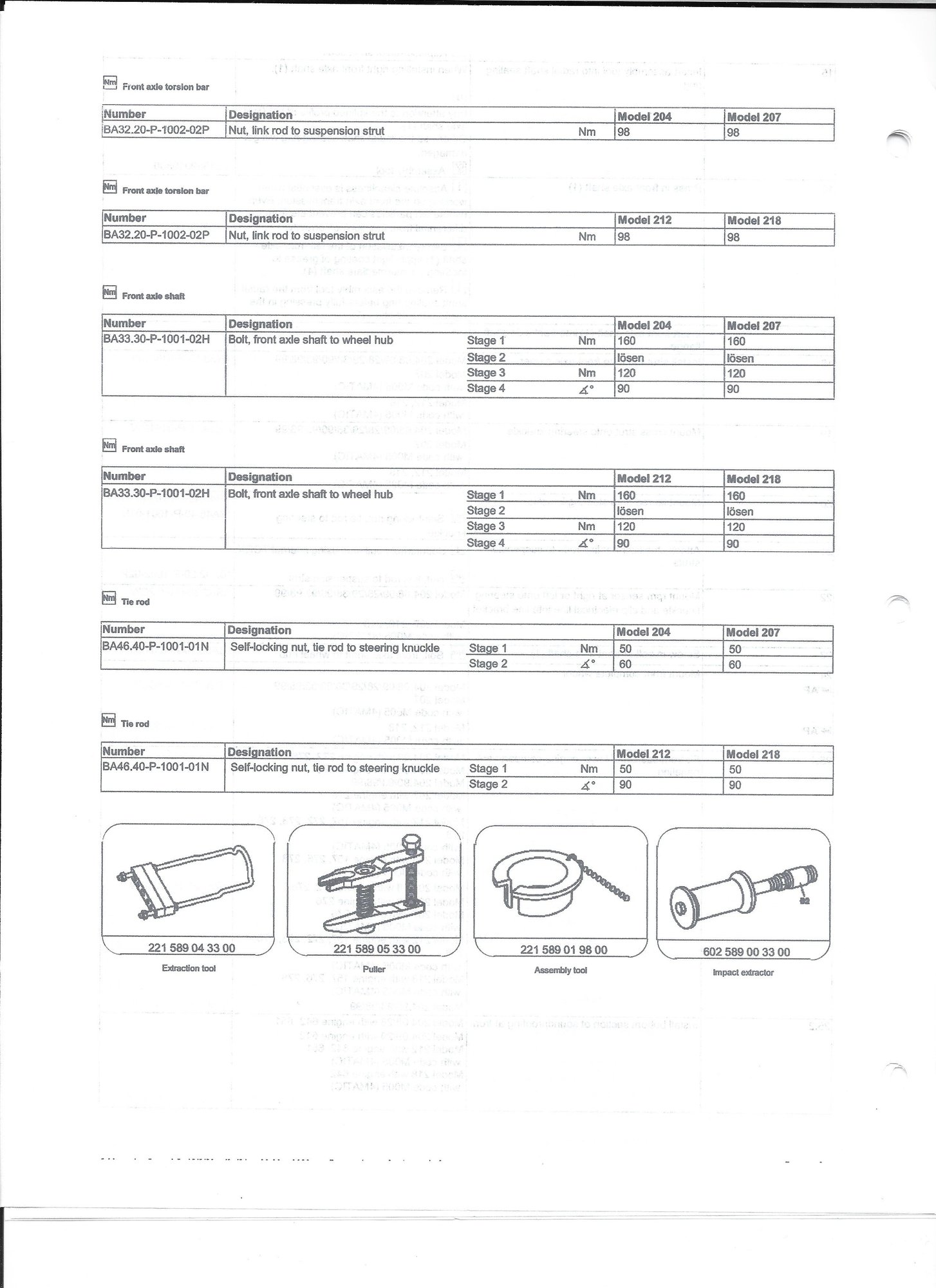

I tried looking at the E350 instructions and for some reason they dont have much. Ive been looking thru the 2010 C300 for my car and they have plenty of instructions. You may have to look around.
I know the specs are similar if not the same with the W204. I'll post what I have copied. Axle bolt, sway bar links and the tie rod.

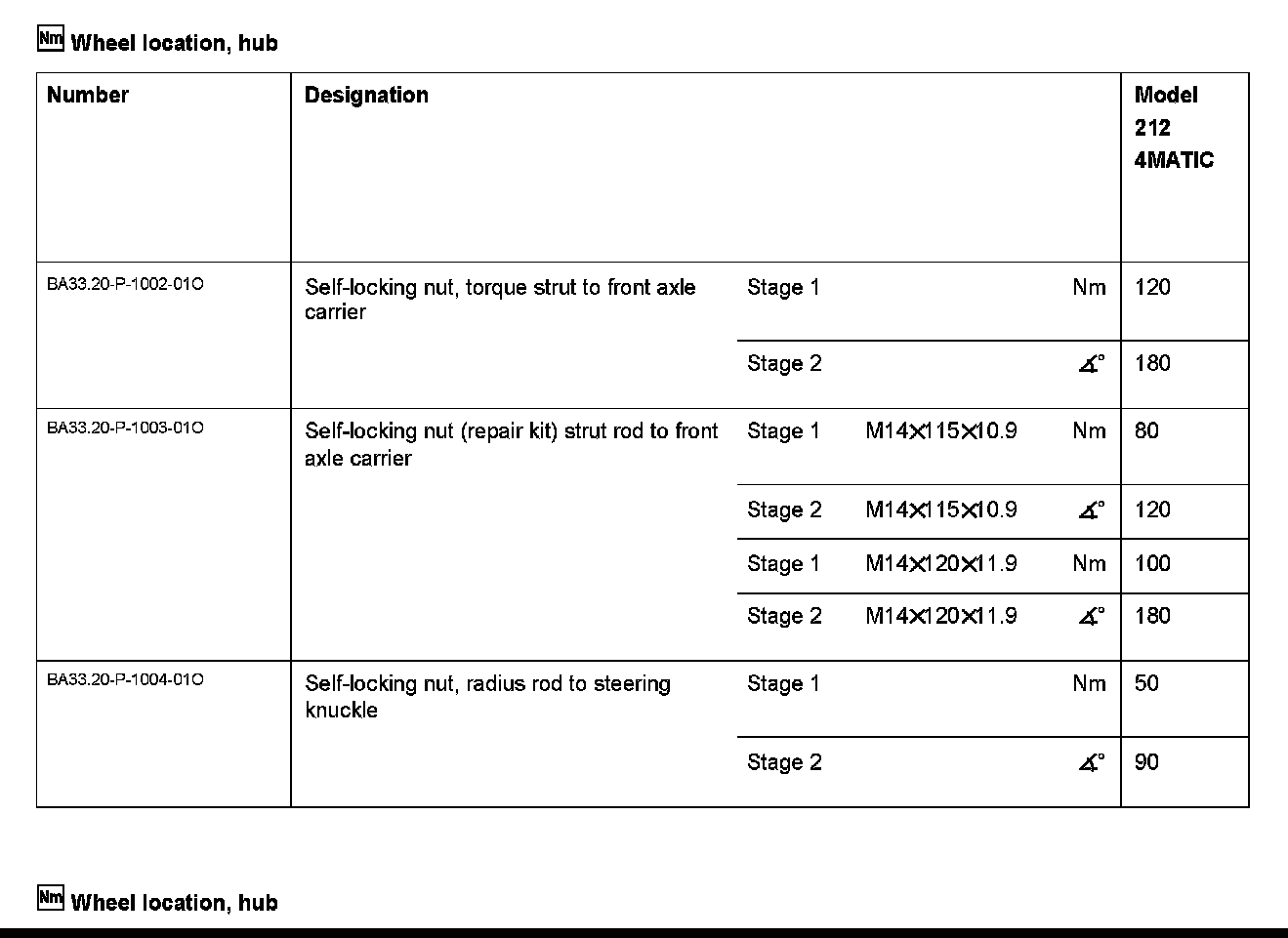

Found the 212 torque strut and cross strut torque specs. Finally found them looking thru the 2010 E550 manual. https://charm.li/Mercedes%20Benz/201...d%20Diagnosis/
I noticed under the steering knuckle instructions it says 50nm + 60 degrees, yet in the other sheet I have it says 50nm + 90 degrees. I would go with the 90 degrees. Here is the AR33.25-P-0400EWX Remove/install steering knuckle: https://charm.li/Mercedes%20Benz/201...0and%20Repair/
