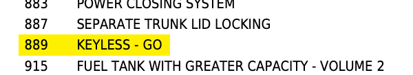

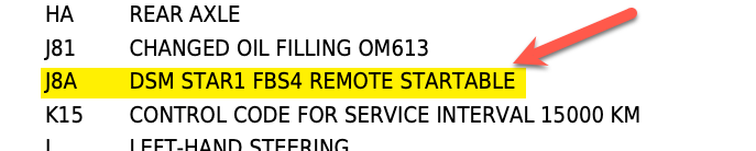

I now wonder if that is the option for Keyless Go or is part of the Keyless Go option.
Old Jan 25, 2025 | 07:47 PM
  #44
ChuangTzu's Avatar
Joined: Mar 2024
Posts: 618
Likes: 241
From: Chicago
19 GLA45, 86 560SL, former: 14 E550 4Matic, 09 E350 4Matic, 83 240D manual, 78 450SLC, 81 500SLC
I have 889 Keyless - Go, but I do not also have j8A Remote startable...
Old Jan 25, 2025 | 08:07 PM
  #45
W205C43PFL's Avatar
Posts: 32,222
Likes: 6,281
Well, there is keyless start standard on many vehicles then keyless go is an option... I still don't think it is related to this "startable" feature though.
