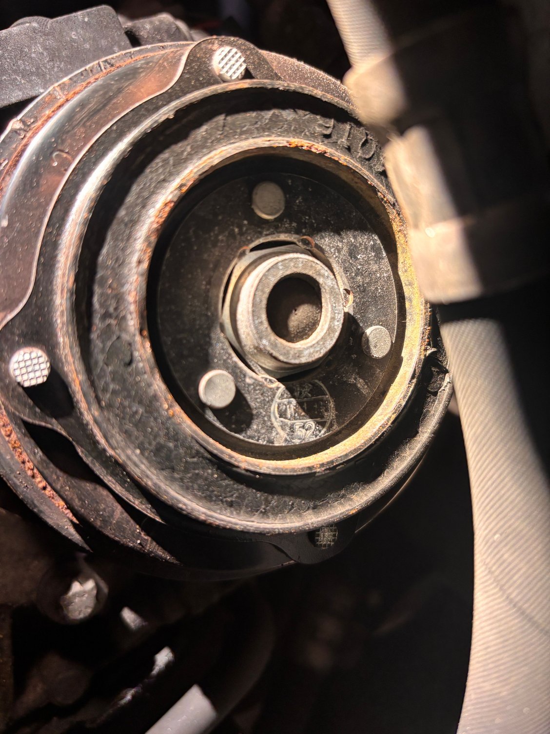

Please post a picture to see what kind of clutch is
Old Jan 28, 2025 | 12:57 PM
arildjr's Avatar
Joined: Jan 2025
Posts: 42
this one 😊

Originally Posted by arildjr
this one 😊
Common DENSO
This video may help
I replaced the magnet on mine in place, w/o dismounting the AC compressor

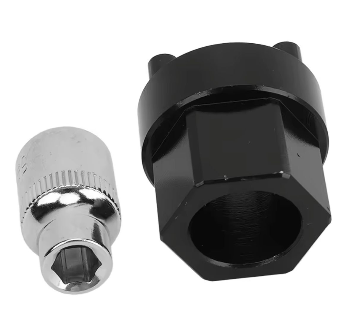

thanks! I have the clutch. Was just not able to loosen the bolt.
ordered this one from ali.
