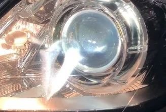

Isn't fixed yet, but while dropping it off, I went through the various maladies, and when we were talking about the headlights, the guy seemed very familiar with the issue. My head light lenses have some hazing on the inside per the below photo:
He said that's a sign that something is running too hot, and the motors are likely burned/burning out. My warranty has a carveout for headlights in some manner, but I don't think that extends to the existence of brights as in this case. Similarly, it excludes shocks, but will cover struts. We'll see how it pans out. Hopefully in my favor, but too soon to tell.

This burn in on the lens happens to all the Xenon lights, it is not indicative of overly high heat, Mercedes makes a kit to clean this off from the back, it is on the inside of the lens, you have a programming issue or your camera behind the rear view mirror has a bad connection or needs to be programmed/re-calibrated.
