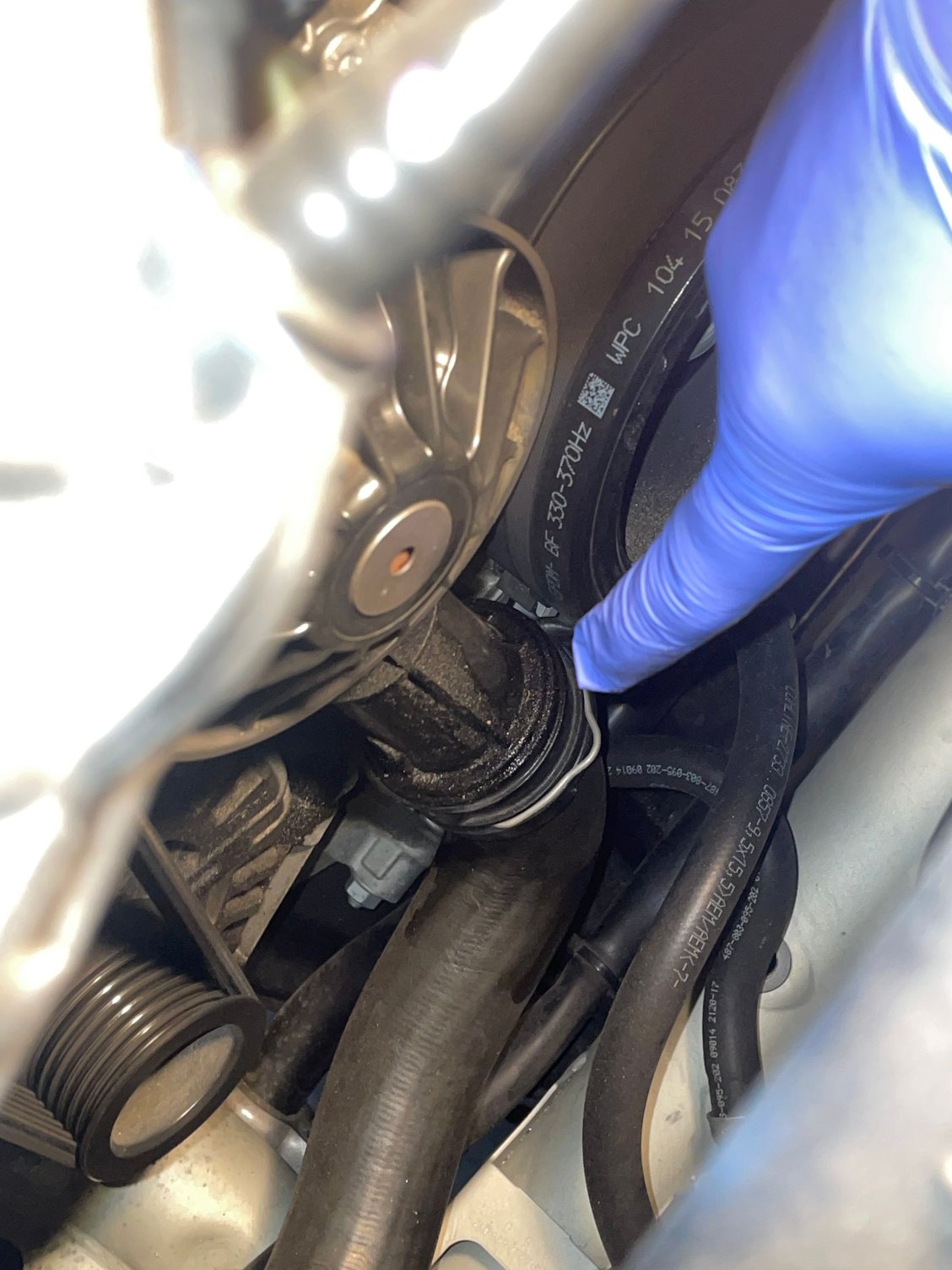

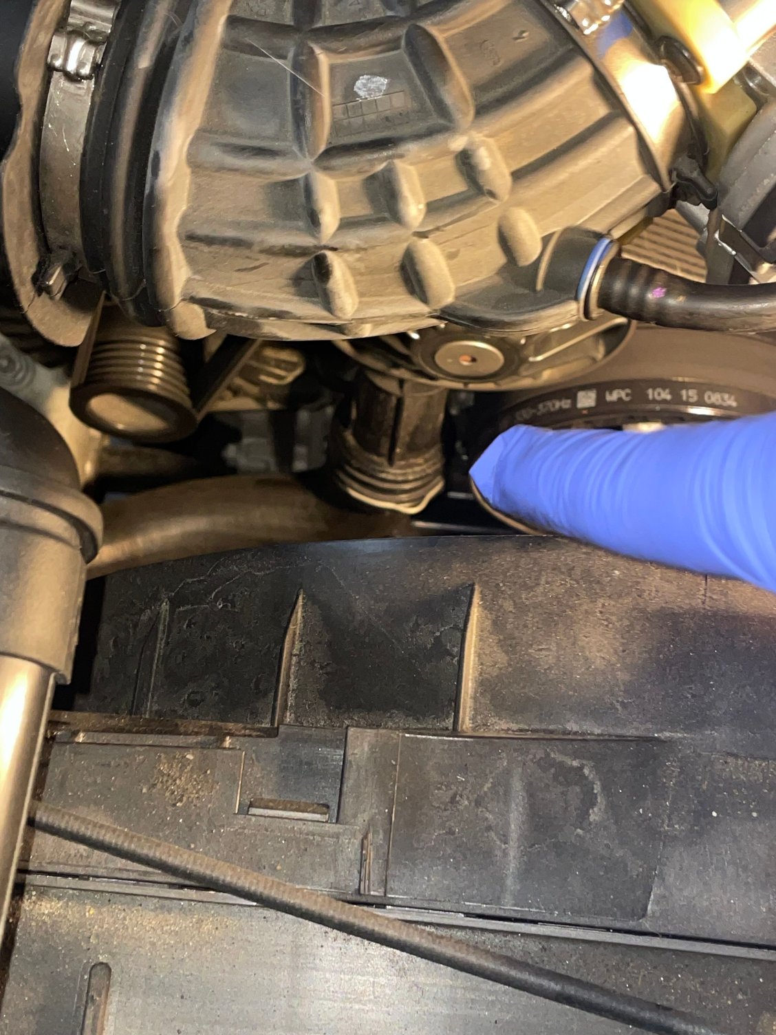

Was performing an oil change for pap’s 2016 e350 and discovered the lower radiator hose. This is a rarely driven car with just under 30k miles on the odometer. It all started 3 weeks ago, before the oil change, the coolant light came on but no obvious signs of leakage on the garage floor either. I took it to a nearby gas station and they noticed the coolant reservoir at the low side. They filled it up completely and this drew my attention about the proper level. Is it suppose to be completely full? I searched on YouTube and saw there’s a plastic ridge inside the reservoir to determine the fill point, but for strange reasons mine didn’t have this. Any ideas? After filling the reservoir, the coolant light disappeared and everything was fine for about 3 weeks until I decided to change the oil and discovered the lower radiator hose like this. Any suggestions?

Hey Jetta, thx for chiming in. The lower hose has got wet spots.

I’m thinking whether it’s the other way around where the lower radiator hose had been slowly leaking, hence setting off the low coolant level warning.
Absolutely possible,

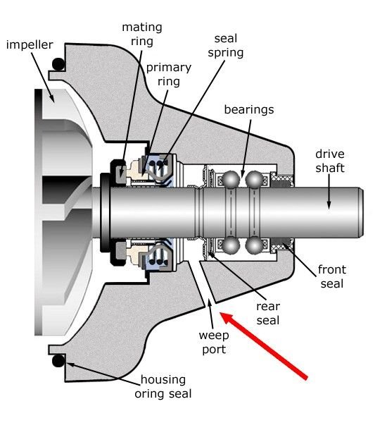

I assume you checked and it is water, not oil.
If it were the hose or it's O-ring then I can't imagine water traveling up like that, so imo it's coming from above that point. Since it's on the front side I'd say it looks like a classic water pump fail.
The standard weep hole placement is behind the pulley just below the shaft, between the seal and bearing:

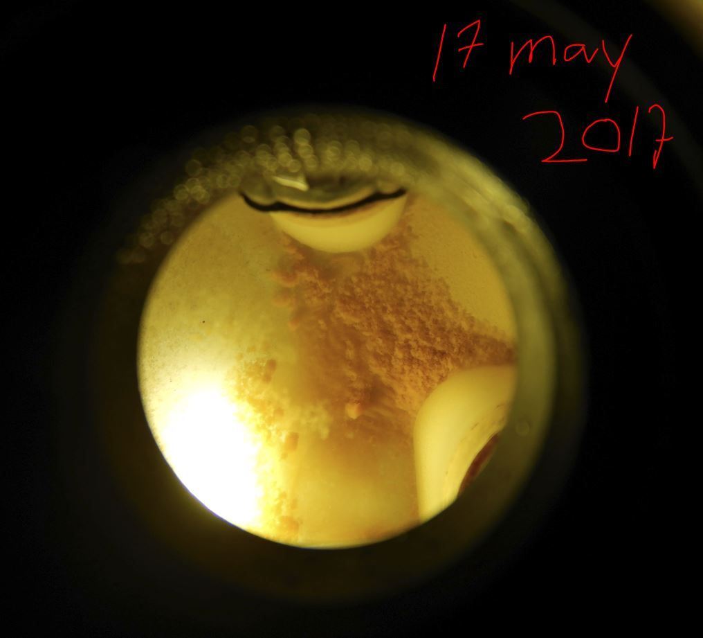

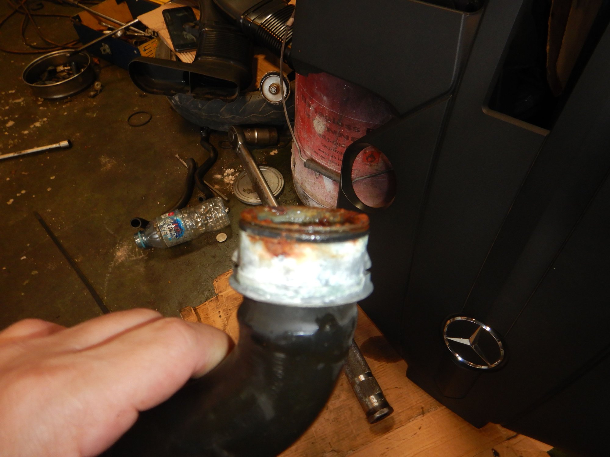

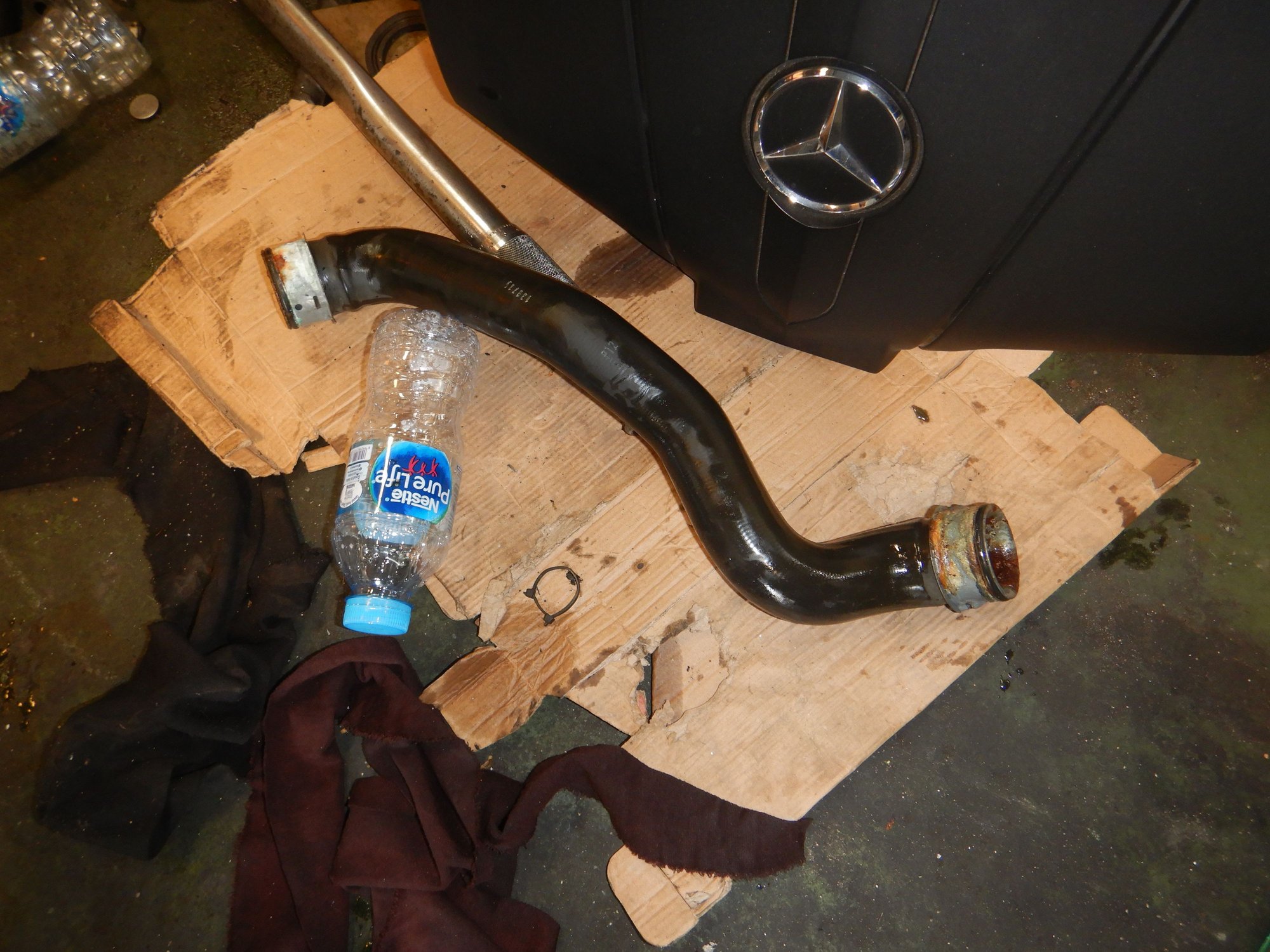

I had a misfortune caused by MB Indonesia poor water quality used on the coolant mix, also the coolant mix I think is not 50%, but less.
It was still the oldie yellow coolant and not blue coolant, albeit car was made available in June 2014 to 1st owner and its mine by May 2018.

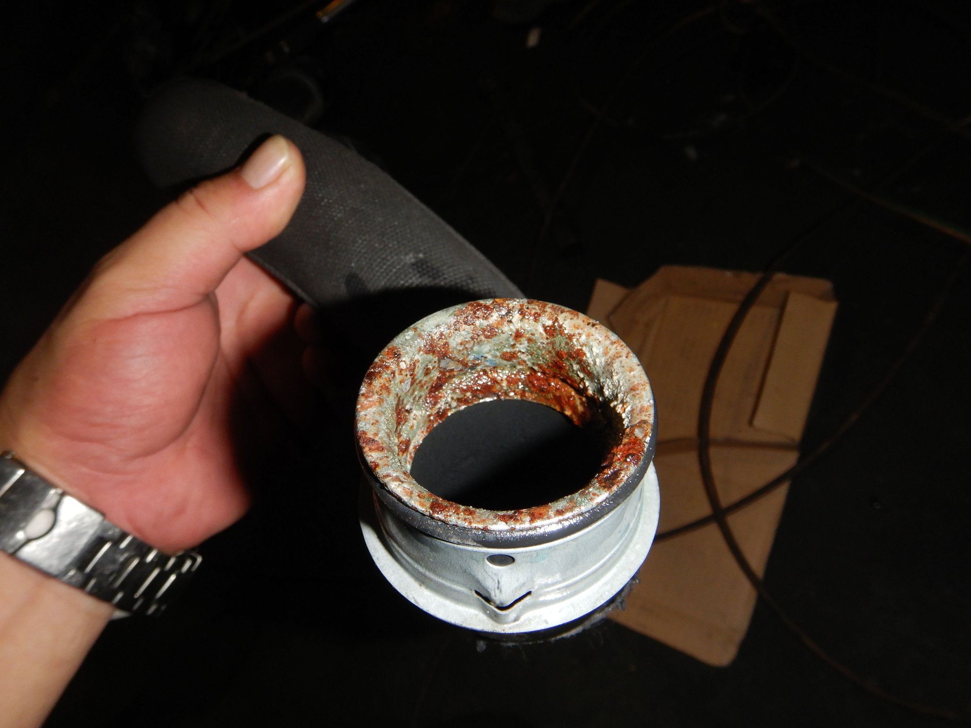

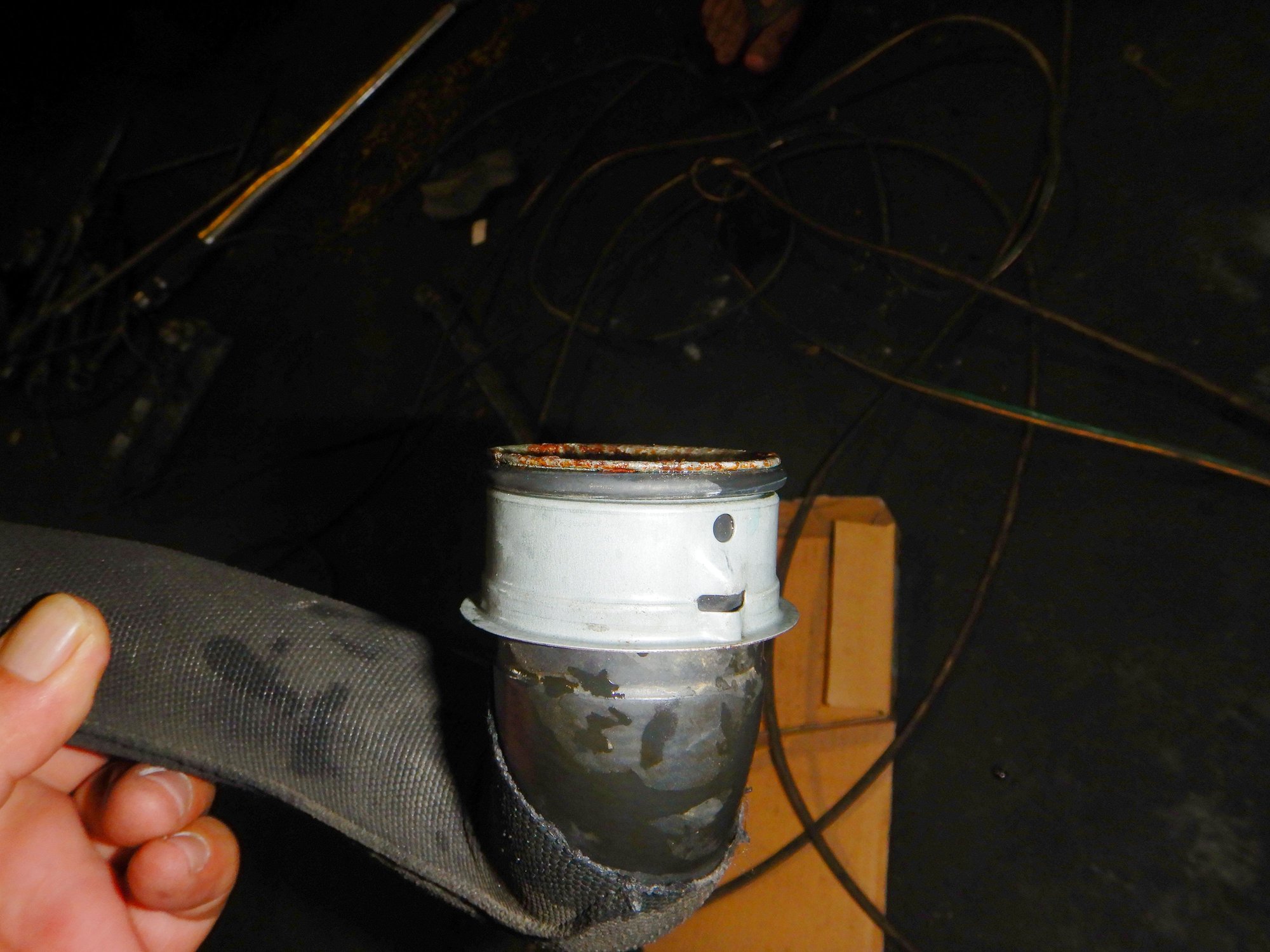

The leak could be from the steel end of the hose getting rusty and thus the o-ring won't sit well.

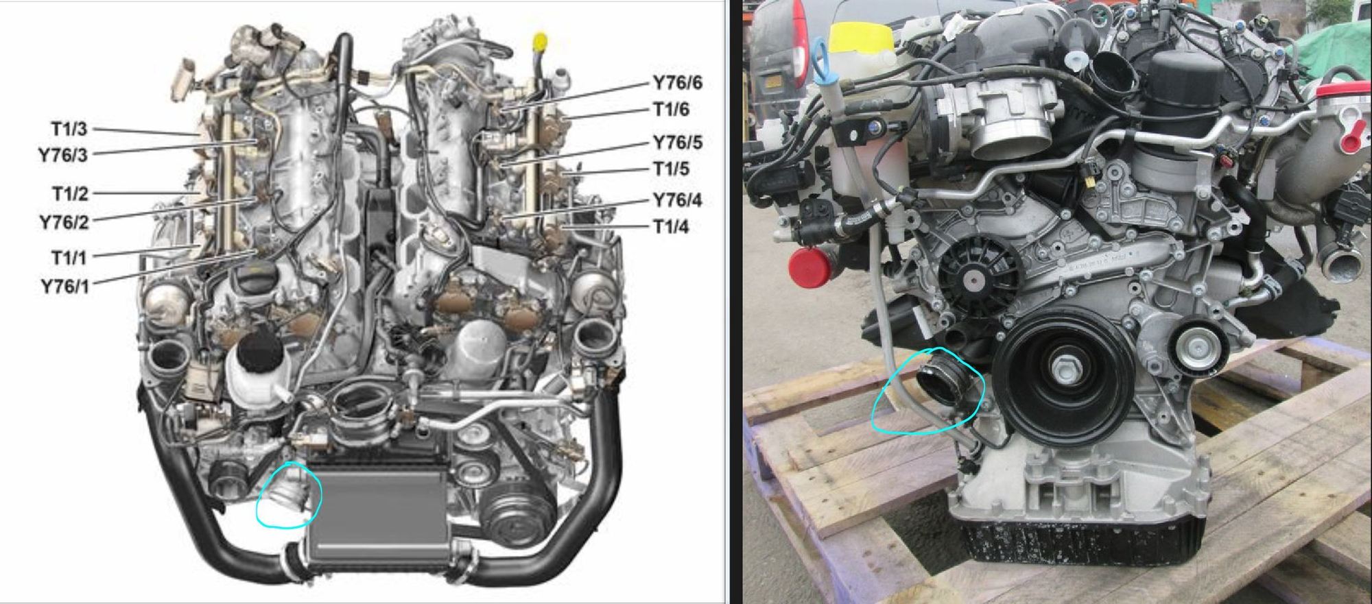

The main coolant reservoir

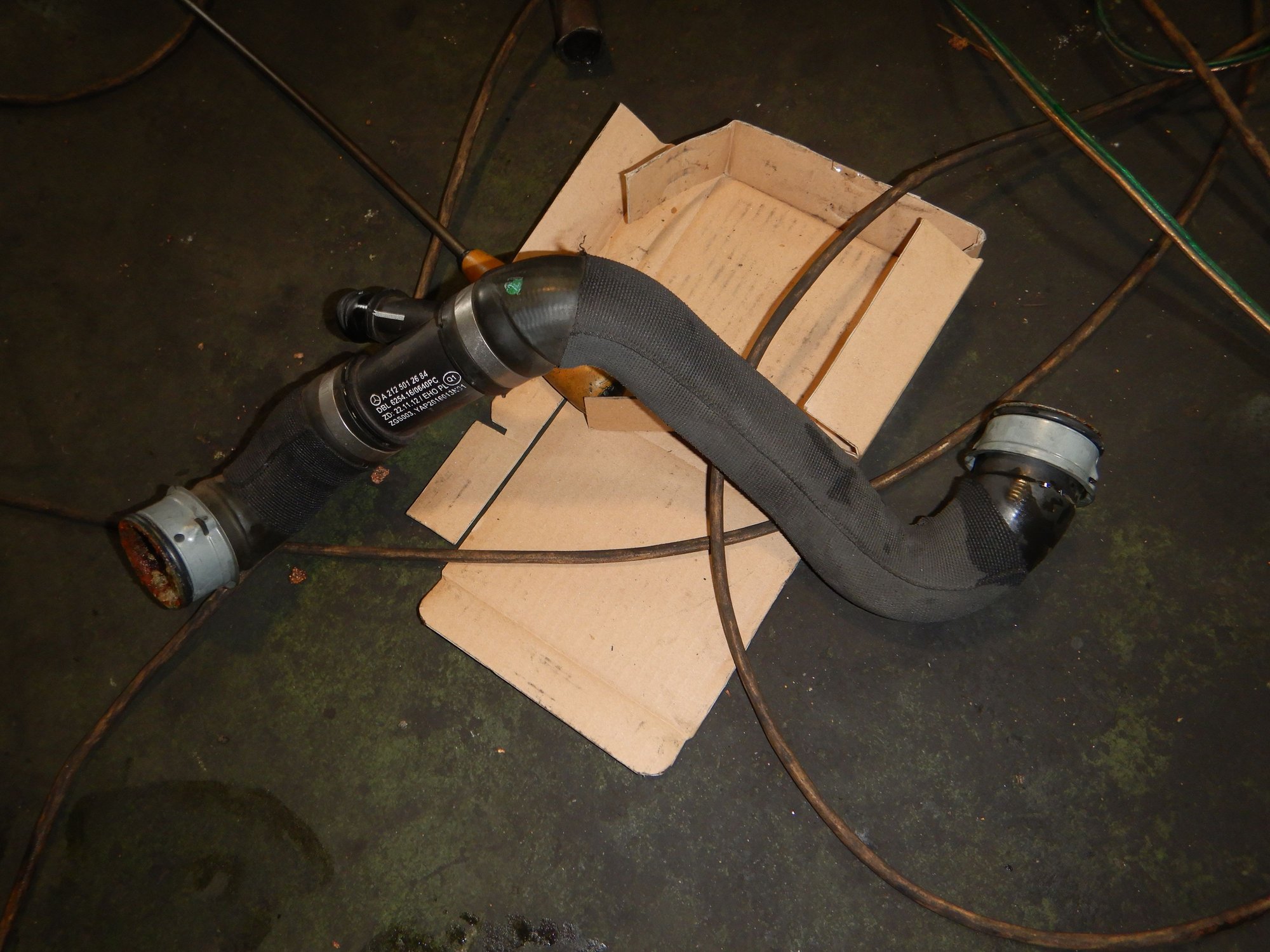

This is my equivalent coolant hose to yours, from radiator output to water pump input
Even my water pump has minor leak from the seal.
Replaced it with new one.
A few hoses got rusty steel ends...duggghhh !!!!

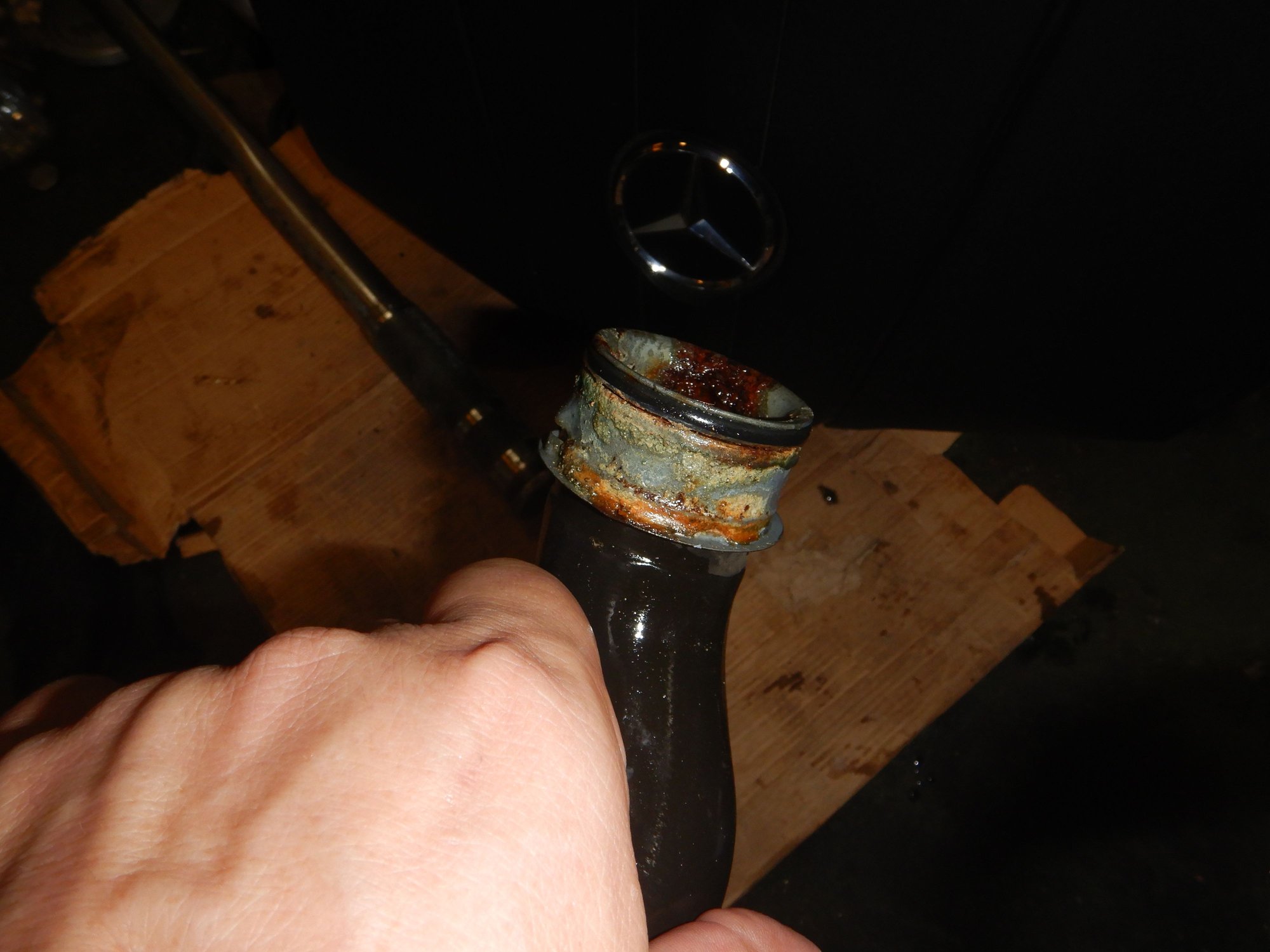

The worst one would be the hot hose, the one from engine output ( thermostat) to radiator input. 100C+ temperature chemically made the high TDS water used by MB Indonesia started to
carbonate / calcium up the steel end, aside from making it rusty.

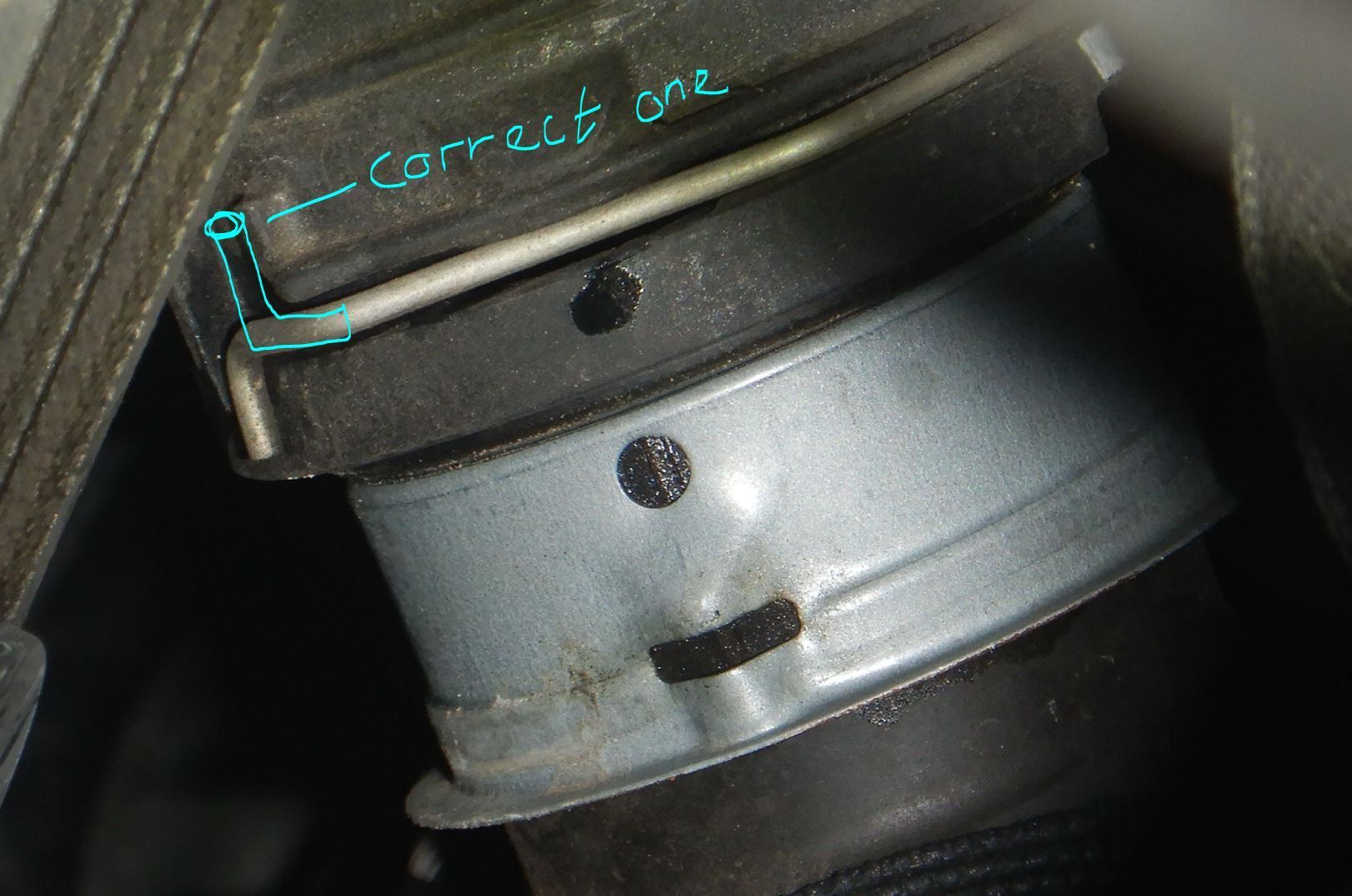

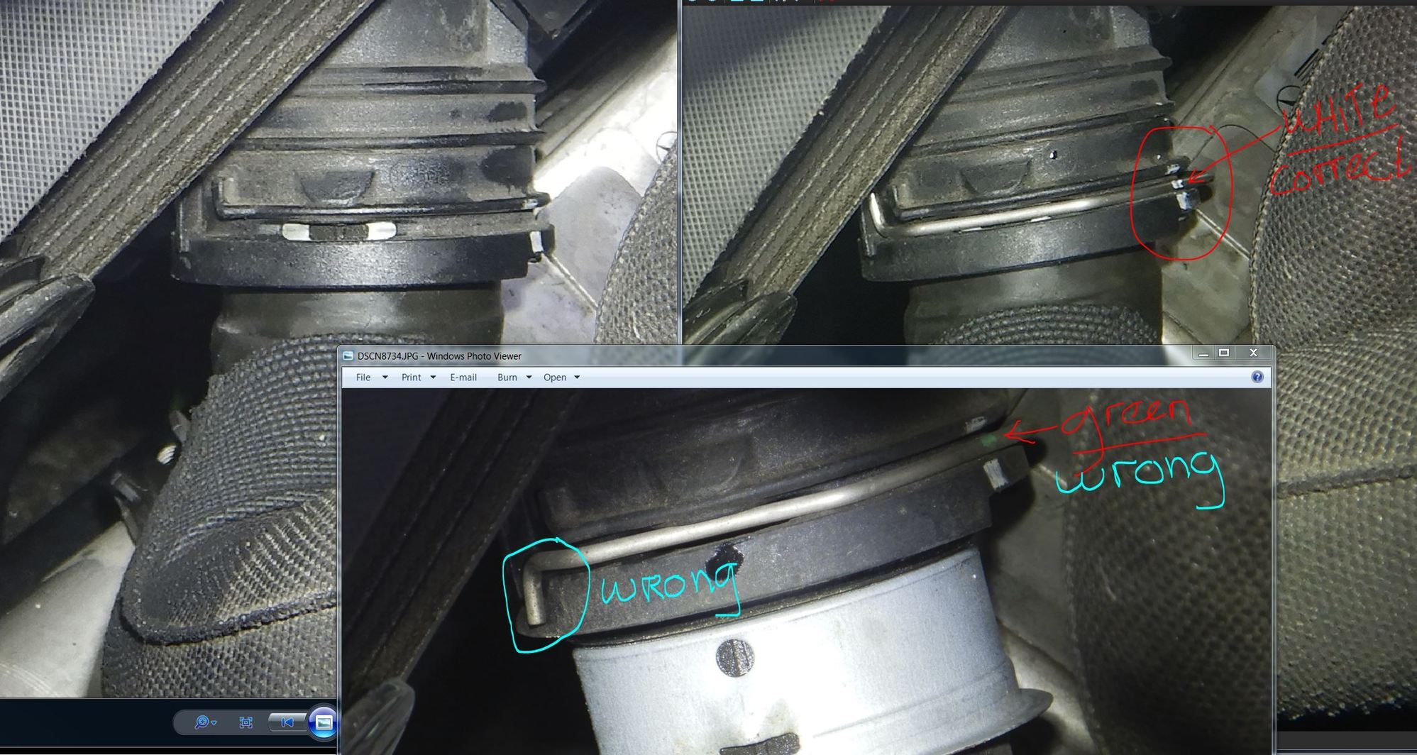

One word of caution. Do not remove the C clip ( catch spring ) , you only need to pull it up 1.5cm up when you need to remove the hose from water pump inlet.
Do not install the L end of the clip the wrong way, if ever by accident you completely remove the C clip.
To install the hose, the C clip (catch spring ) is to be in normal maximum-IN position, it will auto lock itself.
This is what I sent to my Indie techy, so it has Indonesian instruction

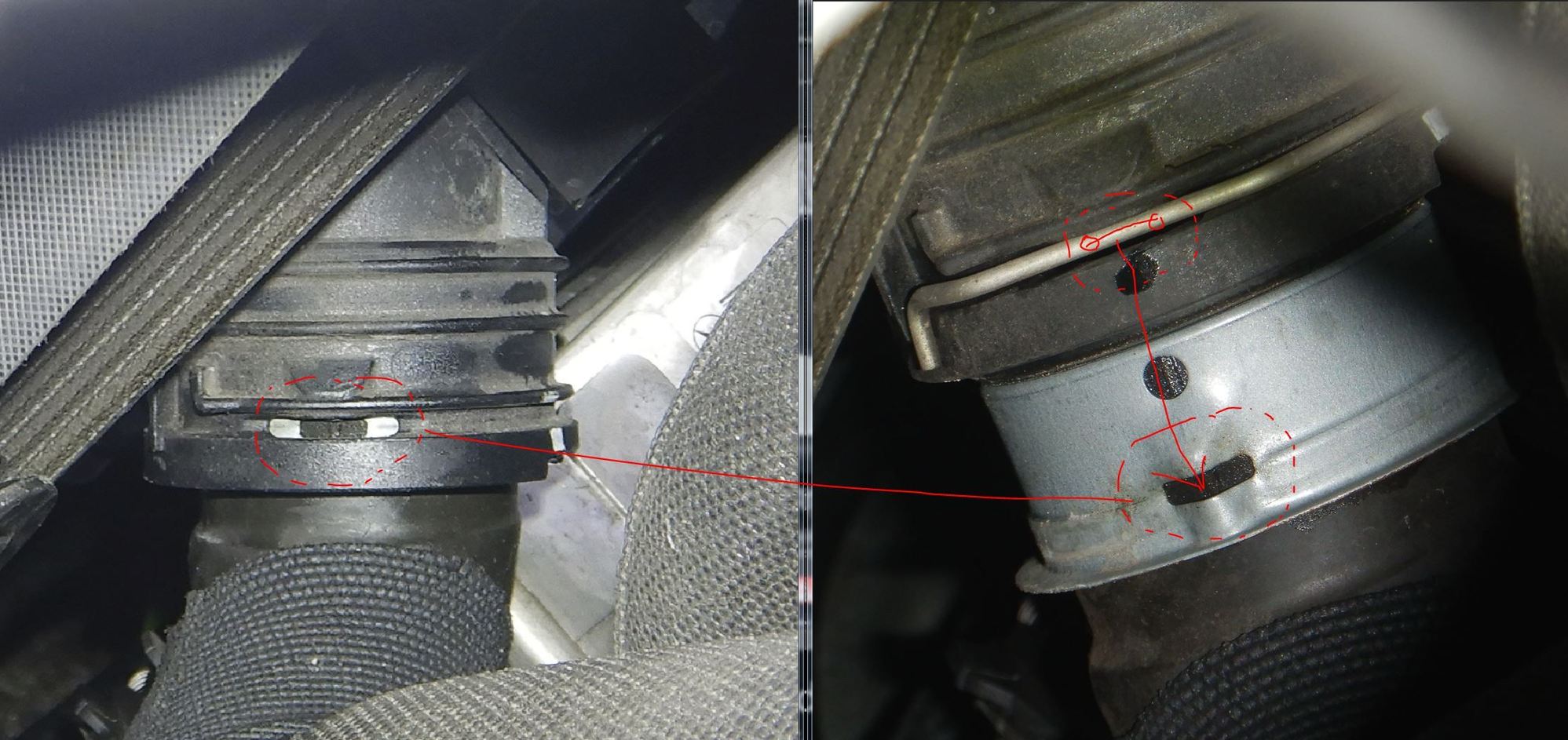

The #3 "soft hill" is the auto lock mechanism when inserting hose into water pump, no need to pull up the C spring ( catch spring ).
To confirm the soft-hill is locked well. below :
The C clip ( catch spring ) will lock into that "soft-hill"

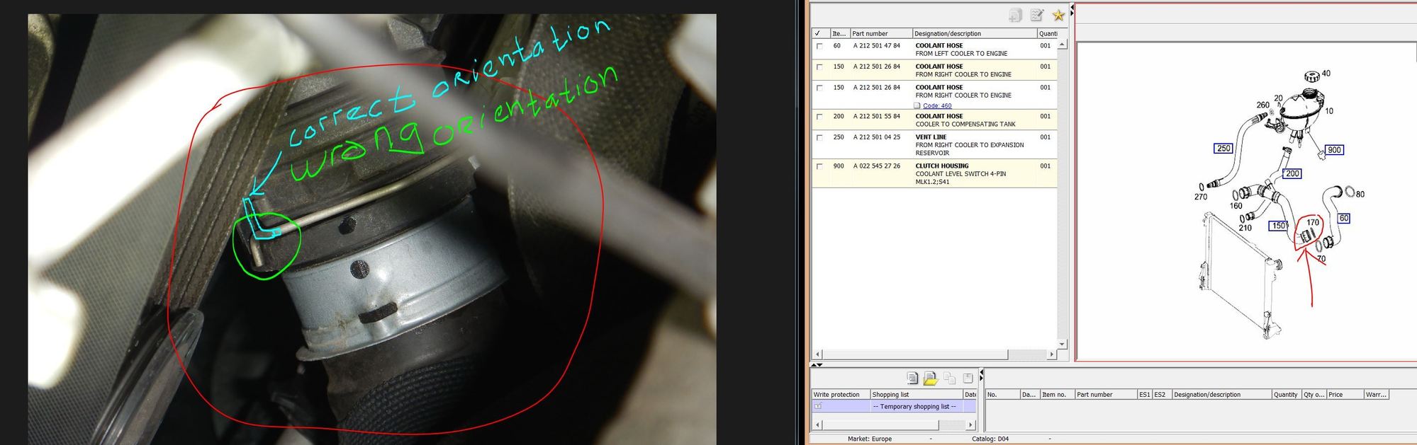

My indie tech made a mistake, he removed the C clip ( catch spring ) totally, when he re-installed he got it wrong. The L end should be oriented up ( in green cyan ) where there is a catch-protrusion to keep it locked well
MB Indonesia actually made a mark in white, on the C clip and the water pump inlet
If M276.820 3.0 Turbo
On 3.0 Turbo it is more complex to remove the water pump input hose due to aftercooler in the way.
Its more of a by feel work, not by sight. So boroscope camera does help to see details.

Sorry about your misfortunes. About the rust and o-ring, I think so too. For peace of mind, I will replace the lower and upper hose, and change out the coolant while I’m at it. I appreciate you for taking the time to explain and post photos. Thank you my brotha.
