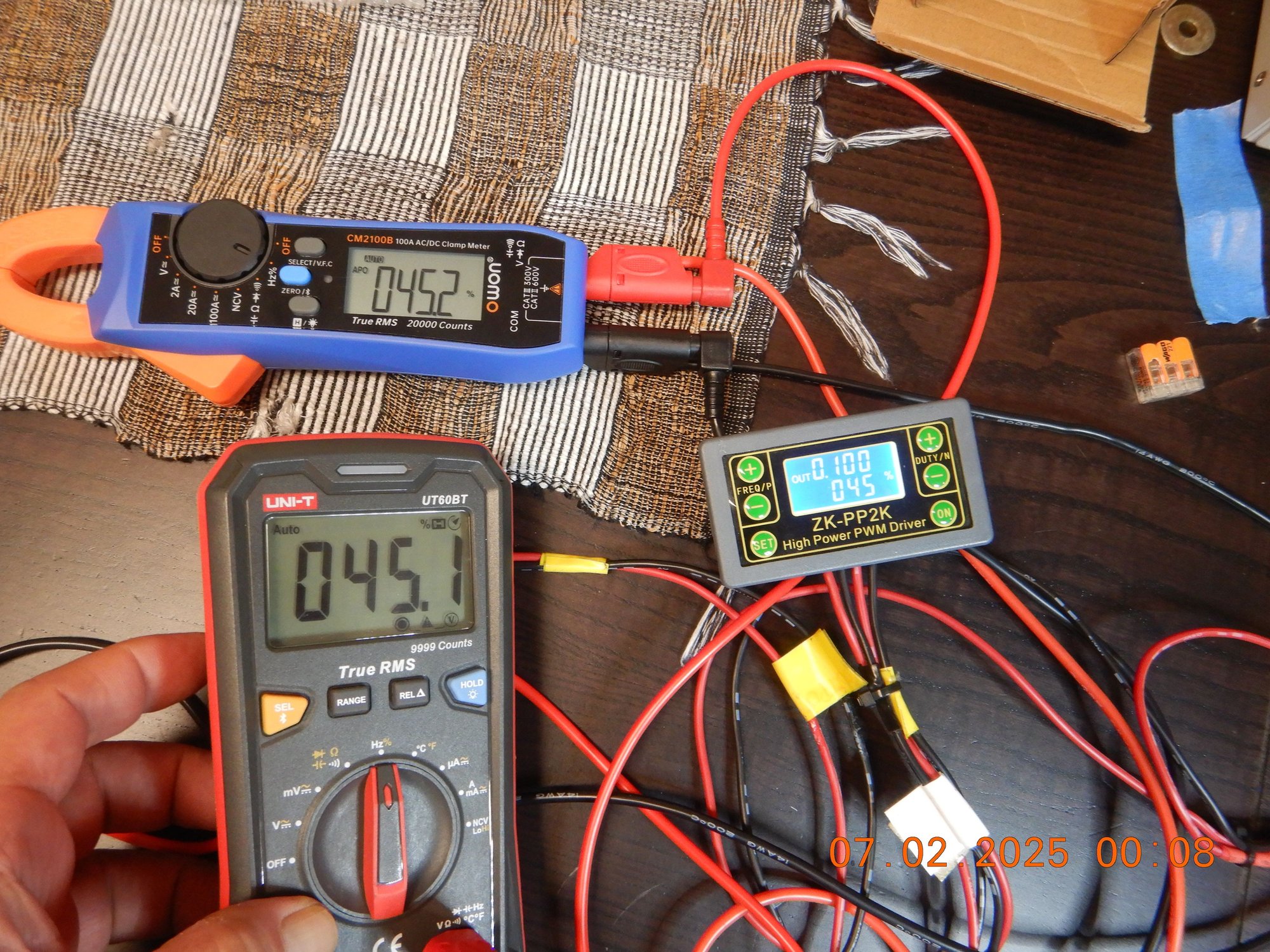

Frequency and Duty Cyle test. Since the video review did not include such test, here is mine :
Note, my cheapo PMW signal generator is decent but i do not believe it is accurate to 1hz frequency...LOL
45% duty cycle at 100hz. Reading is duty cycle %
Reading is Frequency, HZ.
I am too lazy to compare it with my Fluke 289, this is good enough. Supposedly 100hz and read at 98.xx HZ.

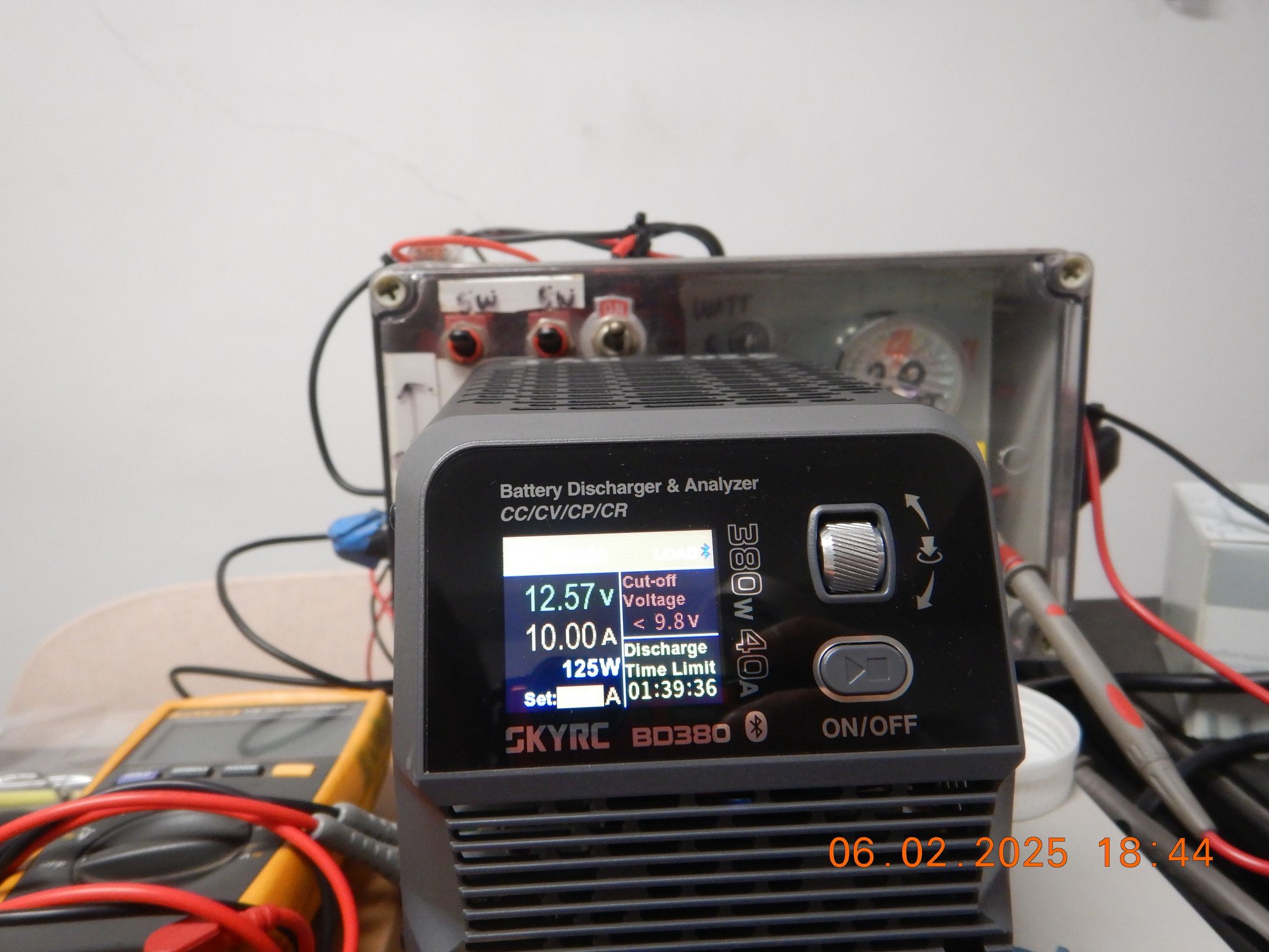

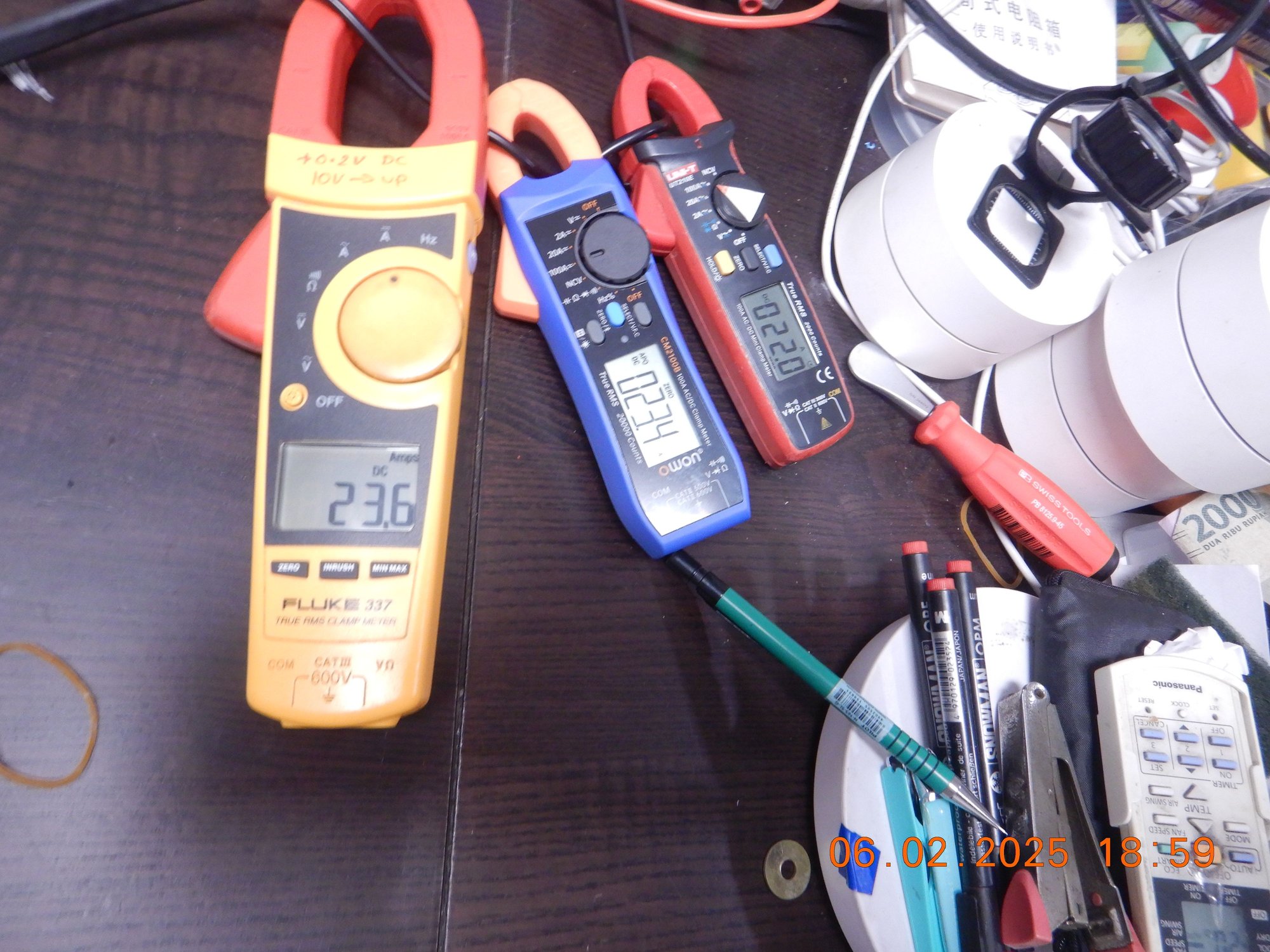

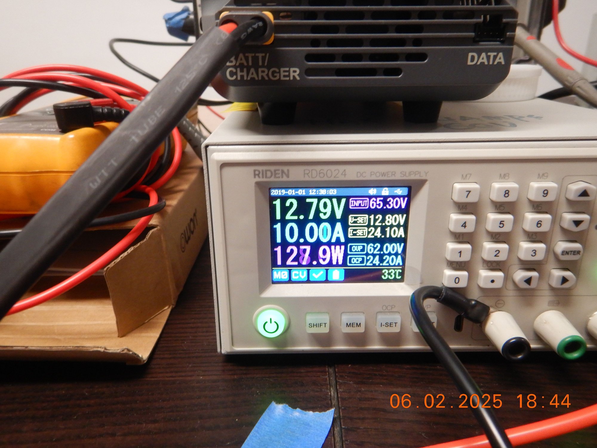

High amperage test at 100A range setting, DC amps. My power supply can only do max 24 AMPS.
Setting at 23.8A load. Owon CM2100B read out at 23.4 amps. Fluke 337 at 23.6A and the drifted UNI-T is showing 22.0A.

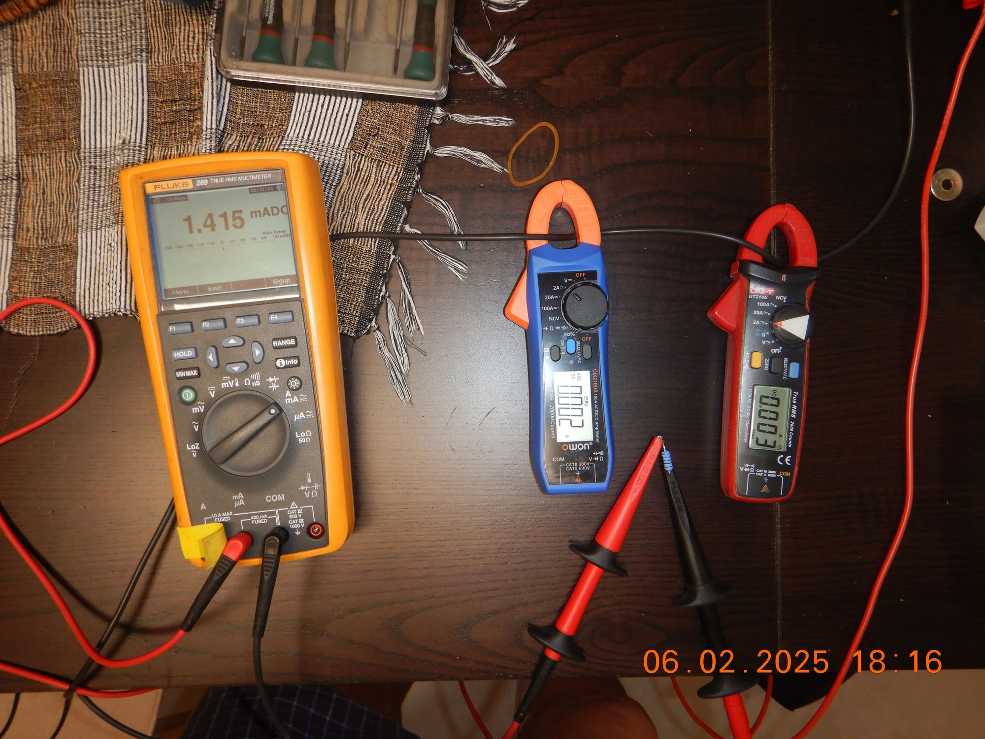

Can I get good low current accuracy, yes, it is easy on a wooden table with no magnetic metal.
On my car at negative battery cable to suspension strut, I get approx 10 -15mA disturbance ( guesstimate based on typical 5mA my car sleeping current consumption ) from the engine bay magnetic field. Still very impressive.
There is a technique to read this good near ferrous metal. I will post it in a few days time.

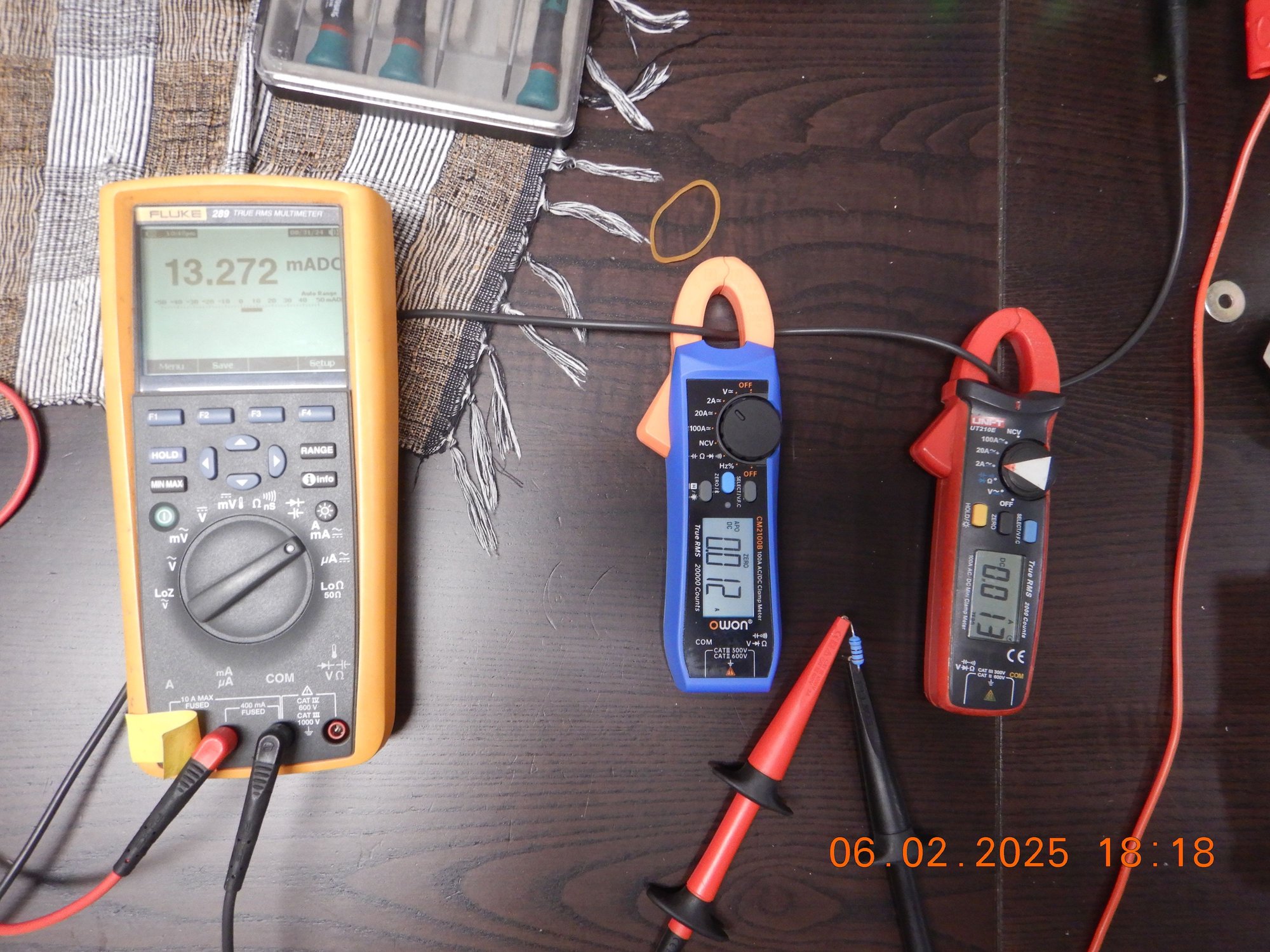

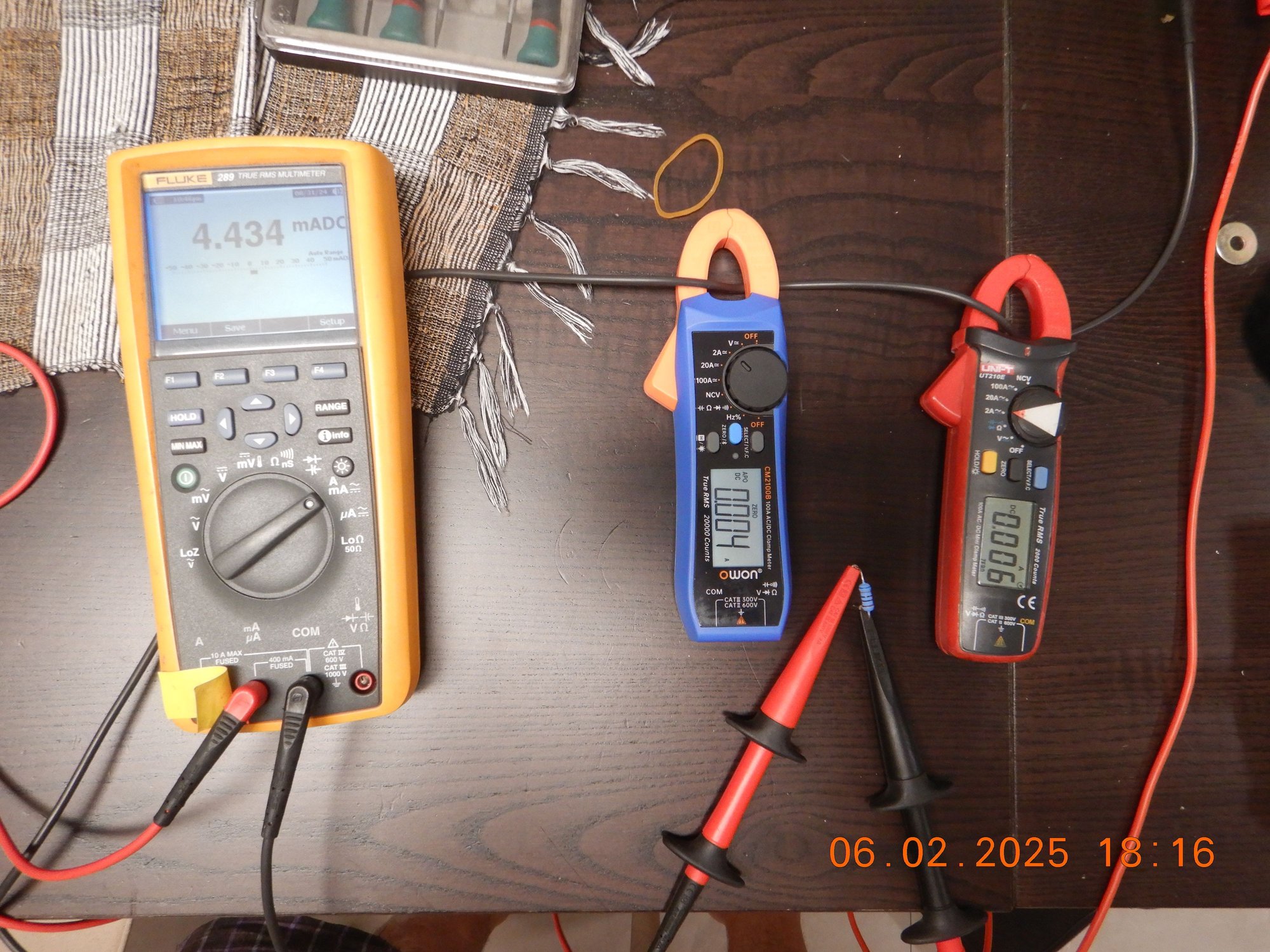

1.41mA Fluke 289. Owon 2mA
4.43mA Fluke. Owon 4mA
13.27mA Fluke, Owon 12mA
20.63mA Fluke. Owon 19mA
All above using 2A setting.

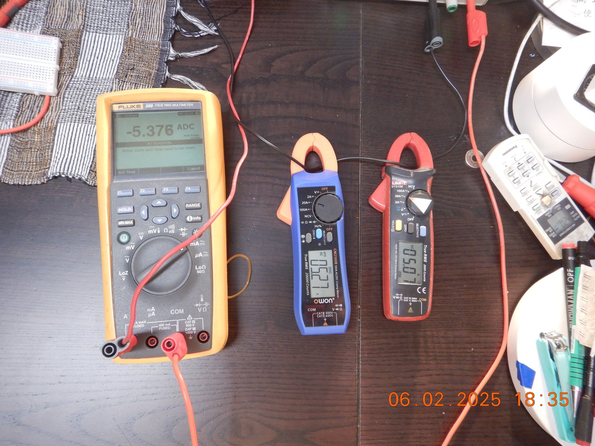

Now 20A setting.
5.376A Fluke, Owon 5.27A. Drifted UNI-T 5.07A

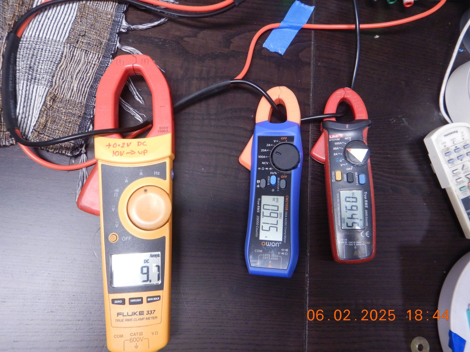

10 amps load
Readings :
Fluke 337 at 9.7A, Owon 9.75A and Drifted UNI-T at 9.45A
