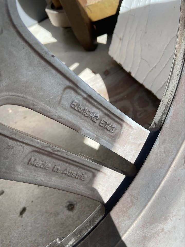

Very much new to MB and car. I have been looking for a new set of mb (preferably amg wheel for my 2014 s212 sport. I came across this listing of a squared set up of 19xET43 wheel with 245/40/r19 tire used for 1.1k, off of a w213 2019 model. The tire were manufactured in 2018.
Is this gonna fit my stock suspension? I have the sport model and my oem sizes are 245/45/r17.
Thank you!!!

It "should" fit. Those 19 inch tires will be a full inch taller than your stock 17 inch ones and will impact the accuracy of your speedometer. Heres a handy calculator.

the rear one most probably will fit, the front one risk rubbing with the bottom of spring mount. The correct tire for 19" is 245/35/19 or 255/35/19.
Btw, let me know if 245/40/19 fit, been thinking to increase the sidewall thickness for comfort....

No, 245/40-19 will NOT fit the front. Front WILL very likely rub. Frequently. My front rim is 8.5 with an ET30. Confirm that your model and mine have the same wheel well and setup. I have standard coils all around on my 4matic.
