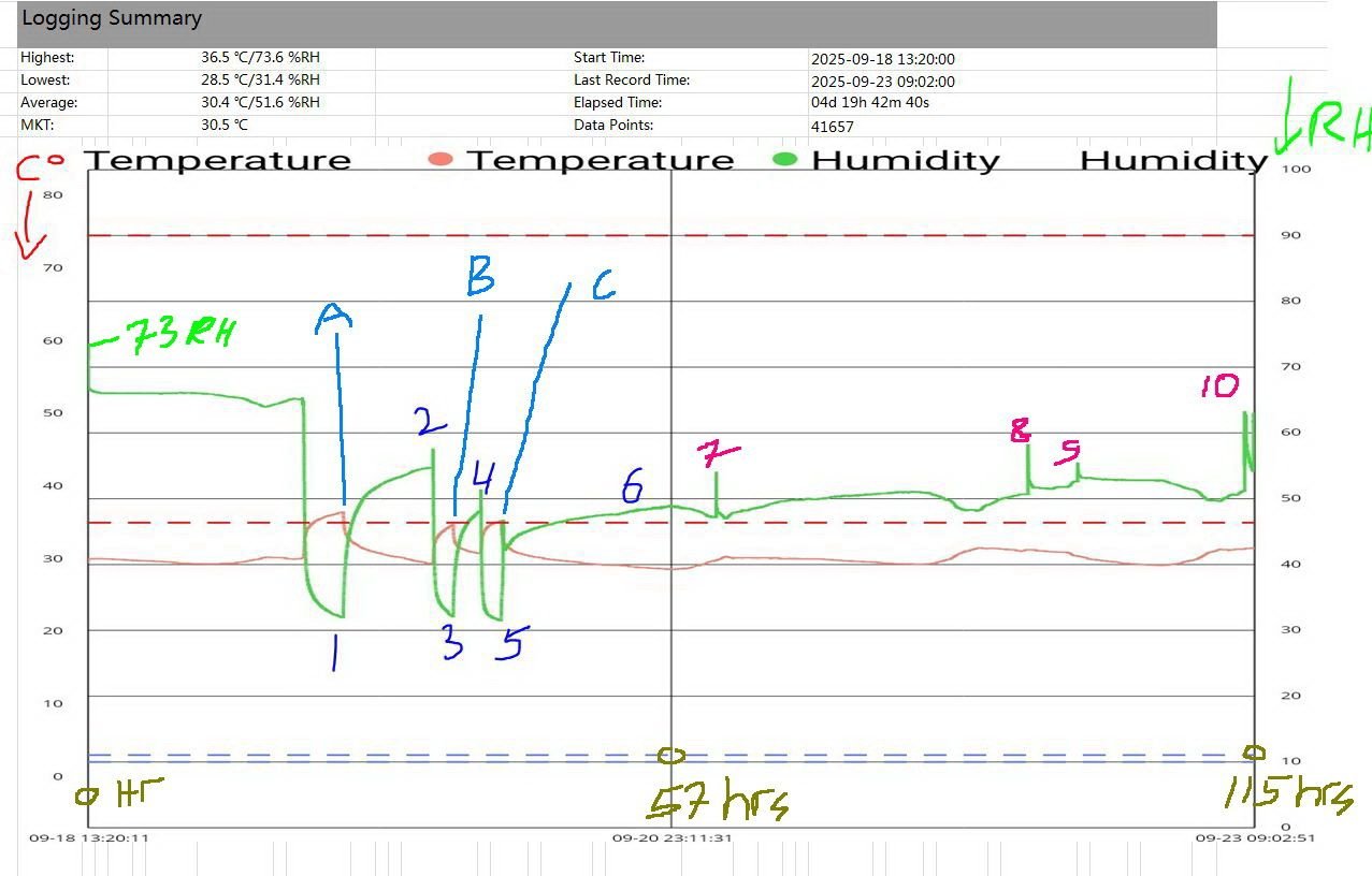

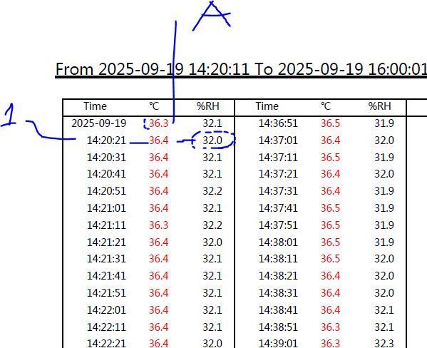

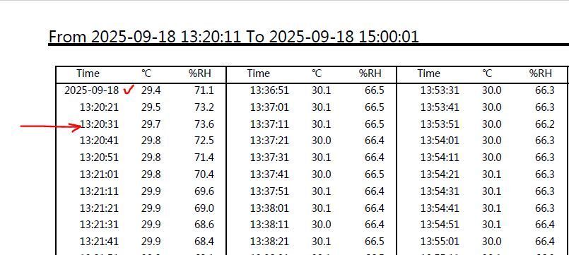

Sharing......
I got Temp and Humidty logger, for data logging sake.
From left 0, or zero hour to #1, that is the logger placed in the car before I use dehumi unit.
#1 and A is dehumi unit in action for 8 hours.
#2 is the humidity stabilizing or reaching its equiblirium inside the car. All fabrics dan carpet do hold moisture, can't escape that fact.
I kept dehumi in the car for some hours, never drain the collected water.
I open the door and get spike up at #2 tip and run again the demuhi for 2 hours till #3 where best RH is 32%. Can't do better. It is the dehumi unit limit.
A , B and C is the car interior getting warmed up by dehumi hot exhaust air cooling its condenser. A being highest because of 8 hours run.
#4 to #5 is another dehiumi run of 2 hours and I removed the dehumi unit and collected 400cc of pure distilled water.
Highest record I can collect water is 450cc.
Lowest I ever collected if 8 hours run and car was dehudified say 3 days ago, its about 250cc.
#6 is the car interior RH slowly rising, #7 is me opening the door and close it again, the same as #8 and #9.
#10 is me keeping door open for long time and finally removing the temp & RH logger, to download its data.
The logging is 1 data point per 10 seconds.
This confirmed the previous measurement by eye balling the humidity and temp small sensor I placed inside the car.
One time dehumifying the car for 4 hours and immediately removing the unit ( because it has water collection bowl ), should be able to keep the car RH under 60% for 4 days if doors never opened.
This new logger supposedly is well calibrated. Its reading on RH is between my smaller and bigger sensors. It can hold max 100,000 data points or good to 10 days approx at
10 second per 1 data point.
END

S. Prihadi,
You have a dashed line on your graph.
It appears to represent a mid 30’s scalar.
Is that an optimum measure for heat and humidity?
If not, what is the static heat and humidity that would be ideal?

No.
Those lines seems to be how the apps designer wanted
The apps is very clunkly.
