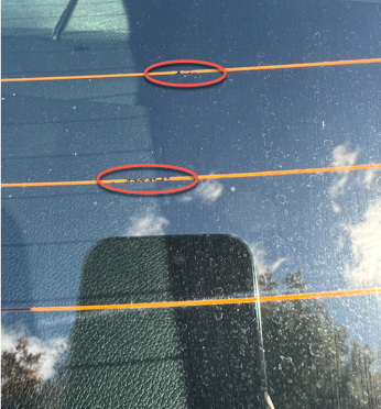

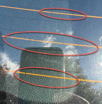

Check the actual elements. Over time, corrosion is your enemy.

Originally Posted by S-Prihadi
Is that your car Jet, which one ?
The SL400. I thought it unusually that the heating elements would corrode so quickly, but the rear window appears to be original. I did buy the car used. When I checked with the dealership at the time, they told me that there really wasn't aftermarket glass for the SL. The dealer doesn't do glass directly, but outsources the work to Safelite, etc., and the glass companies order Genuine parts from Mercedes.

Just one of thos unlucky event I guess Jet.
I wonder if high interior humidity can effect or speed up corossion on those fine heater lines ?

The car did spend a lot of time in southeastern US before I bought it.
Miami Florida area.....as humid as my city, but mine humid all year round
